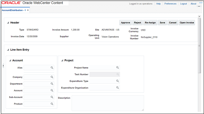

A.2.6 Account Distribution Coding Form (Oracle E-Business Suite Only)
The AXF Account Distribution Coding Form is a reusable web interface for entering and selecting detailed account distribution information for an invoice. Figure A-8 shows the coding form used for non-PO invoices needing line item information. In this case, authorized users access this page from an Account Distribution task list, then key in account distribution codes.
Figure A-8 Example Account Distribution Coding Form
Description of "Figure A-8 Example Account Distribution Coding Form"
Important Points About the Account Distribution Coding Form
The coding form is available for Oracle E-Business Suite only.
The coding form performs lookups against the Oracle E-Business Suite system. A JDBC Data Source must be set up on the Oracle WebCenter Imaging WebLogic Managed Server to enable the lookups. Refer to the solution accelerator documentation for information on setting up this JDBC Data Source.
The coding form is invoked via a solution accelerator, as described in Configuring the AXF Tables or Applying a Solution Accelerator. To use the coding form, you must deploy and configure a solution, along with supporting AXF commands and solution parameters.
The buttons in the upper right portion of the form (Approve, Reject, Re-Assign, Save, Cancel, and Open Invoice) are configurable via the AXF tables.
The sections listed below provide general configuration information for the coding form.
