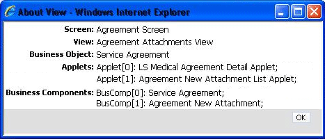

  4. Select About View from the Web Client Help menu. The About View screen is displayed with information about the view, applets, and business components used for the selected object. For example, if modifying a service agreement object, information on the following items might be displayed:
    • Screen: Agreement Screen
    • View: Agreement Attachments View
    • Business Object: Service Agreement
    • Applets: Applet[0]: LS Medical Agreement Detail Applet; Applet[1]: Agreement New Attachment List Applet;
    • Business Components: BusComp[0]: Service Agreement; BusComp[1]: Agreement New Attachment;
    In this example you are replacing the Agreement New Attachment List Applet (Applet[1]).
  5. Note the information and click OK to close the About View screen.

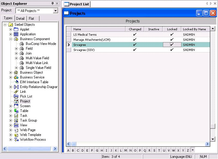

  3. Search for the projects you found in step 2 by doing the following:
    1. Select Project in the Object Explorer and press Ctl+Q to display the query dialog screen.
    2. Enter a query string that includes the projects found in step 2 and press Enter. A list of projects is displayed. In this example, the query string would be
      Srvagree ?SSV? OR LS Medical Terms OR Manage Attachments?UCM? OR Srvagree
  4. Lock each project found in step 2 by selecting the Locked column next to the project name. This locks all objects, views, applets, business components, and screens that are associated with each project. A check mark is displayed in the Locked column when a project is successfully locked.

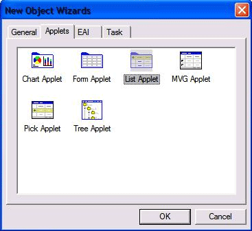

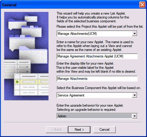

  2. Under the Applets tab, select List Applet and click OK. The New Applet Wizard is displayed.
    Figure B-4 The New Applet Wizard Screen
    Description of Figure B-4 follows
    Description of "Figure B-4 The New Applet Wizard Screen"
  3. Select Manage Attachments (UCM) as the project.
  4. Enter a descriptive name. For example, enter Manage Agreement Attachments Applet (UCM).
  5. Enter Managed Attachments as the display title.
  6. Select Service Agreement as the Business Component the applet is to be based on.
  7. Select Admin as the upgrade behavior, then click Next. The Web Layout screen is displayed.

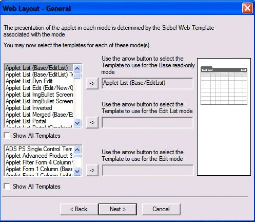

  8. Select Applet List (Base/Edit List) from the first list of template options and click the arrow to confirm its use, then click Next. The Fields screen is displayed.

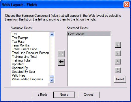

  9. Select UcmServUrl from the Available Fields section and click the arrow to move it to the Selected Fields section and click Next. The Fields screen changes to display the Available Controls section.

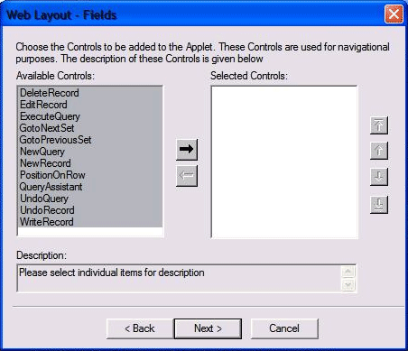

  10. Select all controls in the Available Controls section and click the arrow to move them to the Selected Controls section, then click Next.

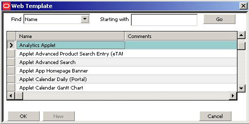

  6. Select Base in the top Applet Web Templates section of the screen. The Web Template dialog is displayed.
  7. Select Analytics Applet from the Name column and click OK. The Web Template dialog closes.

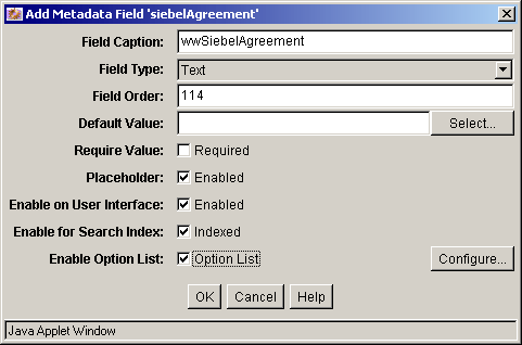

  5. Enter the name of the field being added. Typically the format is siebel followed by the Entity name. For example siebelAgreement.
  6. Click OK. The Add Metadata Field 'field_name' is displayed.
  7. Ensure that the following options are enabled:
    • Placeholder
    • Enable on User Interface
    • Enable for Search Index
    • Enable Option List
  8. Modify the Field Caption by adding ww to the beginning of the caption and capitalizing Siebel. For example, siebelAgreement becomes wwSiebelAgreement.
  9. Click Configure. The Configure Option List for 'field_name' screen is displayed.
  10. Select Multiselect List as the Option List Type.
  11. Enable Use view and click OK. The Add Metadata Field 'field_name' screen closes and the Configuration Manager screen is displayed.

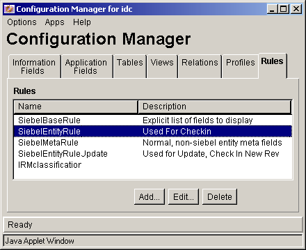

  1. With the Configuration Manager screen still displayed, click Rules. The Rules tab is displayed.
    Figure B-10 Configuration Manager Screen
    Description of Figure B-10 follows
    Description of "Figure B-10 Configuration Manager Screen"
  2. Select SiebelEntityRule and click Edit. The Edit Rule SiebelEntityRule screen is displayed.

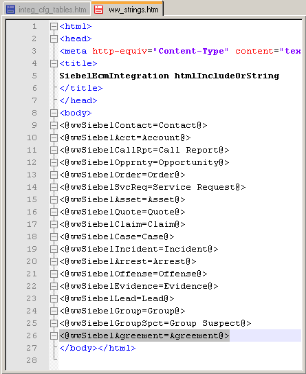

B.13.3 Editing Necessary Content Server Resource and String Files
After adding the information fields to Content Server, you must account for them in the Content Server integ_cfg_tables.htm and ww_strings.htm files. Do the following steps:
  1. Open the integ_cfg_tables.htm file in a standard text editor. The integ_cfg_tables.htm file is located in the following directory: content_server_install_dir/custom/SiebelEcmIntegration/resources
  2. Add a row to the end of the DocTagDefList table with a cell for the field name entered in step 5 of Adding Rules for Displaying Fields and the field caption entered in step 8 of the same section. For example:
    <tr>
       <td>xsiebelAgreement</td>
       <td>wwSiebelAgreement</td>
    </tr>
  3. Open the ww_strings.htm file in a standard text editor. The ww_strings.htm file is located in the following directory: content_server_install_dir/custom/SiebelEcmIntegration/resources/lang/en
    Only the ww_strings.htm file in the content_server_install_dir/custom/SiebelEcmIntegration/resources/lang/en directory needs to be edited. The change will modify the ww_strings.htm files in the other language directories automatically.
  4. Add the field caption information added in step 8 of Adding Rules for Displaying Fields to the end of the body section. For example:
    <@wwSiebelAgreement=Agreement@>
    Agreement was the Siebel Entity added as an example in this appendix. Ensure that you use the name of the Entity that you added.
  5. Restart Content Server. The new Entity is enabled.
    Figure B-11 Enabling New Entity
    Description of Figure B-11 follows
    Description of "Figure B-11 Enabling New Entity"
