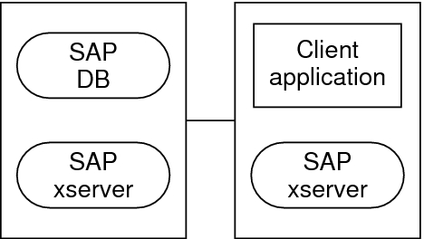

Example 1  Two-Node Configuration
This example shows a two-node configuration in which a client application accesses the SAP MaxDB resource through the SAP xserver resource. The characteristics of this configuration are as follows:
  • The SAP MaxDB resource is configured as a failover data service.
  • The SAP xserver resource is configured as a multiple-master data service.
