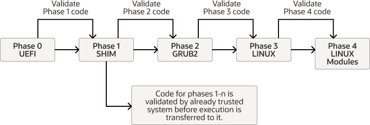

The following figure illustrates the Secure Boot process:
Figure 1-1 Secure Boot Process
Phase 0: The UEFI checks whether Secure Boot is enabled and loads the keys that it stores for this purpose from the UEFI Secure Boot key database.
Phase 1: The Shim software loads. UEFI first validates the signature that was used to sign the Shim. If the signature is valid, the Shim loading can continue. Otherwise, the Shim is unable to load. Thereafter, the loaded Shim is responsible for validating all code. The Shim maintains its own MOK database, where other keys are stored for validation purposes.
Phase 2: The Shim software validates the key that's used to sign the GRUB2 secondary bootloader. If validation passes, GRUB2 loads. the Shim can then validate the keys that are used to sign the kernel images available to GRUB2.
Phase 3: A valid kernel loads. The kernel has read access to the keys in the UEFI Secure Boot key database and the MOK database. The kernel also has its own set of trusted keys that are built into the kernel image itself.
Phase 4: The kernel validates the keys that are used to sign all other modules that
need to be loaded, including signed kernel images on kexec
operations.
Depending on the kernel implementation, the kernel would trust the keys in the UEFI Secure
Boot database or the MOK database. Or, it would only trust the keys that are built into the
kernel image itself. Note that for kexec
signed kernel images signature
validation, the following keys can be used: UEFI, DB/MOK, DB keys, and kernel builtin keys.

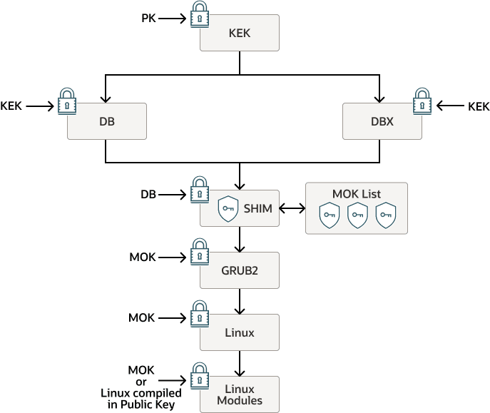

Description of the Secure Boot Key Implementation
The following figure shows how the Secure Boot key implementation works in Oracle Linux.
At the UEFI firmware level, the Platform Key (PK) is used to validate the Key Exchange Key
(KEK), which is in turn used to validate all Database Keys (DB) and all DBX Keys (DBX). The DB
keys are used with the DBX keys to validate the key used to sign the Shim binary. After the
Shim is validated, keys stored within the MOK list and loaded by the Shim can be trusted to
perform validation for the later loading operations that follow. The GRUB2 secondary
bootloader is validated by using a key within the MOK list and by the MokListX that contains
the forbidden MOK keys. Similarly, before the kernel is loaded, validation of the kernel image
binary is first performed against the keys in the MOK list. Finally, after the kernel is
loaded, the Linux kernel modules or Linux kernel images that are used for
kexec
operations can be validated, either against the MOK list or against
any public keys that are compiled directly into the Linux kernel.
