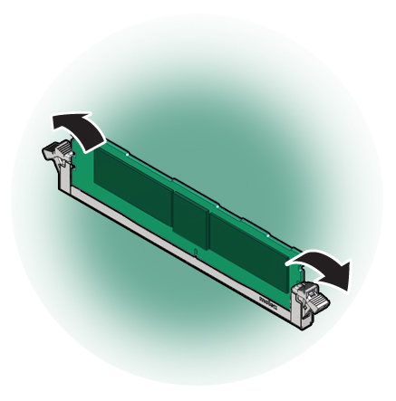

Rotate both DIMM socket ejectors outward as far as they will
go.
The DIMM is partially ejected from the socket. This action extracts the DIMM from its connector.

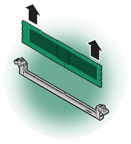

Remove the faulty DIMM from the CMOD.
Carefully lift the DIMM straight up to remove it from the socket.
Replace each faulty DIMM with either another DIMM of the same rank
size (quad-rank or dual-rank) or leave the socket empty.
