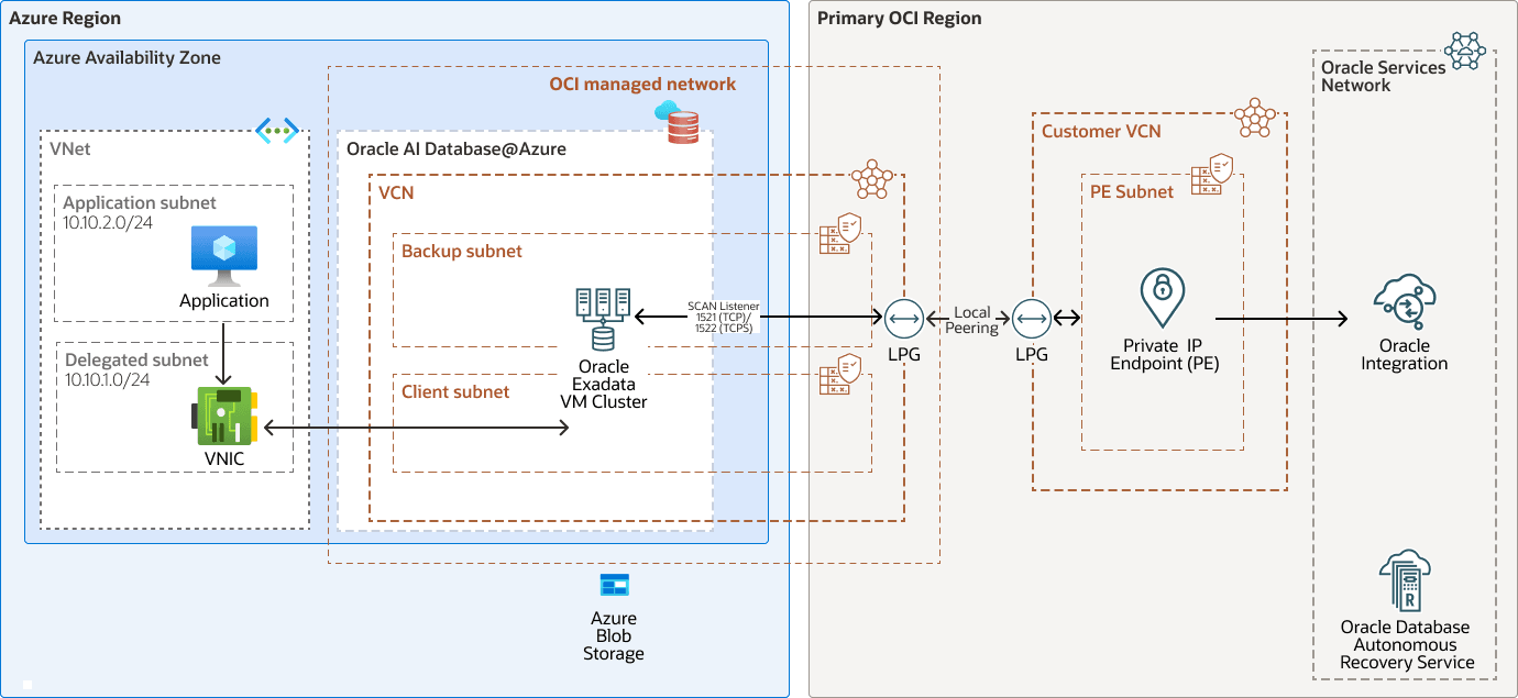

The following diagram shows the same-region topology.
Description of same-region-connectivity-oi-od-azure.png follows
same-region-connectivity-oi-od-azure-oracle.zip#GUID-A0B4776E-BBF4-43F8-BBB5-CE6F073DCD6F
  • An integration invokes an Oracle AI Database adapter connection that uses the Oracle Integration private endpoint.
  • The private endpoint has a private IP address in the private endpoint subnet of the customer VCN.
  • Local peering gateways route traffic between the customer VCN and the Oracle AI Database@Azure client subnet entirely over Oracle's private network.
  • The connection reaches the SCAN listener on port 1521, or port 1522 for TCPS. The listener directs the session to an Oracle Real Application Clusters (Oracle RAC) node on the Exadata VM cluster, providing instance and node-level failover during maintenance.

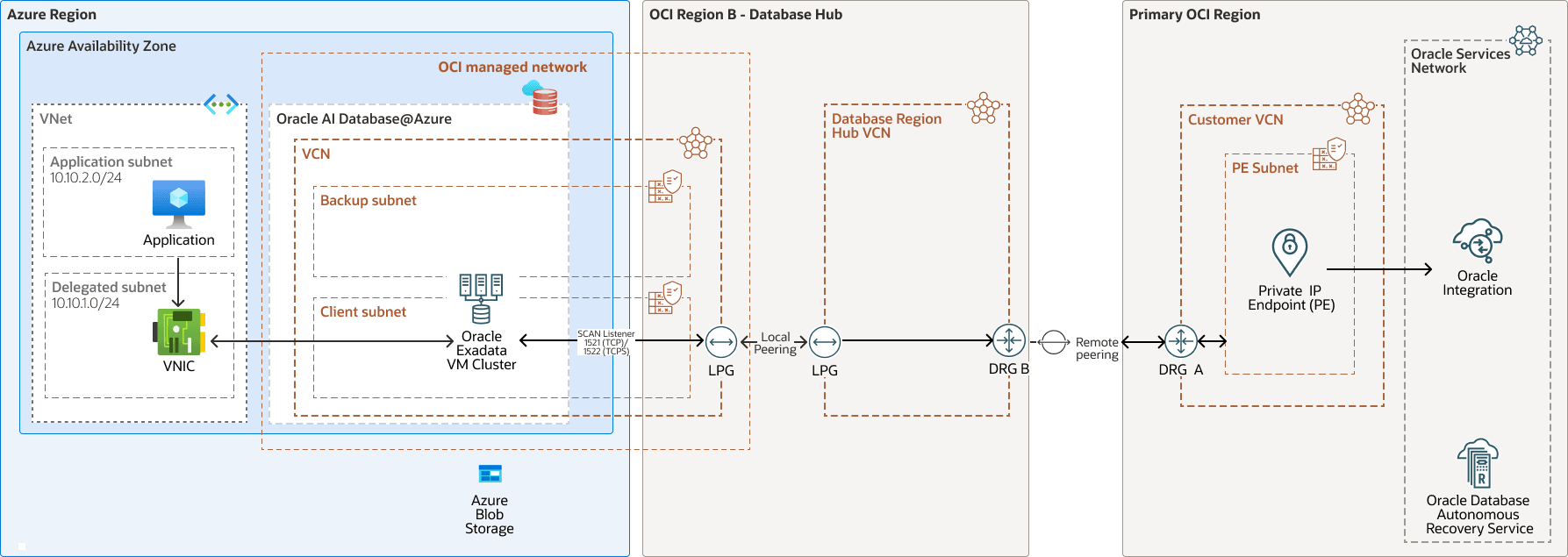

The following diagram shows the cross-region topology.
Description of cross-region-connectivity-oi-od-azure.png follows
cross-region-connectivity-oi-od-azure-oracle.zip#GUID-3837E26D-EA4A-4A03-BD72-C4E831AEAE4A
  • The customer-managed VCN attaches to DRG-A and uses a route rule for the Oracle AI Database@Azure client subnet.
  • DRG-A connects to DRG-B through a remote peering connection, keeping inter-region traffic on Oracle's private network.
  • DRG-B routes traffic through a database-region hub VCN, whose local peering gateway connects to the Azure Virtual Network (VNet) associated with Oracle AI Database@Azure through the service-supported local peering configuration.
  • The connection reaches the same SCAN listener and RAC cluster as in the same-region topology.
