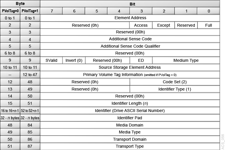

Data transfer elements are the tape drives in the library. The Data Transfer Element Descriptor Definitions page describes a tape drive.
Figure 3-25 Data Transfer Element Descriptor (DvcID = 0)
Description of "Figure 3-25 Data Transfer Element Descriptor (DvcID = 0)"
Figure 3-26 Data Transfer Element Descriptor (DvcID = 1)
Description of "Figure 3-26 Data Transfer Element Descriptor (DvcID = 1)"

- Element Address
The address of the element (robot hand, cartridge cell, CAP cell, drive, or empty drive slot).
 - OIR
0 = No operator intervention required to make the CAP accessible
1 = Operator intervention required to make the CAP accessible
 - CMC
0 = The import/export element is a CAP. The cartridge will not leave the library when prevented by the Prevent/Allow Medium Removal (1Eh) command.
 - InEnab
1 = The CAP supports importing cartridges.
 - ExEnab
1 = The CAP supports exporting cartridges.
 - Access
0 = The robot cannot access the element. For Import/Export elements, this can occur when the CAP is open or a CAP magazine was removed. For Data transfer elements, this can occur when a cartridge is loaded in a drive.
1 = The robot can access the element
 - Except
0 = The element is in a normal state
1 = The element is in an abnormal state. The Additional Sense Code (ASC) and the Additional Sense Code Qualifier (ASCQ) fields contain information regarding the abnormal state. Other fields in the descriptor might be invalid and should be ignored.
 - ImpExp
0 = The robot placed the cartridge in the CAP for an export operation.
1 = An operator placed the cartridge in the CAP for an import operation.
 - Full
0 = The element does not contain a cartridge
1 = The element contains a cartridge
 - ASC (Additional Sense Code)
This field is valid only if the Except bit is set. In the case of an exception, it contains an ASC as defined for Request Sense data.
 - ASCQ (Additional Sense Code Qualifier)
This field is valid only if the Except bit is set. In the case of an exception, it contains an ASCQ as defined for Request Sense data.

 - SValid
0 = The Source Element Address and Invert fields are not valid.
1 = The Source Element Address and Invert fields are valid.
 - Invert (not supported)
0 = The library does not support multi-sided media.
 - ED
0 = The element is enabled.
1 = The element is disabled (for example an open CAP, a drive hardware error, or empty drive slot).
 - Medium Type
The type of medium currently present in the element as determined by the medium changer.
0h = Unspecified - the medium changer cannot determine the medium type.
1h = Data Medium
2h = Cleaning Medium
 - Source Storage Element Address
This field is valid only if the SValid field is 1. This field provides the address of the last storage element this cartridge occupied. The element address value may or may not be the same as this element.
 - Primary Volume Tag Information
When PVolTag is 1, the library returns volume tag information. When PVolTag is 0, the library omits volume tag information.
The Primary Volume Tag field contains the null-terminated ASCII barcode label on the tape cartridge. If the label on the cartridge tape is not readable or if the element is empty, the Primary Volume Tag field is filled with 36 bytes of zeros. The "Volume Label Format" controls the presentation of the volser in the Primary Volume Tag field. The library supports the following settings:
Full Label
No Type Checking
Prepend Last Two Characters
Trim Last Character
Trim Last Two Characters
Trim First Two Characters
Trim First Character

 - Code Set
0h = Reserved (not supported) for the Medium Transport Element, Storage Element, Import/Export Element, or Data Transfer Element (DvcID = 0) descriptors.
2h = The identifier contains ASCII graphic codes (code values 20h through 7Eh) for Data Transfer Element (DvcID = 1) descriptor.
 - Identifier Type
The format and assignment authority for the identifier.
0h = The library returns vendor specific data.
 - Identifier Length
The combined length of the Identifier and the Identifier Pad.
00h = The library returns 0 bytes of identifier data in the descriptors for Medium Transport Elements, Storage Elements, Import/Export Elements, or Data Transfer Elements (DvcID = 0).
20h = The library returns 32 bytes of identifier data for the Data Transfer Element (DvcID = 1).
 - Identifier (for Data Transfer Element DvcID = 1 Only)
The ASCII Serial Number for the tape drive associated with this data transfer element.
 - Identifier Pad (for Data Transfer Element DvcID = 1 Only)
Contains ASCII blanks. The number of blanks depends on the length of the Identifier field. The combined length of the Identifier field and the Identifier Pad is 32 bytes.
 - Media Domain
43h ('C') = The element contains a cleaning cartridge.
4Ch ('L') = The element contains an LTO cartridge.
54h ('T') = The element contains a T10000 cartridge.
FFh = The media domain cannot be determined or the element is empty.
 - Media Type
FFh = The media type cannot be determined or the element is empty.

 - Transport Domain
4Ch (L) = The drive supports LTO cartridges.
54h (T) = The drive supports T10000 cartridges.
FFh = The element domain cannot be determined.
 - Transport Type
FFh = The type cannot be determined.
If the Transport Domain is 4Ch (L):
3Bh = HP Generation 5 LTO drive
3Ch = IBM Generation 5 LTO drive
3Dh = HP Generation 6 LTO drive.
3Eh = IBM Generation 6 LTO drive.
2Dh = IBM Generation 7 LTO drive.
2Eh = IBM Generation 8 LTO drive.
46h = IBM Generation 9 LTO drive.
If the Transport Domain is 54h (T):
0Dh = StorageTek T10000A drive.
0Eh = StorageTek T10000A drive in 3590 emulation mode.
18h = StorageTek T10000A Encrypting drive.
19h = StorageTek T10000A Encrypting drive in 3590 emulation mode.
1Ah = StorageTek T10000B drive.
1Bh = StorageTek T10000B drive in 3590 emulation mode.
1Ch = StorageTek T10000B Encrypting drive.
1Dh = StorageTek T10000B Encrypting drive in 3590 emulation mode.
22h = StorageTek T10000C drive.
23h = StorageTek T10000C drive in 3590 emulation mode.
24h = StorageTek T10000C Encrypting drive.
25h = StorageTek T10000C Encrypting drive in 3590 emulation mode.
26h = StorageTek T10000D drive.
27h = StorageTek T10000D drive in 3590 emulation mode.
28h = StorageTek T10000D Encrypting drive.
29h = StorageTek T10000D Encrypting drive in 3590 emulation mode.
2Ah = StorageTek T10000D Fibre Channel over Ethernet.
2Bh = StorageTek T10000D Fibre Channel over Ethernet Encrypting drive.
 - Transport Serial Number
The 32-byte ASCII serial number for the drive.
For drives with a serial number less than 32 bytes, the library left-justifies the value by returning ASCII blanks for the unused less-significant bytes. If the serial number is not available from a drive that should support an ASCII serial number, the library returns all ASCII blanks.
