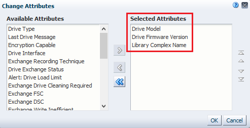

  3. Reorganize the pivot table to aggregate firmware levels by drive model.
    1. Above the table, click Change Attribute Change Attributes icon.
    2. Rearrange the attributes so the Selected Attributes list is as follows:
      • Drive Model
      • Drive Firmware Version
      • Library Complex Name
    3. Click OK.
      Change Attributes dialog with the Selected Attributes noted.

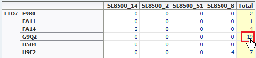

  4. To display a detailed listing of any of the subtotals, click the text link in a cell.
    Pivot table with a text link being clicked.
    You are taken to the Drives – Overview screen, which displays additional detail for the drives included in the selected subtotal.
