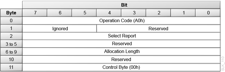

Report LUNs (A0h)
Report LUNS (A0h) returns the known LUNs to which the initiator can send commands.
- Select Report
00h = The library returns LUN addresses limited to the LUN addressing method, peripheral device addressing method, and the flat space addressing method.
02h = The library returns all LUNs accessible to the initiator.
- Allocation Length
The number of bytes allocated for data to be returned from the Report LUNs command.
The Allocation must be at least 16 bytes. If it is less, the library returns a check condition with the sense key set to "illegal request" and the additional sense data set to "invalid field" in the command descriptor block (CDB).
