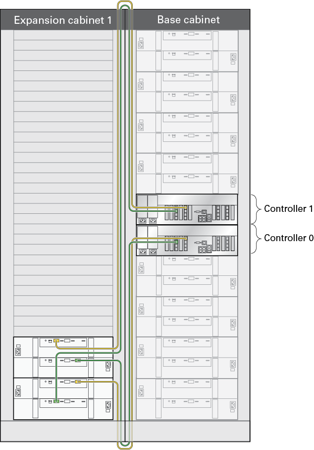

Cabling Controllers in a Base Cabinet to Disk Shelves in an Expansion Cabinet (Oracle ZFS Storage ZS4-4 to Oracle Storage Drive Enclosure DE2-24C shown)
The illustration above only shows the 6-meter cables connecting from the base cabinet to the expansion cabinet. To cable the rest of the disk shelves, locate the appropriate cabling diagram in the Getting Started with Cabling. -
