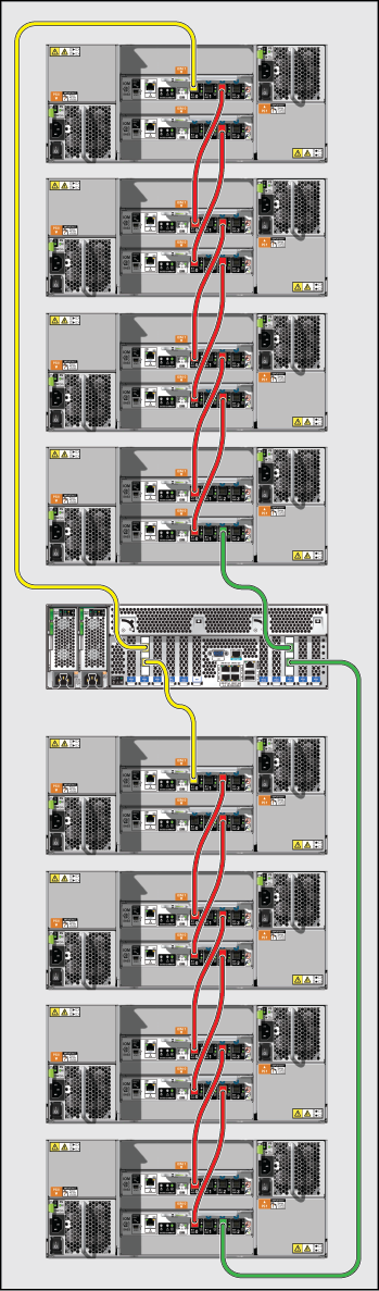

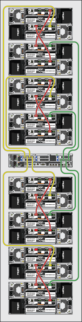

    Cabling Controllers to Disk Shelves in a Base Cabinet (Oracle ZFS Storage ZS5-4 to Oracle Storage Drive Enclosure DE3-24P shown)
    The graphic shows cabling Controllers to Disk Shelves in a Base Cabinet (Oracle ZFS Storage ZS5-4 to Oracle Storage Drive Enclosure DE3-24P shown)
    Cabling Controllers to Disk Shelves in a Base Cabinet (Oracle ZFS Storage ZS5-4 to Oracle Storage Drive Enclosure DE3-24C shown)
    The graphic shows cabling Controllers to Disk Shelves in a Base Cabinet (Oracle ZFS Storage ZS5-4 to Oracle Storage Drive Enclosure DE3-24C shown)

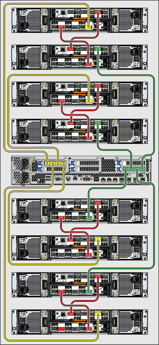

    Cabling Controllers to Disk Shelves in a Base Cabinet (Oracle ZFS Storage ZS3-2 to Oracle Storage Drive Enclosure DE2-24P shown)
    The graphic shows cabling Controllers to Disk Shelves in a Base Cabinet (Oracle ZFS Storage ZS3-2 to Oracle Storage Drive Enclosure DE2-24P shown)
    Cabling Controllers to Disk Shelves in a Base Cabinet (Oracle ZFS Storage ZS3-2 to Oracle Storage Drive Enclosure DE2-24C shown)
    The graphic shows cabling Controllers to Disk Shelves in a Base Cabinet (Oracle ZFS Storage ZS3-2 to Oracle Storage Drive Enclosure DE2-24C shown)
