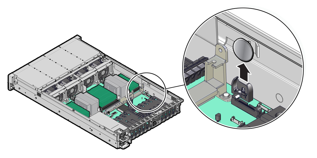

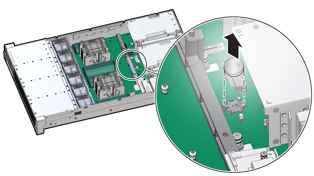

Replacing an Oracle ZFS Storage ZS11-2 System Battery
Replacing a system battery is a cold-swap procedure, and you must remove power from the controller. You might need to replace the battery if the controller fails to maintain the proper time when powered off and disconnected from the network. Use the following procedure to replace an Oracle ZFS Storage ZS11-2 system battery.
