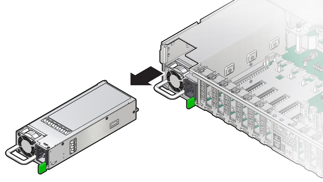

Grasp the power supply handle and push the green power supply latch to the
left.
Pull the power supply out of the controller.
Caution:
Whenever you remove a power supply, you should replace it with another power supply; otherwise, the controller could overheat due to improper airflow. -

Always replace the failed power supply with the same type model of power supply. - Align the replacement power supply with the empty power supply slot.
Slide the power supply into the slot until it is fully seated.
You will hear an audible click when the power supply fully seats.
