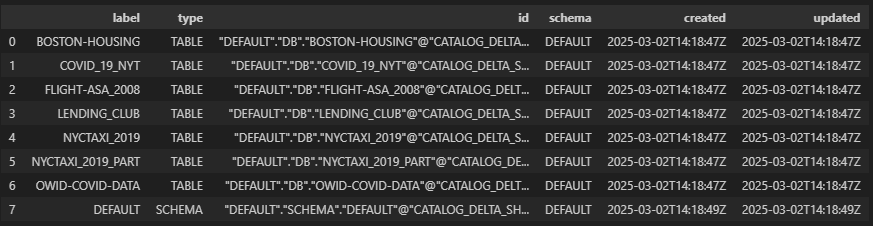

Ejemplos
import json
import pandas as pd
# catalog api function call
r = Catalog.get_catalog_entities('CATALOG_DELTA_SHARING_1')
# pandas data frame representation
j = json.loads(r)
pd.json_normalize(j)

Ejemplo
Mount Shares Catalog# catalog api function call
Catalog.mount_shares_catalog (
        catalog_name   = 'CATALOG_DELTA_SHARING_1',
        share_name     = 'DELTA_SHARING',
        share_provider = 'PROVIDER_DELTA_SHARING_1')
Salida
'[{"catalogName":"CATALOG_DELTA_SHARING_1","shareName":"DELTA_SHARING"}]'
Tipo de Retorno
Es una cadena JSON.
Estructura de devolución
'[{"catalogName": catalog name (String),
"shareName": share name (String)}]'
Tipo de Error
Cadena JSON
Estructura de errores
'{"code": error code (Number), "error": error message (String)}'
