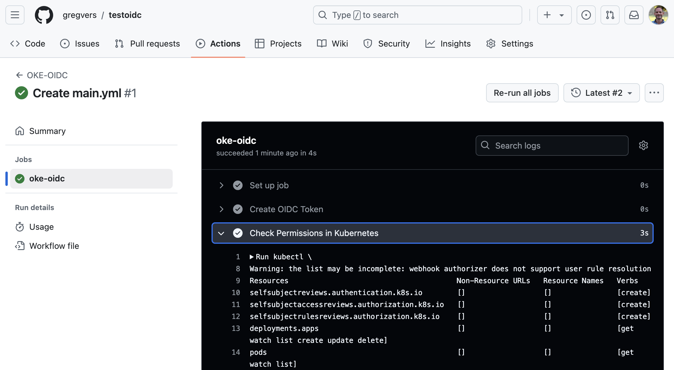

    Pegue el siguiente código en el editor y actualice server="https://X.X.X.X:6443"con la IP pública del cluster.name: OKE-OIDC on: # Triggers the workflow on push or pull request events but only for the "main" branch push: branches: [ "main" ] pull_request: branches: [ "main" ] # Allows you to run this workflow manually from the Actions tab workflow_dispatch: permissions: id-token: write # Required to receive OIDC tokens # This workflow generates a GitHub Actions OIDC token and runs kubectl command in an OKE cluster jobs: oke-oidc: runs-on: ubuntu-latest steps: - name: Create OIDC Token id: create-oidc-token run: | AUDIENCE="oke-kubernetes-cluster" OIDC_URL_WITH_AUDIENCE="$ACTIONS_ID_TOKEN_REQUEST_URL&audience=$AUDIENCE" IDTOKEN=$(curl \ -H "Authorization: Bearer $ACTIONS_ID_TOKEN_REQUEST_TOKEN" \ -H "Accept: application/json; api-version=2.0" \ "$OIDC_URL_WITH_AUDIENCE" | jq -r .value) echo "::add-mask::${IDTOKEN}" echo "idToken=${IDTOKEN}" >> $GITHUB_OUTPUT - name: Check Permissions in Kubernetes run: | kubectl \ --token=$ \ --server="https://X.X.X.X:6443" \ --insecure-skip-tls-verify \ auth can-i --listEl flujo de trabajo de Github Actions se ejecutará automáticamente. El comando kubectldevolverá las operaciones autorizadas con la configuración de RBAC (get/watch/list pods y get/watch/list/create/update/delete deployments).
