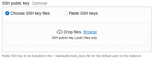

oci:core:ssh:publickey -- Supervise un contrôle permettant d'ajouter une ou plusieurs clés SSH publiques en supprimant des fichiers ou en collant des valeurs de clé. Pour plus d'informations, voir Contrôle de clé SSH.

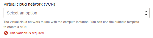

oci:core:vcn:id OCID du VCN

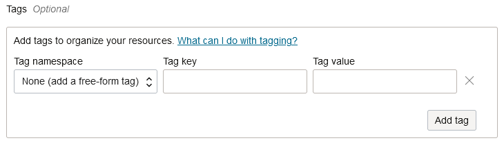

oci:identity:tag:value Nom de la clé de marqueur de l'espace de noms de marqueur; voir TagSummary Surface un contrôle permettant d'ajouter des marqueurs définis et à structure libre. Pour plus d'informations, voir Contrôle du marquage.

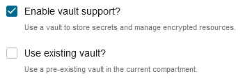

  - title: "Vault section"
    variables:
      - ${myVault}
      - ${myVaultKey}
      - ${mode}
      - ${myCompatibleKey}
      - ${algo}
      - ${myCompatibleKeyBasedOnAlgo}
      - ${mySecret}
      - ${myVaultSecret}

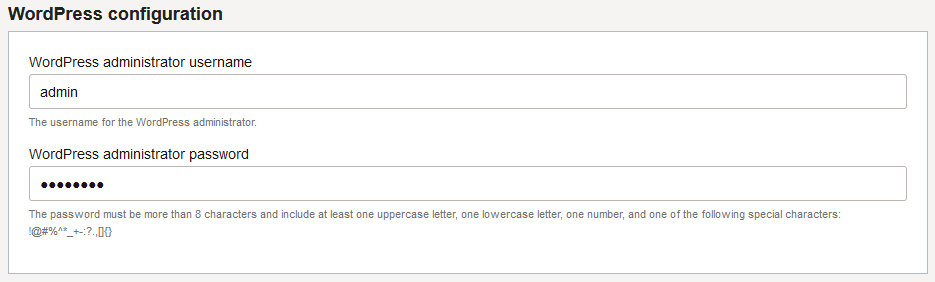

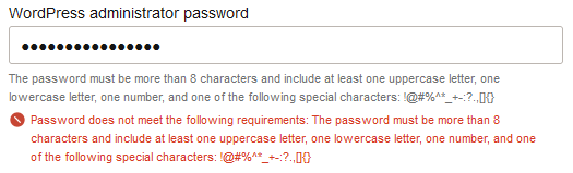

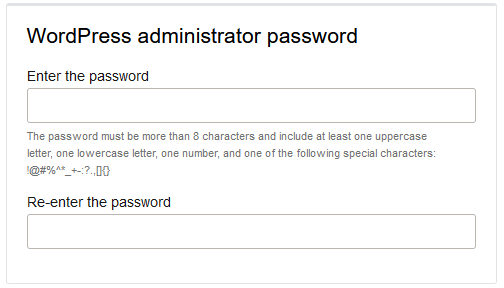

  # password field
  password:
    description: Really Bad Password Field
    type: password
    pattern: "^[a-zA-z]{1,8}$"
    required: true

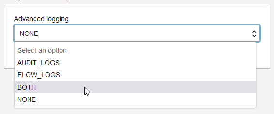

  # string enum
  objectStorageTier:
    type: enum
    enum:
      - archive
      - standard
    allowMultiple: false

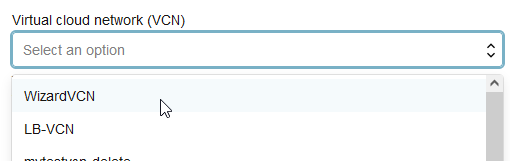

  myVcn:
    type: oci:core:vcn:id
    dependsOn:
      compartmentId: ${vcnCompartment}
    visible:
      or:
        - ${useExistingVcn}
        - and:
            - and:
                - true
                - true
            - not:
                - false

  iam_groups_use_existing:
    type: boolean
    title: Use existing Groups
    required: true
    default: false

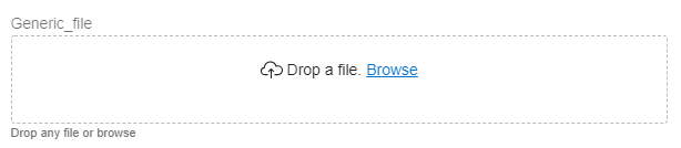

  generic_file:
    type: file
    required: true
    title: GenericFile
    description: "Drop a raw file (stored as base64 string data)"
  tag:
    type: oci:identity:tag:value
    required: true
    title: Tagging
    description: Tag value for resource created
    dependsOn:
      compartmentId: ${targetCompartment}

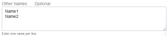

  multilineText:
    type: text
    required: false
    multiline: true
    title: Multi-line value
    description: Multi-line value
    default: "First line\nSecond line\nThird line"

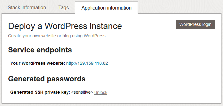

# Used to present outputs with more refinement on the Application Information tab.
# The Application Information tab is only shown if the schema has a "title",
# "description", and at least one output in this "outputs" section.
# type:
#   - boolean
#   - string
#   - number
#   - link - contains url that can be hyperlinked.  If type is not specified and the
#            value is a proper url, this type is assumed.
#   - ocid - contains an OCID.  An attempt is made to hyperlink it to the designated
#            resource in the console.
#   - csv - synonym for list.  Array of values converted to a comma separated list.
#   - json - synonym for map.  Map of key / values converted to JSON.
#   - list - array of values converted to a comma separated list.
#   - map - map of key / values converted to JSON.
# displayText: used in links to give text displayed instead of value
# title: friendly label
# visible: if false, this ouptut is not shown in the outputs section of Application Information.
#          It can still be used as the primaryOutputButton.
outputs:
  controlCenterUrl:
    type: link
    title: Control Center
    displayText: Control Center
    visible: false
  schemaRegistryUrl:
    type: link
    title: Schema Registry
    displayText: Schema Registry
  schemaRegistryPublicIps:
    type: csv
    title: Public IPs
  schemaRegistryLoadBalancer:
    type: ocid
    title: Load Balancer
  brokerPublicIps:
    type: csv
  connectUrl:
    type: link
    title: Connect
    displayText: Connect

# primaryOutputButton is a reference to a link output that creates a primary button
# on the Application Information tab.
# (Optional) if not provided, no primary button is shown.  Also if the output
# referenced is not a link output, no button is shown.
primaryOutputButton: ${controlCenterUrl}
# Used to group Outputs.  Any outputs not included in these defined groups, are
# included in a default group labelled "Outputs".
# (Optional) if not groups are given, outputs are not grouped at all.
outputGroups:
  - title: Schema Registry
    outputs:
      - ${schemaRegistryUrl}
      - ${schemaRegistryPublicIps}
      - ${schemaRegistryInstances}
      - ${schemaRegistryLoadBalancer}
  - title: Broker / Connect
    outputs:
      - ${brokerPublicIps}
      - ${brokerInstances}
      - ${connectUrl}
      - ${connectPublicIps}
      - ${restUrl}

Champ de texte multiligne
Pour afficher une variable en tant que champ de texte multiligne :
  • Ajoutez la ligne multiline: true.
Pour déclarer une valeur par défaut comportant plusieurs lignes :
  • Séparez chaque ligne par \n.
Exemple d'image pour une variable affichée en tant que champ de texte multiligne, avec deux lignes de texte entrées :
Champ de texte multiligne, avec deux lignes de texte entrées.
Exemple de déclaration pour un champ de texte multiligne :
  otherNames:
    type: text
    required: false
    multiline: true
    title: "Other Names"
    description: "Enter one name per line."
    default: "Name1\nName2"
Groupe et commande
Pour afficher un groupe (boîte) de variables, avec les variables dans une séquence prescrite :
  • Ajoutez un bloc variableGroups.
  • Ajoutez une ligne title à ce bloc.
  • Ajoutez un bloc variables à variableGroups.
  • Ajoutez des variables au bloc variables dans l'ordre souhaité.
Exemple d'image pour un groupe de variables :
Configuration du groupe de variables WordPress contenant les champs de nom d'utilisateur et de mot de passe.
Exemple de déclaration pour un groupe de variables avec un ordre prescrit :
variableGroups:
  - title: "WordPress configuration"
    variables:
    - wp_admin_user
    - wp_admin_password
Contrôle de clé SSH
Pour afficher une variable en tant que contrôle de clé SSH :
  • Ajoutez la ligne type: oci:core:ssh:publickey.
Exemple d'image pour un contrôle de clé SSH :
Exemple de déclaration pour un contrôle de clé SSH :
  ssh_public_key:
    title: SSH public key
    description: Public SSH key to be included in the ~/.ssh/authorized_keys file for the default user on the instance
    # renders variable as an SSH key control
    additionalProps:
      allowMultiple: true
    required: false
    default: [""]
    pattern: "((^(ssh-rsa AAAAB3NzaC1yc2|ecdsa-sha2-nistp256 AAAAE2VjZHNhLXNoYTItbmlzdHAyNT|ecdsa-sha2-nistp384 AAAAE2VjZHNhLXNoYTItbmlzdHAzODQAAAAIbmlzdHAzOD|ecdsa-sha2-nistp521 AAAAE2VjZHNhLXNoYTItbmlzdHA1MjEAAAAIbmlzdHA1Mj|ssh-ed25519 AAAAC3NzaC1lZDI1NTE5|ssh-dss AAAAB3NzaC1kc3)[0-9A-Za-z+\/]+[=]{0,3})( [^,]*)?)(,((ssh-rsa AAAAB3NzaC1yc2|ecdsa-sha2-nistp256 AAAAE2VjZHNhLXNoYTItbmlzdHAyNT|ecdsa-sha2-nistp384 AAAAE2VjZHNhLXNoYTItbmlzdHAzODQAAAAIbmlzdHAzOD|ecdsa-sha2-nistp521 AAAAE2VjZHNhLXNoYTItbmlzdHA1MjEAAAAIbmlzdHA1Mj|ssh-ed25519 AAAAC3NzaC1lZDI1NTE5|ssh-dss AAAAB3NzaC1kc3)[0-9A-Za-z+\/]+[=]{0,3})( [^,]*)?)*$"
Contrôle de fichier
Pour afficher une variable en tant que contrôle de fichier :
  • Ajoutez la ligne type: file.
    Note
    Le fichier chargé est stocké au format Base64. Pour utiliser le fichier, décodez la sortie. Par exemple, ajoutez le code suivant à un fichier outputs.tf dans la configuration Terraform.
    output "generic_file_raw" {
      value = base64decode(var.generic_file)
Exemple d'image pour un contrôle de fichier :
Contrôle de fichier.
Exemple de déclaration pour un contrôle de fichier :
  generic_file:
    type: file
    title: generic_file
    description: Drop any file or browse
    required: true
Contrôle de marquage
Pour afficher une variable en tant que contrôle de balisage :
  • Ajoutez la ligne type: oci:identity:tag:value.
    Note
    Pour préalimenter les valeurs de marqueur dans la console, accédez aux valeurs à partir de la configuration Terraform. Par exemple, ajoutez le code suivant à un fichier main.tf dans la configuration Terraform.
    resource "oci_logging_log_group" "sample_log_group" {
      compartment_id = var.compartment_ocid
      display_name   = "sample_log_group"
      description    = "Prepopulated tag values"
      freeform_tags  = var.tag_value.freeformTags
      defined_tags   = var.tag_value.definedTags
Exemple d'image pour un contrôle de marquage :
Exemple de déclaration pour un contrôle de marquage :
  tag_value:
    title: Tags
    required: true

Préalimentation dynamique
Pour préalimenter dynamiquement les variables avec des valeurs basées sur des dépendances :
Exemple d'image pour une variable préalimentée dynamiquement :
Valeurs préalimentées pour le champ Réseau en nuage virtuel (VCN).
Exemple de déclaration pour une variable préalimentée dynamiquement :
    vcn_ocid:
    "title": "Virtual cloud network (VCN)",
    "description": "The virtual cloud network to use with the compute instance. You can use the subnets template to create a VCN."
    # prepopulates available values for VCN
    # determines values for prepopulation from selected compartment
      dependsOn:
        compartmentId: compartment_ocid
      required: true
      default: ""

Valeurs énumérées (sélection d'une seule valeur)
Pour afficher les valeurs énumérées pour une variable (permettant de sélectionner une valeur) :
  • Ajoutez les lignes type: enum et ajoutez un bloc enum.
Exemple d'image pour une variable avec des valeurs énumérées qui permettent la sélection d'une seule valeur :
Valeurs énumérées pour le champ de journalisation avancée.
Exemple de déclaration pour une variable avec des valeurs énumérées :
  advanced_logging_option:
    title: "Advanced logging"
    description: "Enable or disable advanced logging (VCN flow logs and/or audit logs)."
    type: enum
    # enumerated values
    enum:
    - AUDIT_LOGS
    - FLOW_LOGS
    - BOTH
    - NONE
    default: NONE
    required: true

Cocher la case
Pour afficher une variable en tant que case à cocher :
  • Ajoutez la ligne type: boolean.
Exemple d'image pour une variable de case à cocher :
Affichage des cases à cocher pour la variable Activer la prise en charge de la chambre forte?
Exemple de déclaration pour une variable de case à cocher :
  ods_vcn_use_existing:
    # renders variable as a check box
    type: boolean
    title: "Enable vault support?"
    description: "Use a vault to store secrets and manage encrypted resources."
    required: true
    default: false

Pour masquer ou afficher des variables ou des groupes de variables en fonction d'autres variables :
  • Ajoutez la ligne visible: <other_variable> .
Exemple de variable Utiliser une chambre forte existante?, dont la visibilité dépend de la sélection de l'utilisateur pour la variable Activer la prise en charge de la chambre forte? :
L'option Utiliser une chambre forte existante? est visible uniquement lorsque l'option Activer la prise en charge de la chambre forte? est sélectionnée.
Exemples de déclarations qui affichent les champs "Nom de l'application" et "Nom de la passerelle d'API" (functions_app_name et apigateway_name) uniquement lorsque la case "Provisionner les fonctions et la passerelle d'API?" (enable_functions_apigateway) est cochée :
  enable_vault:
    type: boolean
    required: true
    default: false
  ods_use_existing_vault:
    type: boolean
    title: "Use existing vault?"
    description: "Use a pre-existing vault in the current compartment."
    required: true
    default: false
  # show only when enable_vault variable is selected
    visible: enable_vault
Mot de passe
Pour afficher une variable en tant que mot de passe :
  • Ajoutez la ligne type: password.
Pour exiger une nouvelle entrée pour la confirmation du mot de passe entré :
  • Ajoutez la ligne confirmation: true.
Exemple d'image pour une variable de mot de passe nécessitant une confirmation :
Invite de confirmation pour un mot de passe (mot de passe de l'administrateur WordPress).
Exemple de déclaration pour une variable de mot de passe nécessitant une confirmation :
  wp_admin_password:
    title: "WordPress administrator password"
    description: "The password must be more than 8 characters and include at least one uppercase letter, one lowercase letter, one number, and one of the following special characters: !@#%^*_+-:?.,[]{}"
    # renders variable as a password field
    type: password
    # renders a second field to re-enter the password for confirmation
    confirmation: true
    pattern: "^(?=.*[!@#%^*_+\\-:?.,\\[\\]\\{\\}])(?=.*[0-9])(?=.*[a-z])(?=.*[A-Z])(?!.*[$\\(\\)]).{8,32}$"
    required: true
Variables requises
Pour exiger une valeur pour une variable :
  • Ajoutez la ligne required: true.
Exemple d'image pour une variable requise, avec un avertissement de validation :
Avertissement de validation pour une variable requise (réseau en nuage virtuel (VCN)) qui n'a pas été alimentée.
Exemple de déclaration pour une variable requise :
    vcn_ocid:
      dependsOn:
    # displays validation warning if no value is selected or entered
      required: true
      default: ""

Modèle de validation
Pour valider la valeur entrée pour une variable par rapport à un modèle d'expression rationnelle :
  • Ajoutez la ligne pattern: <regular-expression> .
    <regular-expression> est le modèle de validation propre à la valeur à valider.
    Exemple de modèle d'hyperlien : ^https?:\/\/(www\.)?[-a-zA-Z0-9@:%._\+~#=]{2,256}\.[a-z]{2,4}\b([-a-zA-Z0-9@:%_\+.~#?&//=]*)$
Exemple d'image d'erreur de validation pour une valeur entrée :
Erreur de validation pour une valeur entrée (mot de passe de l'administrateur WordPress).
Exemple de déclaration pour une variable avec un modèle de validation :
  wp_admin_password:
    type: password
    confirmation: true
    # validate entered value against alphanumeric regular expression
    required: true

Onglet Informations sur l'application
Pour afficher l'onglet Informations sur l'application d'une pile créée à partir de votre configuration Terraform :
  • Ajoutez des lignes pour le schéma title et description.
  • Facultativement, ajoutez une ligne pour une zone de texte d'information bleue : informationalText.
  • Ajoutez au moins une sortie dans la section outputs, éventuellement regroupée à l'aide de outputGroups.
Pour permettre la copie d'une valeur de sortie affichée dans l'onglet Informations sur l'application :
  • Définissez le type : Ajoutez la ligne type: copyableString.
Exemple d'image pour l'onglet Informations sur l'application :
Onglet Informations sur l'application.
Exemple de déclaration pour un titre, une description et des sorties de schéma :
# heading under Application Information tab
title: "Deploy a WordPress instance"
# text under heading
description: "Create your own website or blog using WordPress."
# output variable groups
outputGroups:
- title: "Service endpoints"
  outputs:
    - wordpress_public_ip
- title: "Generated passwords"
  outputs:
    - generated_ssh_private_key
# output variable field names and values
outputs:
  wordpress_public_ip:
    type: link
    title: "Your WordPress website"
  generated_ssh_private_key:
    title: "Generated SSH private key"
    sensitive: true
