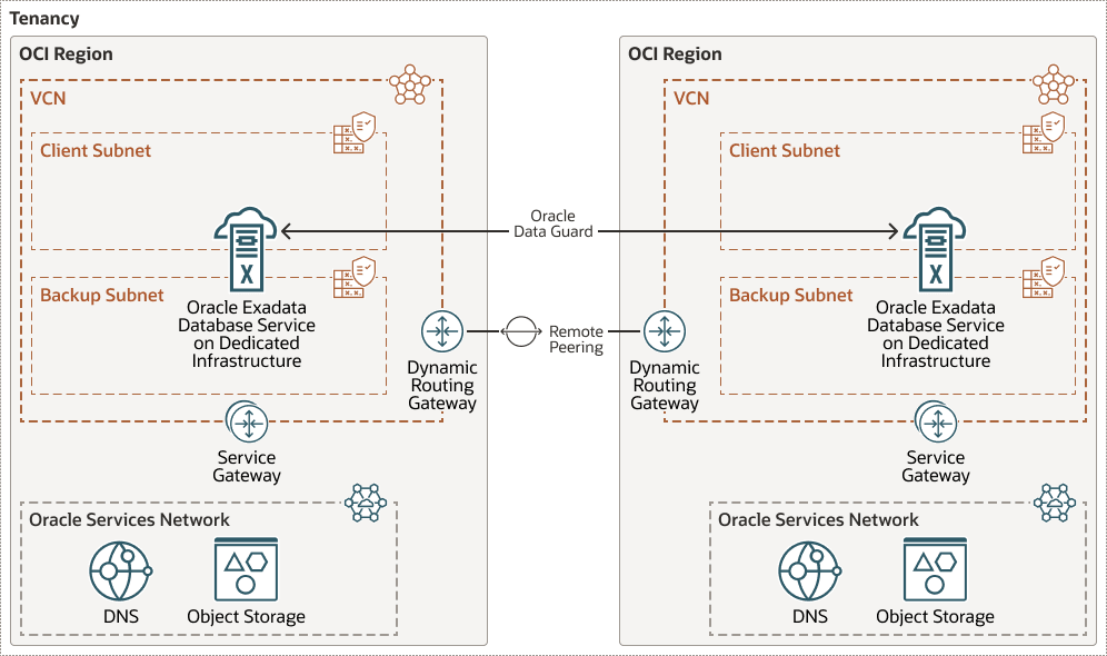

This architecture shows two Oracle Exadata Database Service on Dedicated Infrastructure databases located in different regions, with Oracle Data Guard configured between the databases to keep them both in sync.
Le diagramme suivant illustre cette architecture.
exadata-dedicated-cross-region-dataguard.zip

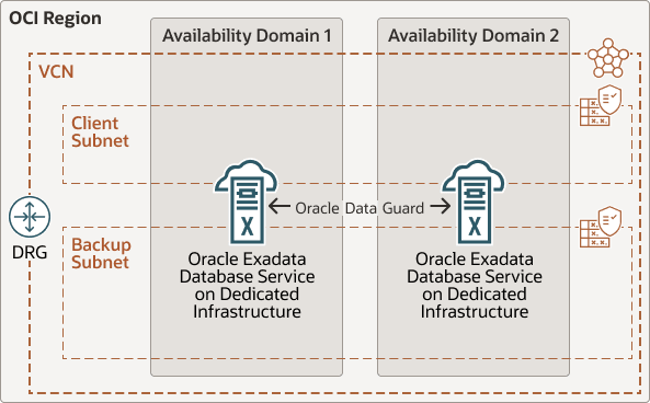

Alternatively, your Oracle Exadata Database Service on Dedicated Infrastructure databases can be located within the same region.
exadata-dedicated-region-dataguard.zip
