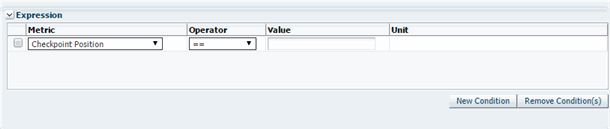

In the Expression table, specify the condition (or multiple conditions) that will trigger the alert. Different conditions that are used in one expression are combined with logical AND operators, and the alert will be triggered when both of the conditions is satisfied.
For Metric, select the attribute that triggers the alert. See About the Metrics.
For Operator, select a standard relational operator that clarifies the value that you will supply. See About the Alert Operators.
For Value, specify or select a value that, together with Metric and Operator, will determine the complete condition. For some attributes, you must type a value. For others, a drop-down selection list is shown. Date-time values can be specified with the help of a calendar selector.
A value for Unit will appear automatically if the metric has one, such as Lag.
(Optional) To add more conditions to this Expression, click New Condition and then repeat the previous step to build the new condition. To remove any condition, select the check box next to it and then click Remove Condition(s).

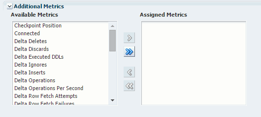

(Optional) Collapse the Expression section to expose the next sections of the page. Your conditions will remain in place. The Available Metrics section will now be at the top of the screen:
Under Additional Metrics, select one or more of the metrics that you want to apply to this alert, and then move them to the Assigned Metrics panel. To move one metric, select the name and then click the single arrow. To move more than one metric, select them by using your operating system's standard selection methods, and then click the single arrow. To move all metrics at once, click the double arrows. You do not need to select anything in the Available Metrics list.
The value of the additional metric will be its current value at the moment that the alert triggers. For example, if you are configuring this alert for Lag in a Capture Object Type, you could also include the Total Row Fetch Attempts and Total Row Fetch Failures attributes to indicate whether excessive fetching is causing the lag. You could also include the Checkpoint Position metric to see where Capture last created a checkpoint in the transaction log. See About the Metrics.

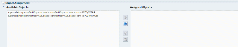

(Optional) Collapse the Additional Metrics section to expose the next sections of the page. Your object assignments will remain in place. The next section is the Object Assignment section:
Under Object Assignment, select the names from Available Objects and then move them to Assigned Objects. To move one object, select it and then click the single arrow. To move more than one object, select them using the standard selection methods of the operating system, and then click the single arrow. To move all objects at once, use the double arrows (or just select Assign to all objects of this object type).
The Monitor Server applies instance-level security in alerts. The objects used in creating the alert definition are restricted. Only, the list of objects from every instance for which a user has access to is available and displayed in the New Alert Definition screen.
Instance Level Security for alerts for object types as views is not supported.The naming convention for the display of available objects is the username prefixed with the full path of the object.
The Monitor Server applies two levels of filtration before it renders the objects on the UI:
The objects are filtered by the logged in user level by checking the list of instances the user has access to. For the current logged in user, all the accessible objects are available and rendered in alert definition screen.
The filtration happens by checking if the other users from the Monitor Server have access to the objects filtered in level 1 or not. For the other users in the system, only the objects that are accessible by the current user and accessible by other users are rendered in alert definition screen.
The following naming convention are used in displaying the available objects:
Username:fully_qualified_object_name
Example:
superuser:system/abc.host.com/abc.host.com-6890/PUMP12
