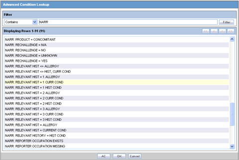

  1. Select New or None from the drop-down list and click the AC button to create a new advanced condition.
  2. Click the lookup icon to filter for existing advanced conditions.
  3. Execute the steps below to filter for existing Advanced Conditions:
  4. Click Lookup in the Case Search Criteria section. The Advanced Conditions Lookup dialog is displayed.
    Surrounding text describes acl.png.
  5. Select one of the following options from the drop-down list under Filter.
    • Contains - Enables you to filter for advanced conditions that contain the entered criteria.
    • Starts With - Enables you to filter for all advanced conditions that start with the entered criteria.
  6. Enter the search criteria for the advanced conditions in the text box, as applicable.
  7. Click Filter.
    The advanced conditions matching the specified filtering criteria are displayed.
  8. Select an advanced condition from the list, as per your search requirements.
  9. Execute any of the actions below, as applicable:
    • Click OK. The selected advanced condition is listed in the Advanced Condition drop-down list.
    • Click AC. The details of the selected advanced condition are displayed in the Advanced Conditions dialog.
    • Click Cancel. The Advanced Condition Lookup dialog is closed without saving any changes.
    • Select a previously selected advanced condition from the drop-down list to apply the search criteria for that condition.

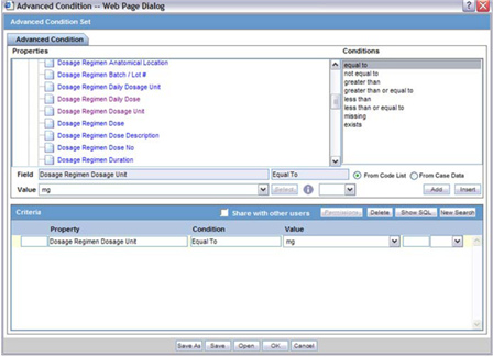

7.1.3 Creating Advanced Conditions
Use the following procedure to create advanced conditions.
  1. Select New from the Advanced Conditions drop-down list or click the Advanced Conditions icon
  2. This displays a confirmation dialog.
    Surrounding text describes ac-d.png.
  3. Select whether you wish to create a query set by using previous advanced condition query sets or by creating one through logical operators.
    • Click Yes to create a new advanced condition query set.
    • Click No to create a new advanced condition by associating logical operators (like AND, OR) with items from the Case Form.
  4. If you select No, an Advanced Condition Set dialog is displayed.
    Surrounding text describes ac-ds.png.
    The Advanced Condition Set dialog enables you to search for those entities under the Properties tree-list, which are from either the case data or from the code list. For this, the dialog provides two radio buttons - From Code List and From Case Data.
    • Select the relevant entity and one of the radio buttons, as applicable.
    • This searches the entity based from the code list or case data, as specified.
    • The radio buttons are displayed only if the selected entity belongs to a code list.
    • If the selected entity is part of the code list, and the user selects:
      • From Code List - If this option is selected, the Value drop-down list displays the list of all values configured in the Code List.
      • From Case Data - If this option is selected, the Value drop-down list displays the list of only those values, which are actually present in the cases.
  5. Select a property type from the Properties tree list.
    The items available under the folders in the Properties list represent those fields on the Case Form that can be used to perform the search in the advanced conditions.
    When a Property for which terms can be encoded is selected, the Select button is enabled. You can use the MedDRA Browser to select (possibly) multiple terms for the property.
    An SMQ icon is enabled when the SMQ-related properties are selected from the Properties tree-list. Click this icon to view the SMQ Info dialog. The SMQ Info dialog contains details about the selected SMQ.
  6. In the Conditions list, select a condition that must apply to the item selected above.
    The available conditions are "equal to", "contains", "less than", "greater than", "not equal to", "missing", "greater than or equal to", "less than or equal to", "exists", "does not contain" or "begins with".
  7. Under Value, enter the value which will apply to the property, or select an appropriate value from the list, as applicable.
  8. If the condition created in steps 4 through 6 above is to be linked with another condition, select the appropriate logical operator in the list adjoining Value.
    Tip:
    The logical operators that can be used to link the existing condition to a new condition are AND/OR.
  9. Click Add to add the newly created condition to the advanced condition.
  10. Repeat steps 3 through 7 to add more conditions to the advanced condition.
  11. When each of the required conditions for the advanced condition is entered, click Save.
  12. Enter a name for the advanced condition and click OK.

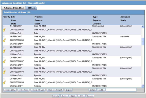

7.1.5 The Hit List Tab
The Hit List tab in the Advanced Condition Set dialog can be used to search for cases that match the query set criteria.
Surrounding text describes hitlist.png.
  1. Click Find Now in the Hit List tab of the Advance Conditions dialog.
    This runs a search based on the selected query set criteria and displays a list of cases (if any) that satisfy the advanced condition query set.
  2. Perform these operations to do the following:
To... Click...
Manually add an existing case to the hit list Add and enter the Case ID
Remove a case from the hit list Remove
Save the hit list result for future use Store Hit List
Retrieve results of the saved hit list Retrieve Hit List
Save the hit list as a text file Export
View SQL for Query Show SQL
Run a Query Find Now
