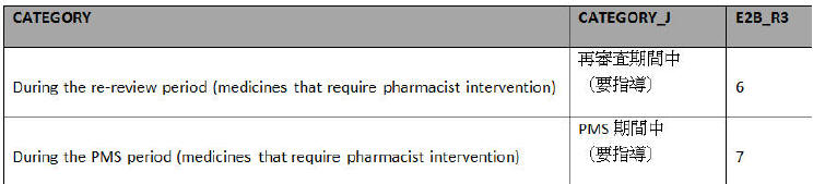

License Category
Data for the License category codelist has been synchronized as per the PMDA E2B (R3) regulation. The E2B (R2) codes have been mapped to the appropriate values with the following exceptions:
Surrounding text describes j1.jpg.
Update the appropriate E2B (R2) codes for the newly added items to the codelist.

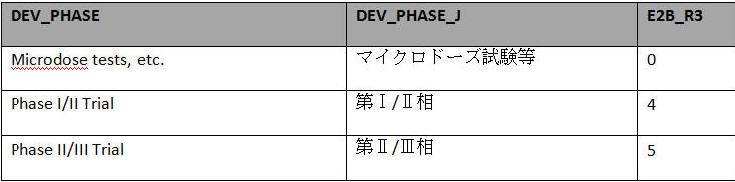

Study Development Phase (Development Phase)
Data for Study Development Phase codelist has been synchronized as per the PMDA E2B (R3) regulation. The E2B (R2) codes have been mapped to the appropriate values with the following exceptions:
Surrounding text describes j2.jpg.
