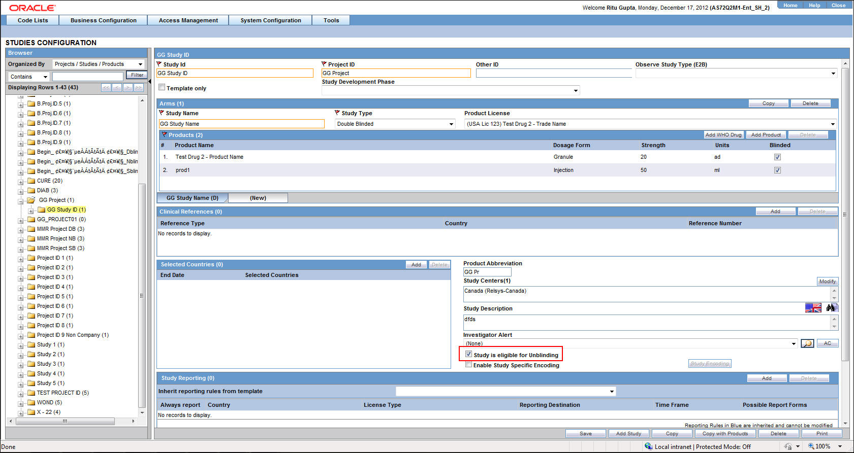

The value for some of the table columns in Argus Mart is dependent upon the selection of Business Configuration > Studies Configuration > Study is eligible for Unblinding checkbox, in Argus Safety.
If the this checkbox is selected, the actual values for all the blinded columns is displayed in Argus Mart tables.
However, if this checkbox is not selected, the actual values for all the blinded columns are replaced by NULL, Blinded, or any other value in the Argus Mart tables.
