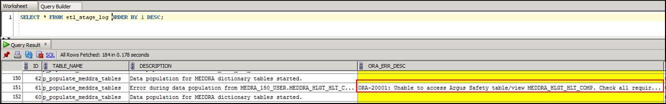

15.1 Dictionary Reload Error
Error Message
The following error message is displayed during the ETL process, whenever the dictionary is reloaded in Argus Safety:
Figure 15-1 Dictionary Reload Error Message
Surrounding text describes Figure 15-1 .
You can also view this error message by logging on to the SQL Developer as the AM_MART_USER, as shown in the following figure:
Figure 15-2 Dictionary Reload Error Message: SQL Developer
Surrounding text describes Figure 15-2 .
Cause of Error
Whenever there is a dictionary reload in Argus Safety, some of the required privileges for the Argus Safety user, which you created, using the Schema Creation Tool during the Installation Process, are lost.
Resolution
You must give the required privileges to the Argus Safety user. To do so, click the Argus User Creation link on the Schema Creation Tool, select the user that you created during the installation process in the Argus Safety User Creation dialog box, enter the name of the log file and click OK to give the required privileges to the user.
You can refer to Section 3.5.1, Creating User for the Argus Safety Database, for more information.

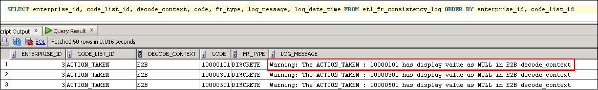

15.3 FR Consistency Log Error
Error Message
You can run the following query using the SQL developer to view the Flexible Re-categorization (FR) Consistency warning message:
SELECT enterprise_id, code_list_id, decode_context, code, fr_type, log_message, log_date_time FROM etl_fr_consistency_log ORDER BY enterprise_id, code_list_id
The following is the error message:
Figure 15-4 FR Consistency Error
Surrounding text describes Figure 15-4 .
Cause of Error
The display value for a codelist is NULL in the rm_code_list_detail_discrete table in Argus Safety.
Resolution
You must update the value for the codelist in the rm_code_list_detail_discrete table in Argus Safety and re-run the ETL.

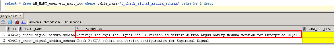

15.4 MedDRA Mismatch Error
Error Message
You can run the following query using the SQL developer to view the MedDRA mismatch warning message in the etl_mart_log table:
SELECT * FROM am_mart_user.etl_mart_log WHERE table_name = 'p_check_signal_meddra_schema' ORDER BY 1 DESC;
Figure 15-5 MedDRA Mismatch Error
Surrounding text describes Figure 15-5 .
Cause of Error
During the ETL process, a check is done between the Argus Safety and the Argus Mart database to ensure that they are using the same MedDRA version. This warning message is displayed when these values do not match.
Resolution
You must update the value for the MedDRA version in the SIGNAL_MEDDRA_VER table to ensure that it matches with the Argus Safety database value.
