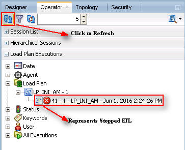

To verify the status of the ETL process, navigating to the Load Plan Executions section and expand the Load Plan folder. The status of the Load Plan appears in Red color with the X symbol, which signifies that the ETL session is not in progress.
You must verify in Argus Mart database if the ETL session has been successfully ended after this step.Restarting the Initial ETL process enables you to start the ETL process from the last execution step where it was stopped or failed.

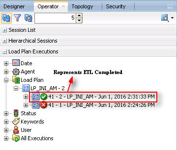

Another Load Plan is added with the same name as that of the stopped ETL, in the Load Plan folder. However, this instance of the ETL Process appears in Green color, which signifies that the ETL is in progress.
Once the ETL process is complete, the Load Plan is appear in Green color with a check mark.

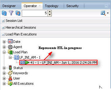

To monitor the progress of the Initial ETL after executing the LP_INI_AM Load Plan, execute the following steps:
Select the Operator tab, in the Load Plan Executions section expand the Load Plan folder.
Expand the LP_INI_AM load plan to view the ETL process in progress.
The status of the Load Plan appears in Green color, which signifies that the process is running properly.

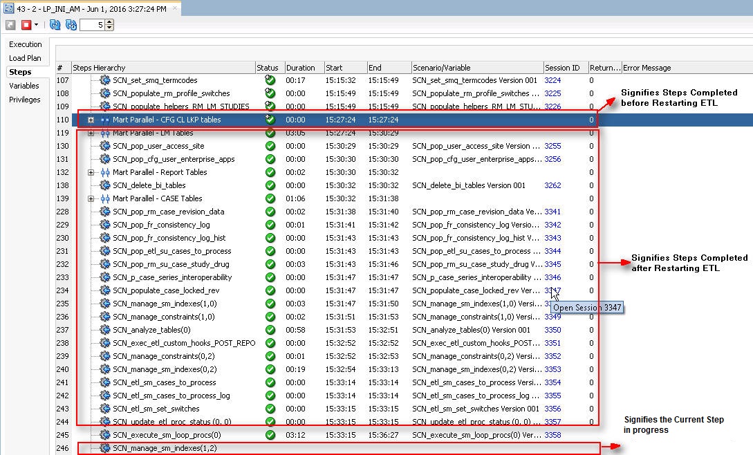

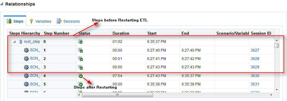

Double-click the ETL session, highlighted in the figure above, and select Steps in the right pane.
The list of steps for the Load Plan appears along with the steps that have been completed successfully. The green check mark represents the successful completion of the step.

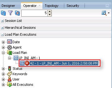

To view the step where the ETL process failed and also the error message related to the ETL process failure, execute the following steps:
In the Operator tab > Load Plan Executions section, expand the Load Plan folder to view the current status of the ETL process.
Double-click the Load Plan, and select Steps.
The list of steps for the Load Plan appears in the right pane. The step because of which the ETL process has failed, is highlighted in Red color with the X symbol.
Hover over the cursor over the error message to view the complete message.
For more information about the error message, click Execute.

The status of the restarted ETL process appears in Green color, which signifies that the ETL is in progress again.

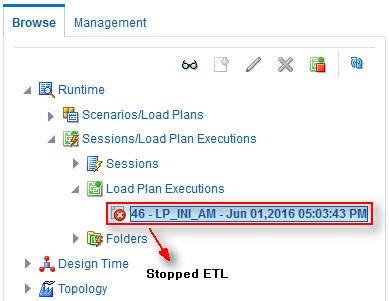

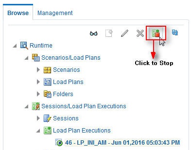

To verify the status of the ETL process, in the Sessions/Load Plan Executions section, expand the Load Plan Executions folder. The status of the Load Plan appears in green color with tilted S, which signifies that the ETL session is in progress.
In the Sessions/Load Plan Executions section > Load Plan Executions folder, select the Load Plan, which you want to stop, and click Stop.
The Stop Load Plan Execution dialog box appears.
From the Stop Type drop-down list, select Normal.
From the Physical Agent drop-down list, select OracleDIAgent.
Click Stop.
The Information dialog box appears with confirmation message — Load Plan was Stopped Successfully.
Click OK.
To verify the status of the ETL process, navigate to Sessions/Load Plan Executions section > Load Plan Executions folder. The status of the Load Plan appears in red color with the X symbol, which signifies that the ETL session is not in progress.

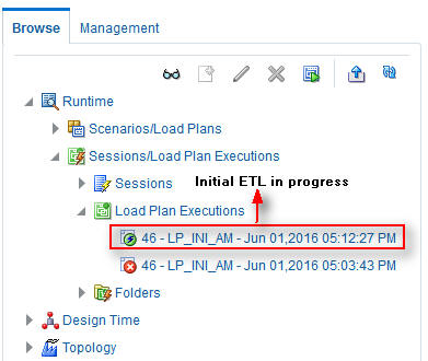

To monitor the progress of the initial ETL after executing the LP_INI_AM Load Plan, execute the following steps:
Select the Browse tab, and navigate to Runtime > Sessions/Load Plan Executions > Load Plan Executions.
A tilted S in green color appears, which signifies that the ETL process is running properly.

To view the error message, log on to the Oracle SQL Developer using the Argus ETL user credentials, and execute either or both of the following queries:
SELECT * FROM etl_stage_log ORDER BY id DESC;
SELECT * FROM etl_mart_log ORDER BY id DESC;

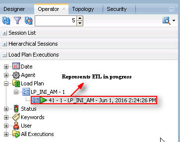

Once you have restarted a stopped ETL process, you can view the status of the process using the following steps:
In the Browse tab, navigate to Runtime > Sessions/Load Plan Executions > Load Plan Executions section.
The status of the restarted ETL process appears in green color, which signifies that the ETL is in progress again.
To view the status of the steps completed before restarting the ETL, and the steps after restarting the ETL, double-clicking the session in progress.
The steps appears in the Relationship section in the right pane.
