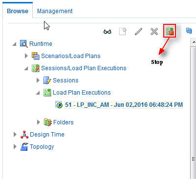

13.3.2 Stop the Incremental ETL
  1. Select the Load Plan, which you want to stop, by expanding the Load Plan Executions folder of the Sessions/Load Plan Executions section and click Stop.
    Surrounding text describes sc_029_2.jpg.
  2. In the Stop Load Plan Execution dialog box, from the Stop Type drop-down list, select Normal.
  3. Select OracleDIAgent from the Physical Agent drop-down list.
  4. Click Stop.
    The Information dialog box appears with the Load Plan was Stopped Successfully confirmation message.
  5. Click OK.
    You can verify the status of the ETL process by navigating to the Load Plan Executions folder in the Sessions/Load Plan Executions section. You can view the status of the Load Plan in Red color with the X symbol, which signifies that the ETL session is not in progress.

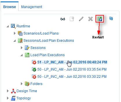

13.3.3 Restart the Incremental ETL
Restarting the Incremental ETL process enables you to start the ETL process from the last execution step where it was stopped or failed.
  1. Select the Load Plan, which you want to restart, in the Load Plan Executions folder of the Sessions/Load Plan Executions section and click Restart.
    Surrounding text describes sc_035.jpg.
  2. In the Restart Load Plan Execution dialog box, from the Physical Agent drop-down list., select OracleDIAgent.
  3. Select the required log level from the Log Level drop-down list.
  4. Click Restart. This displays the Information dialog box with the Load Plan restarted message.
  5. Click OK.
    This adds another Load Plan, with the same name as that of the stopped ETL, in the Load Plan Executions folder of the Sessions/Load Plan Executions section. However, this instance of the Load plan is in Green color, which signifies that the ETL is in progress.
