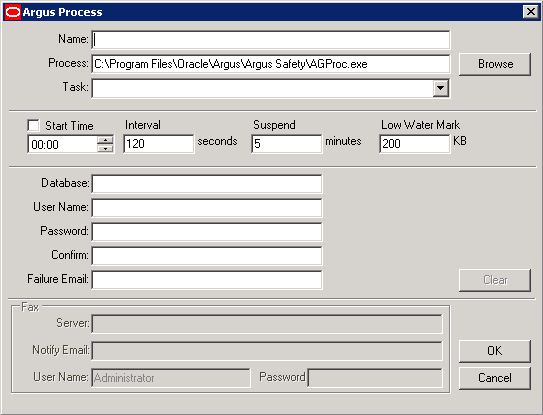

2.1.1 Add an Argus Process
Use the following procedure to add an Argus Safety Service Process.
  1. Double-click Add Argus Process to open the Argus Process dialog box.
    Surrounding text describes argsprocess.gif.
  2. Fill in the process details to create your Argus Process. See Understanding the User Interface.
    Specify a Failure Email address. If a process fails, the system sends an email notifying the person whose mailing address is specified.
  3. Click OK to save the configuration to the process.
    Restart the Argus Safety Service after adding the AG Service.

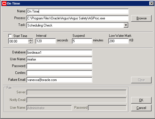

2.1.2 Modify an Existing Process
Use the following procedure to modify an existing Argus Safety Service Process.
  1. Launch the Argus Safety Service Configuration application from Start>Programs>Oracle>Argus Safety Service Configuration.
  2. The Argus Safety Service dialog displays.
    Surrounding text describes argssdlg3.gif.
  3. Right-click the process and select Properties to view the Argus Processes dialog.
  4. Modify the process details. See Understanding the User Interface.
    Surrounding text describes modifyprocess.gif.
  5. Click OK to save your changes to the process.

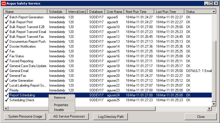

2.1.3 Enable or Disable a Process
Use the following procedure to enable or disable an Argus Safety Service Process.
  3. Right-click any process to Enable or Disable it.
    Disabling a process prevents Argus Safety Service from running that process when the service is restarted.
    A disabled process is depicted by a red icon before the Process Name.
2.1.4 Remove a Process
Use the following procedure to remove an Argus Safety Service Process.
  3. Right-click any process and select Remove.

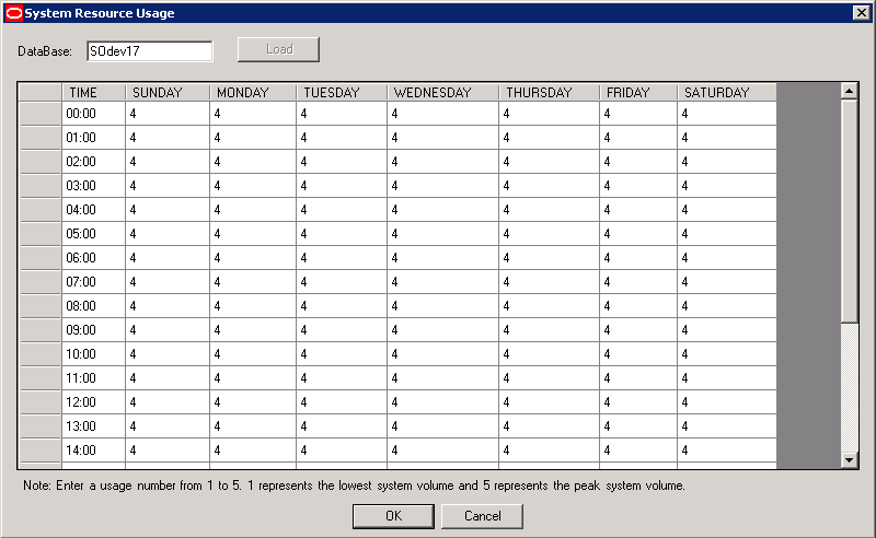

2.1.5 System Resource Usage
  • Enter a valid Database name and click Load for the current settings to be displayed.
    Surrounding text describes sysresourceusage.gif.
  • If an invalid database name is entered you will receive this error message: "Database name not valid, please enter a valid database name."
  • Enter a number between 1 and 5.
    1 represents the lowest system usage.
    5 represents peak system usage.
    The default value for system usage is 4.
    Some of the Argus Safety Service processes perform multi-thread processing, based on the value of this parameter. For example:
    Audit Log Update
    Batch Report Generation to attach Expedited Reports
  • Click OK or Cancel.

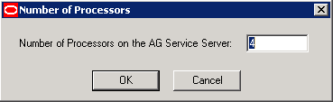

2.1.6 Argus Safety Service Processors
  1. Click Argus Safety Service Processors.
  2. Enter the number of processors you want to run Argus Safety Service processes on your server.
    Surrounding text describes numberofproc.gif.
      Audit Log Update
    • Once set, subsequent visits to this screen displays the entered number of processors.
  3. Click OK or Cancel.

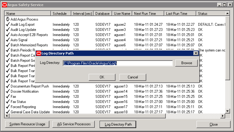

2.1.7 Log File
In case of multi-tenant installations, Argus Safety Service log file identifies all the log items which are related to processing of data specific to a particular enterprise by specifying Enterprise Short Name in the log record. The generic log records which are not related to any enterprise specific data will not append Enterprise Short Name.
2.1.7.1 Specify Log Directory
Use the following procedure to specify the Log Directory Path.
  3. Click Log Directory Path. The Log Directory Path dialog displays.
    Surrounding text describes logdirectorypath.gif.
  4. Click Browse or enter a path.
  5. Click OK to save your entry.
