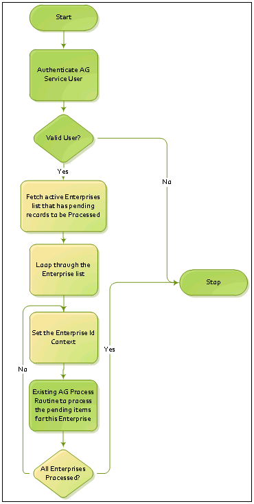

1.1 Argus Safety Service in a Multi-tenant environment
Each Argus Safety Service processes the data for all enterprises. It does not need to be segregated by enterprises as it is not meant for the end users and is maintained by the CRO Administrator or Hosting provider. Surrounding text describes agmt.gif.
While performing any single task at a time, Argus Safety service will not inter-mix data from multiple enterprises.
The user configured to run any Argus Safety Service task must belong to all enterprises as these tasks have to process records for all the enterprises.

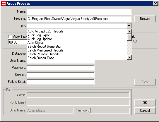

You can create Argus Safety processes configure existing processes from the Argus Process dialog box. Surrounding text describes argsprocess.gif.
1.2.1 Argus Process Dialog Box Fields and Field Descriptions
Item Description
Name Enter the name of the Argus Safety Process.
Process Browse to the Argus Safety Service Installation folder and select the AGProc.exe file.
Task Select the task to run that is associated with the Name entered in the first field.
Start Time Enter the Initial Start Time for the Process. After the initial starting, the process will follow the Interval set in the next field. If Start Time is not selected, the process will begin immediately after starting the service.
Interval Enter the frequency at which the process will be executed.
Suspend If a process is running for a period that is longer than what is specified in this field and the memory consumption of the process is below the Low Water Mark specified in the next field, then the process will be terminated.
Default for 5 Minutes is the ideal setting and should not be changed.
Low Water Mark The Low Water Mark setting works with the Suspend field above. The Default setting of 200 is ideal and should not be changed.
Database Enter the database name.
User Name Enter in the Argus Safety Service User name that the process will connect to the system as. These users should be configured before using this utility. Each Process requires its own user configured to run.
Password Enter the password that has been configured for the user entered above.
Confirm Re-enter the password that has been configured for the user.
Failure Email If a process fails, an email is sent to the address specified in this field.
Fax
(Note: This section is enabled only if Fax or Fax Status is selected in the Task list)
Server Enter the Fax Server name that the Fax Process will be using to submit faxes with. This field will only be enabled if the Task selected is either FAX or FAX STATUS.
Notify Email Enter the Email Address of the Administrator that will receive the email in the event that Argus Safety Service cannot access the Fax Server.
User Name Enter in User name that the fax will connect to the system as.
