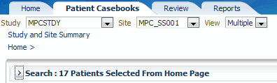

The Patient Casebooks page opens and displays the selected patients in the Casebook Spreadsheet. Note that:
The Search pane is collapsed, and the title in the Search pane indicates the number of patients you selected from the Home page. For example:
The breadcrumb displays Home > to indicate your navigation path to the Patient Casebooks page.

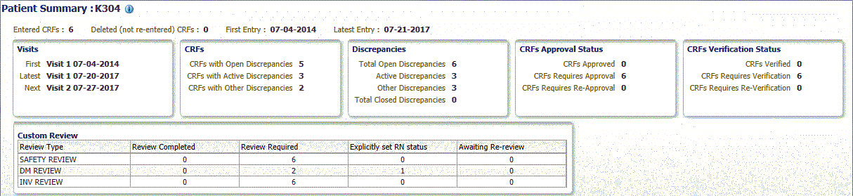

The Patient Summary displays up-to-date metrics for the current patient selected.
This includes the following information for the selected patient:
Patient Information — At the top, displays the patient number, entered and deleted CRF's, and the dates of the first and latest entry.
Visits — Displays the time and date of the patient's past and upcoming visits.
CRFs — Lists the number of CRFs with open discrepancies, with active discrepancies, and with other discrepancies.
Discrepancies — Lists the number of discrepancies by discrepancy status.
CRFs Approval Status — Lists the number of CRFs with the following approval statuses: approved, requires approval, and requires re-approval.
CRFs Verification Status — Lists the number of CRFs with the following verification statuses: verified, requires verification, and requires re-verification.
The Verification Status metrics are visible only to users with BROWSE_VERIFY privileges or higher.Links — Lists up to three custom links that open other Web pages and provide additional information on the patient. These links are available only if your sponsor customized the Patient Summary Report to include the links. For example, your sponsor may include a link to the Adverse Events for the patient.
Custom Review — If your sponsor has defined one or more custom review types, and your account has the appropriate privileges, lists the number of CRFs in each review status for all your assigned custom review types.

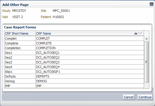

If allowed in your installation, you can also add pages, either for an unplanned visit or other.

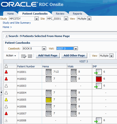

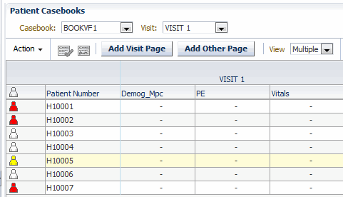

The Patient Casebooks tab displays by default the multiple patient view where you see a single visit for several patients. The Search pane is collapsed if you came from the Home page with a patient selection in effect. Otherwise, if you selected the Patient Casebooks tab, the Search panel is displayed to allow you to search for patients.
Description of the illustration ''pat_case_mpc.gif''
If a patient has not been assigned to a casebook (only possible in non-flexible studies), you can select a casebook to use for data entry for such a patient. If all patients are assigned to a casebook, changing the casebook may simply change the ordering of the CRF columns.
You can also change the visit in focus and toggle to the single patient view. Please note that the Single View always displays the first patient in the Multiple View list. You can then navigate through each of the patients in turn.
The Patient Casebooks page in the default multiple patient view displays the patients in rows and the expected, visit-related CRFs in columns.
You can scroll up and down the list to view more patients; you can scroll across (left to right) to view more CRFs within the selected visit.
When working with the Patient Casebooks in Multiple view, the Casebook, Visit Set for patient, and Visit fields work differently, depending upon whether you are working in a flexible or non-flexible study. The Visit Set for patient field does not appear for non-Flex studies.

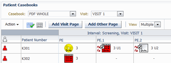

CRF icons appear on the Patient Casebooks page and all Review pages. See Appendix A, "Description of the CRF Icons" for a detailed description of each icon. Clicking a CRF icon opens the Data Entry window, where you can view and edit the CRF.
| Empty CRF — The Patient Casebooks page is the only page in RDC Onsite that displays the Entry Expected icon (square with a green arrow). This icon indicates that the CRF is empty and you are expected to fill in the data. Click the icon to open the CRF in a Data Entry window and begin to enter patient data. | |
| Entered CRF — An entered CRF contains data and is reflected in all pages. Click an entered CRF icon from the Patient Casebook spreadsheet or any Review page to open it in a Data Entry window and update data. |

Figure 3-2 Patient Casebooks Page Indicating Changes in Expected CRFs and Visits

When you open a Data Entry window from a surround page, for example a Patient Casebook or CRF Review page, you can use the Previous CRF link and the Next CRF link to navigate from one CRF to another, without having to return to the page that you started from in order to select another CRF.
A surround page is any page in Oracle Clinical other than the Data Entry Window.
The surround pages impose a sequence on the CRFs, which doesn't change as long as you have a data entry window open. When you click one of these links, RDC Onsite navigates to the next or previous CRF in the sequence. These CRFs include planned CRFs with or without data, existing unplanned CRFs with data, and new CRFs that can become expected.
The Previous CRF and Next CRF links:
Are restricted to the CRFs within a single visit for a single patient when you open the Data Entry Window from the Multi- or Single-Patient Casebooks pages.
Are not enabled when you create an unplanned CRF from a Casebooks page. Once you close and reopen the saved CRF, the links are active.
Are not enabled if you are viewing the first CRF (Previous CRF not active) or the last CRF (Next CRF not active).
May be disabled when you save a CRF if the casebook is re-assigned for the patient while you had the CRF open in the Data Entry window.

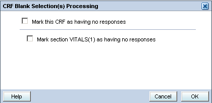

Blank Flag Tool |
Open the CRF Blank Selection(s) Processing dialog box. |

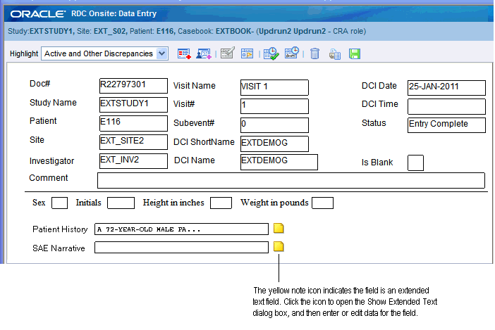

When you open a CRF in the Data Entry window, RDC Onsite indicates an extended text field by displaying a yellow note icon to the right of the field. See Figure 3-4.
RDC Onsite always displays the Extended Text icon regardless of whether the field has any data. Once the field has data, the Data Entry window displays the beginning of your extended text followed by the ellipsis (…) character.
To view all the data associated with an extended text field, click the Extended Text icon (that is, the yellow note) to open the Show Extended Text dialog box. Alternatively, you can double-click in the field or use the right-click menu to open the Show Extended Text dialog box.
You can use double-click or right-click on all supported devices except for iPad.In the Audit History pane, the Discrepancies Details pane, and the Patient Data Reports, RDC Onsite uses the following prefix to indicate that the value is an extended text value:
ATTACHMENT V <X.Y>:
where X is the version number and Y is the sub-version number. The system increments these numbers each time the data in an extended text field is saved.
After the ATTACHMENT prefix, RDC Onsite adds the beginning of your extended text followed by the ellipsis (…) character. For example:
ATTACHMENT V<1.1>: A 21-year-old woman presented…

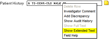

In an extended text field, you can enter lengthy comments and narratives, such as patient case history or serious adverse events.
Before you can enter or update data for an extended text field, you must open the Show Extended Text dialog box. You cannot make changes directly in an extended text field in the Data Entry window.
To open the Show Extended Text dialog box, you can:
Click the Extended Text icon next to the field.
Double-click the extended text field.
Right-click the extended text field and select Show Extended Text from the menu.
You can use double-click or right-click on all supported devices except for iPad.To view or enter data in an extended text field:

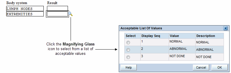

When defining the study database protocol, the sponsor specifies a list of acceptable values for some fields.
To select a value from a pre-defined list:
Click any header or response field. If a list of values has been defined for the selected field, a magnifying glass icon appears.
Click the Magnifying Glass icon to open a dialog box and view the list of possible values for the field. Alternatively, you can press Alt+L.
Select a value from the list. Use the scroll bar to scroll through the list if necessary. You can also press the up and down arrow keys on the keyboard.
Click OK. RDC Onsite inserts your selected value into the field. (The selected value may appear abbreviated in the field.)

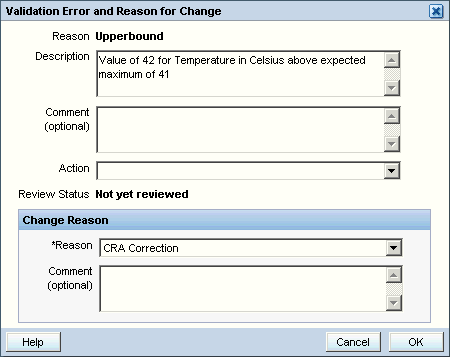

Your sponsor defines rules your data entries must meet. For example, you cannot enter a numeral in a field defined as requiring characters. Or, you cannot enter characters in a defined date field that requires numerals. If you enter data that conflicts with defined validation rules, RDC Onsite alerts you accordingly with a Validation Error dialog box.
To process a Validation Error, check that your entered data matches the source data and:
Enter an explanatory comment if you want.
Click OK if the entered data is correct. The Validation Error dialog box closes. You can resume data entry.
Click Cancel if the entered data is incorrect or you want to navigate back to the response field. The Validation Error dialog box closes. RDC Onsite returns the previously saved values to the response field that generated the error.

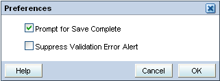

Your configuration may suppress the Validation Error dialog box from appearing during data entry or update. In that case, you must deal with discrepancies later.If the Highlight field in the toolbar is set to Active Discrepancies or Active and Other Discrepancies, you see discrepant responses highlighted in red. See Chapter 4, "Managing Discrepancies" for more information routing and resolving discrepancies.

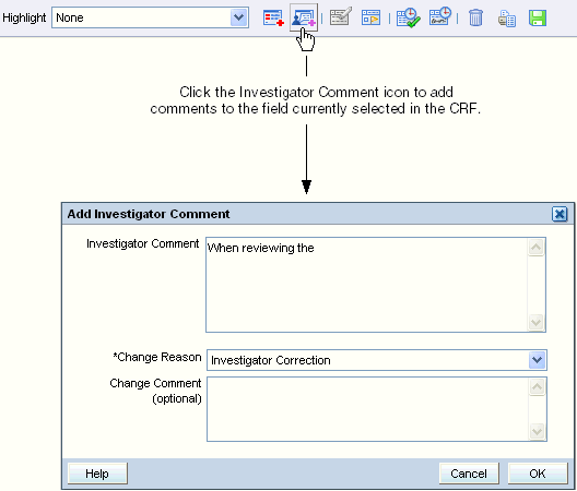

When you are entering or updating the patient data in a CRF, you may want to add an investigator comment to the response.
You can add and update investigator comments from the Data Entry window only. In addition, you can perform these actions only if you have update privileges and if your sponsor has configured RDC Onsite to allow it.
The process to add or update an investigator comment is similar. When you create an investigator comment, RDC Onsite displays an Add Investigator Comment dialog box. If you reopen a saved investigator comment, RDC Onsite displays an Update Investigator Comment dialog box.
To add an investigator comment to a field in the CRF:
Open the CRF in the Data Entry window.
Position the cursor in the field you want to add the investigator comment to, and then click the Investigator Comment icon in the toolbar.
Alternatively, you can right-click a field in the CRF, and then select Investigator Comment from the menu.
Add text in the Investigator Comment field.
Click the Change Reason field, and then select an explanation for this change from the list. Note that:

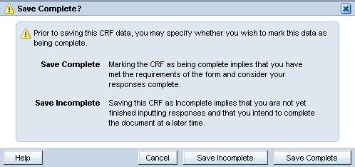

If the CRF status is Saved Complete, and you add an investigator comment, you may or may not need to provide a change reason as configured by your sponsor.
If the CRF status is Saved Incomplete, you are not required to specify a change reason when you add or update an investigator comment.
If you modify a previously saved investigator comment, you must enter a change reason.
Click the Change Comment field if you want to provide any additional information about your changes or comments.
Click OK to save your changes and add the investigator comment.
See Chapter 5, "Reviewing Investigator Comments" for more information on reviewing investigator comments in the Data Entry window and on working with the Review Investigator Comments page.
The Data Entry window may display a Preferences link if your sponsor choose to include the link when installing the RDC Onsite application.
If the Preferences link is available, you can customize whether RDC Onsite:
Gives you a choice to save the CRF as complete or incomplete
Alerts you if a validation error occurs during data entry or update
To set your preferences for data entry:
Open the Data Entry window.
Click the Preferences link at the top of the window. The Preferences dialog box opens:
Select the appropriate check boxes to set your preferences for data entry.
If the Prompt for Save Complete check box is selected and you save a CRF, RDC Onsite prompts if you want to save the CRF as complete or incomplete.
When you save a CRF as incomplete, its status is Entry Started. By saving a CRF as incomplete, you can:
Save data without raising system-generated discrepancies.
Continue data entry in the same CRF later, without being prompted for a change reason on every field input.
If not selected, RDC Onsite does not prompt you with a choice of saving the CRF as complete or incomplete.
If the Suppress Validation Error Alert check box is not selected, RDC Onsite alerts you to possible validation errors that occur during data entry or data update. You then have the opportunity to correct the data before continuing to the next field.
If selected, RDC Onsite suppresses the error message. RDC Onsite creates a discrepancy when the validation error occurs, but does not alert you to the problem.
Click OK to confirm your choices.

When a validation error occurs during a data update, RDC Onsite displays a combination Validation Error and Reason for Change dialog box. See Figure 3-5.
This dialog box lets you acknowledge that the current value of the response field raised a discrepancy. In addition, and perhaps more importantly, you can use the dialog box to take immediate action on the discrepancy.
To respond to the validation error, select one of the following actions:
The system lists the discrepant response in the Description field of the Validation Error and Reason for Change dialog box.
To revise data in the discrepant response field:
Click Cancel. The system closes the dialog box, deletes the discrepant response value, rolls back previously entered data, if any, and returns focus to the response field.
Revise the discrepant entry.
Continue to the next field.
If you feel that the entered data is correct, complete the Validation Error and Reason for Change dialog box as follows:
Review the Error Message. Ensure it has relevant information about the data entered.
Enter a comment in the Comment text box.
Select a Change Reason from the dropdown list provided in the Reason field. RDC Onsite also allows for user-supplied change reasons.
Enter an explanatory comment in the Comment field of the Change Reason section, if you want. The OK button becomes active.
Click OK. The dialog box closes and RDC Onsite moves the cursor to the next response field.

When you initiate the save of a CRF, one of the following actions can take place:
RDC Onsite displays a Processing... message, and then displays a Saved confirmation message, indicating a successful CRF save. The CRF is always saved as Complete.
RDC Onsite displays a Save Complete? dialog box. This dialog box appears only if RDC Onsite is configured to show it. See "Changing Your Preferences for Data Entry" for information on configuring this prompt.
The Save Complete? dialog box offers you the option of saving the CRF as Save Complete or Save Incomplete. See Figure 3-6.
Click Save Complete if you met the form requirements and data entry is complete.
After you make a choice, the Save Complete? dialog box closes. The system confirms the save through a dialog box and focus returns to the CRF.
When you save complete, RDC Onsite may raise additional discrepancies. If you work with the Highlight option set to show Active, Active and Other, or All discrepancies, and you have used a Save option that does not close the CRF, newly discrepant fields are highlighted in red.
To review and address those discrepancies immediately, see "Resolving and Routing Discrepancies".
When addressing all discrepancies at a later date, see "Finding CRFs with Discrepancies".
Click Save Incomplete if data entry is incomplete, and you intend to complete the document later. Saving incomplete is possible if you at least fill in the header fields in the CRF.
When a CRF is saved incomplete, its status is Entry Started. By saving as incomplete, you can:

To use the Blank Flag icon to mark a CRF as blank:
Click the CRF or CRF section.
Click the Blank Flag icon in the Data Entry window toolbar. RDC Onsite displays the CRF Blank Selection(s) Processing dialog box.
Select the check box for how you want to mark this data.
Mark this CRF as having no responses.
Mark section section-name (number) as having no responses. The system lists each section separately.
Click OK. The CRF or the related CRF section is marked blank, associated fields are grayed out, and cannot be updated. If the marked section contains data, the data remains visible until you save the CRF, but the values cannot be modified.
Depending upon the design of the CRFs you use, select the Blank Flag check box in the CRF header or CRF section header. The Blank Flag check box option may not be available to you.
To use the Blank Flag check box to mark CRFs as blank:
Select the Blank Flag check box in either the CRF header or CRF section header. A CRF Blank Selection(s) Processing dialog box appears with these choices:
Mark entire CRF as having no responses.
Mark section n as having no responses. The system lists each section separately.
RDC Onsite grays out the CRF or the CRF section that you marked blank. If the marked section contains data, the data remains visible but cannot be modified.
If you mark a CRF or CRF section blank, and then unmark and save the CRF, the previous values appear in the CRF without being grayed out.

The Patient Casebooks page provides options for:
From the Patient Casebooks page, you can add an unplanned page to a visit using a CRF that has already been used once for the visit. The Add Visit Page button is active only if you have update privileges.
You can add an unplanned visit page when:
There is no space in the initial CRF planned for the visit, and additional information needs to be added, using the same form. In this case, RDC Onsite assigns unique sub-visit numbers to identify each of the CRF instances.
The patient makes an unscheduled visit. In this case, the sub-visit number correlates to a visit that happens after Visit X and before Visit Y. (You add the Visit pages to Visit X.) You can add Visit pages multiple times to include all the required CRFs for the unscheduled visit.
To add a visit page:
Navigate to the Patient Casebooks page.
Enter the search criteria for your patient and click Search.
Click the Visit field and select a visit number from the list.
Select the row with your patient.
Click the Add Visit Page button. The Add Visit Page dialog box opens, listing all the planned CRFs for the current visit, patient, study, and site.
Select the CRF that you want to add to the visit and then click Continue. RDC Onsite prompts you to select a sub-visit to add to the current visit.
Select the sub-visit number from the list. The new CRF is identified accordingly. For example, if the sub-visit is 1 and the CRF is PE, the new visit page is PE.1.
If you have previously added visit pages, there may be more than one choice for a sub-visit. If you are adding a page for lack of space in the first CRF, accept the default.
Otherwise, the sub-visit number may represent actual unscheduled visit numbers, and you should choose accordingly.
Click Continue to add the new page to the current visit.
Return to the Patient Casebooks page to view the new, empty CRF icon in the designated patient row and CRF column of the Casebook Spreadsheet.
Notice that a new CRF column may have been inserted, labeled with both the CRF name and the sub-visit number.
Click the newly inserted CRF icon to open the CRF in a Data Entry window.
Enter data and save the CRF.
The Add Visit Page dialog box lists the set of planned CRFs for the selected visit and patient. However, during the study design, one or more of these CRFs may have been identified as a CRF that cannot be used for unplanned use. Such CRFs do not appear in the selection list.From the Patient Casebooks page, you can add a page to a visit, using CRFs not already planned for the current visit, with the Add Other Page function. The Add Other Page button is active only if you have update privileges.
To add an Other page to a casebook:
Select the check box for your patient.
Click the Add Other Page button. The Add Other Page dialog box opens and lists the CRFs that you can add to the current visit for the selected patient. The dialog box also displays the study and site name.
Select the CRF and then click Continue.
If one or more sub-visits are already added to the visit, RDC Onsite prompts you to select a sub-visit number. Select the sub-visit number and click Continue.
RDC Onsite closes the dialog box and returns to the Patient Casebooks page. If necessary, a new CRF column is added to the spreadsheet. A new, empty CRF icon appears in the appropriate column.
RDC Onsite numbers the new CRF based on the total number of planned CRFs for the visit, and the existence of other unplanned pages. For example, if the current visit has three planned pages, and you add your first unplanned page with a CRF called AE, after the third CRF, then the system numbers it as 3 U1.
The Add Other Page dialog box lists all CRFs in the Oracle Clinical casebook definition that are checked for unplanned use. The list excludes CRFs planned for the current visit.The sponsor designs validation checks to prevent data entry errors and to streamline responses in CRFs. If you enter or update a response that does not meet specified criteria, RDC Onsite prompts you for clarification.
