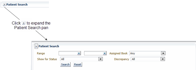

The Patient Search pane
The Patients list
By default, the Patient Search pane is collapsed. You can click the
button to expand the Patient Search pane. You can then specify criteria to search for and display a subset of patients.

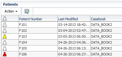

The Patients list provides:
Several ways that you can select one or more patients. See Action.
Colored icons that indicate the status of the data already entered. See Patient Icon.
Information about each patient, such as patient number, date when patient data was last modified, and the assigned casebook.
If configured for your installation, clicking the patient number opens the Single Patient Casebooks page for the patient. See Patient Number.
Options for the task you want to complete from the Action menu once you select one or more patients. See Action.
The Action menu lists the actions available to execute on the selected patients. For example, you can:
Open the casebooks for the selected patients and enter new data
Review CRFs already entered for the selected patients
Review discrepancies or investigators comments for the selected patients
Generate a Patient Data Report for the selected patients
The first two options in the Action menu are Multi-Patient View and Single Patient View. They both open the Patient Casebooks page for the patient or patients selected. Single Patient View provides a way to view a single patient's casebook CRFs across visits. See "Single Patient View", or "Multiple Patient View" for more information about these pages.
The icon column displays a patient icon that resembles a human figure. The color of the icon is significant and provides valuable information about the patient data. Table 2-1 defines the meaning of the color of each icon.
| Icon | Color | Description |
Gray with a question mark |
No data has been entered for this patient number. You can use the patient number to enter data for a new patient. |
White |
The patient data has no open discrepancies. |
Red |
The patient data has one or more active discrepancies. An active discrepancy requires attention by you or a member of your user group. |
Yellow |
The patient data has one or more other discrepancies. An other discrepancy requires attention from another user or user group. |

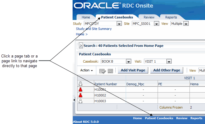

You can use the page tabs to navigate from page to page in RDC Onsite. The tabs provide direct access to a page.
Note that for convenient access, the page footer has four links that correspond to each page tab. You can click either a page tab or a page link to navigate directly to that page.
Whenever you navigate directly to a page by clicking a page tab or page link, RDC Onsite always resets the search criteria to the default values and displays the page in its default state. For example:
Whenever you click the Home tab, RDC Onsite opens the Home page, displays patient data for the current study and site, resets the search criteria to the default values, and collapses the Search pane.
When you click the Patient Casebooks tab, RDC Onsite opens the Casebooks page, displays no patient data, resets the search criteria to the default values, and expands the Search pane. You can change the criteria in the Search pane; you must click Search to retrieve and display the patient data.
Returning or navigating directly to a page is useful when you have finished a set of tasks in other parts of the application and are ready to begin another task. In addition, you may want to use tabs to navigate to the Patient Casebooks and Review pages if you either have a preference for using a particular page or make frequent use of searches.

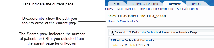

When you drill down to a page, RDC Onsite displays several visual clues, or indicators, on the page:
The tabs indicate the current page. In Figure 2-1, Review CRFs is the current page.
Breadcrumbs, which appear directly below the page tabs, show the path you took to arrive at the current page. Breadcrumbs keep track of your location within RDC Onsite and provide a path (or trail) for you to follow back to your starting point.
The greater than sign (>) separates each part of the path. You click a link to navigate back to another point in the path.
The title in the Search pane indicates the number of patients or CRFs you selected for the drill-down action.
Figure 2-1 Breadcrumb and Selection Indicator Display

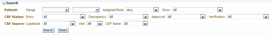

Every page in RDC Onsite provides a Search pane that helps you locate and focus on the patients, CRFs, discrepancies, and reports that you need for your work.
Although the available search criteria varies on each page, the Search pane provides you with many search options. For example, you can:
Search for patients by range or by whether any data has been entered
Search for CRFs that have discrepancies, need verification, or need approval
Search for CRFs by name or by visit
In addition, you can combine search criteria to narrow your results. For example, you can search for all CRFs that are for Visit 1 and have a name of VITALS and need to be approved. For more information, see Chapter 10, "Using Search."

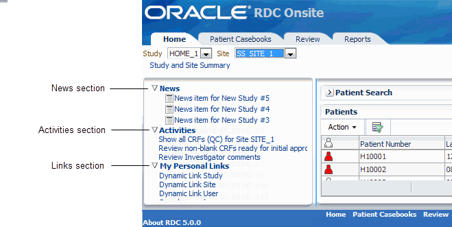

As shown in Figure 2-2, the Home page includes the following three sections that can be customized by your sponsor:
The News section
The Activities section
The Links section
These sections are located on the left side of the Home page.
Figure 2-2 News, Activities, and Links Sections on the Home Page
To customize your use of the News, Activities, and Links sections, you can:
Click the Preferences link in the page header to define how many items to display in the News, Activities, and Links sections at a time. The default is 20 items per section.
Click the section title to sort the list in ascending order. Click the title again to sort in descending order.

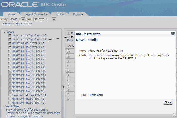

Your sponsor publishes important information you need to know in the News section on the Home page. See Figure 2-3.
Figure 2-3 Reading the Daily News on the Home Page
News items can be about any topic, including:
Notices of group meetings, training classes, or other events
Changes to the study protocol or procedures
Progress reports
Upgrades to the RDC Onsite application
News may be specific to your site and your role. Each time you log in, scan the News section for newly listed items, and ensure you are up-to-date with the latest information specific to your study and site.
When you click a News item, RDC Onsite displays the news headline and text in the News Details window.
In addition, your sponsor can include a link that lets you get more information. For example, suppose a News item announces an updated terminology list. When creating the News item, your sponsor can include a link to the terminology Web site. When you click the link, RDC Onsite displays the information in a new browser window.
Tip:
To avoid cluttering your display, close each window as you finish reading the news.Your sponsor can customize tasks to suit your role and then display these tasks as links in the Activities section of the Home page. These links are a shortcut to your most common tasks.
Your list of activities may be different from another system user. Your sponsor can define activities for a user role, a set of users, or all roles.
In addition, RDC Onsite includes a default set of activities that your sponsor may or may not include. Your sponsor can add other activities as well. Contact your Help Desk for questions about the links in your Activities section.
Clicking an Activities link on the Home page lets you navigate directly to the Review pages of the application with a built-in set of search criteria, rather than with a selected set of patients. RDC Onsite opens the appropriate page and displays the data defined by the customized search.
When you navigate using Activities, the target page opens with the Search pane collapsed, and the name of the activity displayed on the pane. Note that RDC Onsite displays the Home > breadcrumb at the upper left of the page.
If you click an Activities link, RDC Onsite displays the appropriate page with the data automatically filtered for you. For example, if you click the Review Active Discrepancies link, RDC Onsite automatically opens the Review Discrepancies page and displays only those discrepancies that require your action.
RDC Onsite includes the following default links in the Activities section.
To open the Review CRFs page and list the CRFs ready for verification, click Review Non-blank CRFs ready for Initial Verification. This link is displayed only if you have CRA privileges.
To open the Review CRFs page and list the CRFs ready for approval, click Review Non-blank CRFs ready for Initial Approval. This link is displayed only if you have investigator privileges.
To open the Review Discrepancies page and list all discrepancies that require action by you or your user group, click Show Active Discrepancies.
To open the Review Discrepancies page and list all discrepancies that require action by other users or groups, click Show Other Discrepancies.
In case you have a custom review type privilege, you also see displayed:
Review non-blank CRFs ready for your_review_type
Set your_review_type requirement for new CRFs
Your sponsor may have created different activities, so you can have a different default view. For more information, see Oracle Clinical Remote Data Capture Onsite Administrator's Guide.
Your sponsor lists relevant Web addresses in the Links section on the Home page. For example, your sponsor may include a link to the National Institute of Health, to the Oracle Thesaurus Management System for standard terminology, or to a medical dictionary.
When you click a link, RDC Onsite displays the associated Web site in a separate browser window.
You can click a patient icon to view and print the latest overall metrics for that patient. The report includes the following information:
General (birth date, gender, age, site, last update)
Number of active, other, and closed discrepancies
Number of CRFs with active, other, or no open discrepancies
CRF Verification, Approval and Custom Review status, depending on your privileges
Dates of visits
Links to other information such as adverse events
See Chapter 11, "Viewing Summary Reports" for more information on the Patient Summary Report.
