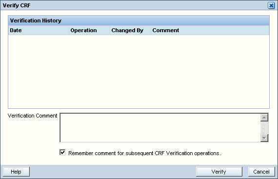

Before you verify a CRF, RDC Onsite lets you view the CRF's verification history, if any. A CRF that has never been verified does not have a verification history.
To view the verification history of a CRF:
Open the CRF in a Data Entry window.
Click the Verify icon in the toolbar. The Verify CRF dialog box displays the following information about the verification history, if any, for the CRF.
Date — Displays the date and time of the entry in the Verification History table.
Operation — Displays the action that caused a change in verification status: Verify or Undo Verify.
Changed By — Displays the full name of the user who changed the verification status.
Comment — Displays additional information about the Verify or Undo Verify action.
Close the Verify CRF dialog box.

You can verify a CRF only if you have verify privileges and the CRF does not have a status of Received or Entry Started.To verify a CRF:
Open a CRF in a Data Entry window.
Click the Verify icon in the toolbar to open the Verify CRF dialog box.
The Verify CRF dialog box includes the verification history of the CRF, if any.
The verification actions available in the Verify CRF dialog box depends on the current status of the CRF. Based on the status of the CRF, you can:
Click Verify to verify the CRF.
Click UnVerify to undo the verification if the CRF was already verified.
Click Re-Verify to redo the verification of a CRF. A CRF needs to be re-verified if data is updated or added since the last verification.
Save your changes.
See "Reviewing Verification History" if you want to review the verification changes to the CRF.

Use the Has deleted, not re-entered CRFs search filter on the Home page or the Multi-Patient Casebooks page to identify all patients with such CRFs. Once identified by the search, you can generate the Audit History Report, Patient Data Report, or Deleted CRFs Report for these patients to view the details of these CRFs.
