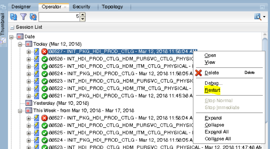

If the execution fails at the first interface, that is, INIT_PKG_HDI_PROD_CTLG in the below example, restart the failed package.

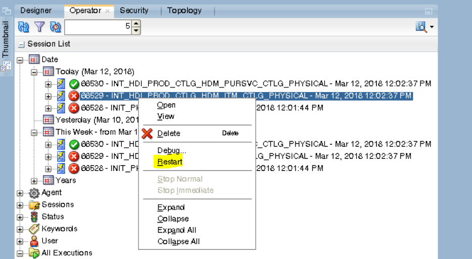

If the execution fails at a child interface, that is, INT_HDI_PROD_CTLG_HDM_ITM_CTLG or INT_HDI_PROD_CTLG_HDM_PURSVC_CTLG in the above example:
  1. Restart the failed scenarios associated with that package.

    When a package has multiple interfaces, and if any of the scenario associated with the respective interfaces fails, perform the above steps for each failed scenario.

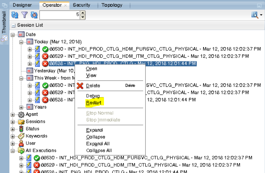

  2. Once all the child scenarios are successfully complete, restart the failed package, INIT_PKG_HDI_PROD_CTLG.

Restarting Failed ETLs
When an ETL fails during the data loading process, rerun the package scenario.
When an ETL fails during the data loading process, rerun the failed ETL.

Restarting failed ETLs
