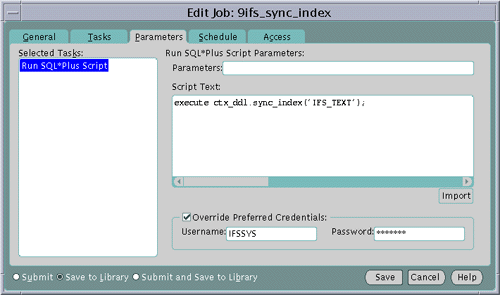

The Oracle Text index is not like a regular index in that updating does not happen within the insert/update transaction. A separate "index refresh" must take place. The refresh is accomplished with the ctx_ddl.sync_index procedure. It can be easily set up as a dbms_job to run at any frequency. This procedure does not rebuild the entire index. It only adds the records that have been inserted or changed (or deleted) since the last sync. Therefore the more frequently it runs, the faster it goes.
The downside to running this frequently is that the index becomes fragmented with eventual performance implications. This can be rectified by occasionally optimizing the index.
Indexes for Oracle Text can be created using a number of SQL and PL/SQL procedures. Before the Oracle9i database, Oracle Text was an optional feature, and required a process called CTXSRV to be running for any indexes to be updated. This process is still used, but it is deprecated in the Oracle9i database.
The PL/SQL interface for index maintenance is preferable for a production system:

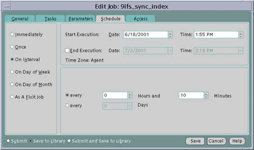

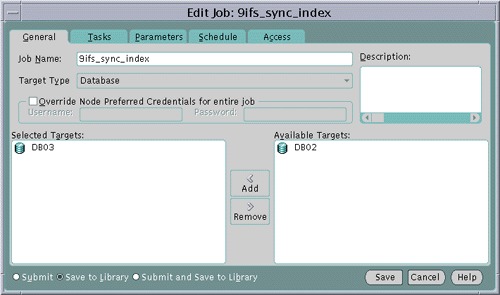

These two commands can run simultaneously. You can run these commands using the Oracle Enterprise Manager Java Console job system. Another option is the DBMS_JOB package, which is described in the Oracle9i Database Administrator's Guide.
To use the Oracle Enterprise Manager Java Console job system, you need to make sure it has been configured correctly. Refer to "Enabling the Job System" in the Oracle Enterprise Manager Configuration Guide.
