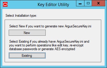

  1. Launch the Cryptography Key Editor.
    The Key Editor Utility screen appears.
    Surrounding text describes sct17.jpg.
  2. Click New.

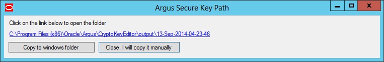

    The ArgusSecureKey.ini file gets created in the <Installation folder> \ CryptoKeyEditor\output\<DateTimeStamp>\.The Argus Secure Key Path dialog box appears.
    Surrounding text describes sct19.jpg.
  7. Click the link in the Argus Secure Key Path dialog box to open the folder in Windows Explorer.
  8. Click Close, I will copy it manually to close the dialog box and copy the file manually from the window that gets opened by clicking on the link mentioned above (in step 9).
  9. Click Copy to windows folder to move the generated ArgusSecureKey.ini file to the .\Windows folder.
    Surrounding text describes sct20.jpg.
  2. Click Existing.

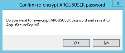

  5. Click Re-encrypt.
    The following dialog appears.
    Surrounding text describes sct22.jpg.
  6. Click Yes.

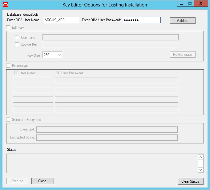

  3. In the Enter the ARGUSUSER password field, enter the password for the database user called ARGUSUSER.
  4. Enter the name of the database in the Database name field.
  5. Click Login.
    The Key Editor Options for Existing Installation screen appears.
    Surrounding text describes sct32.jpg.

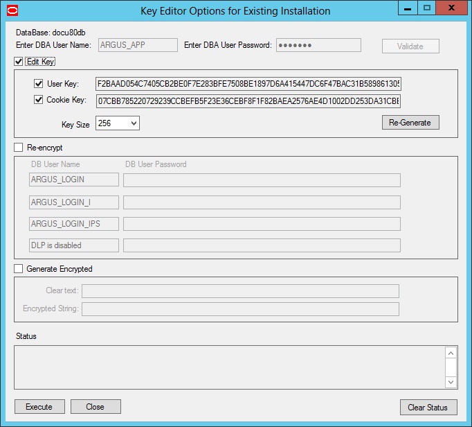

  6. Enter the DBA User Name and User Password.
  7. Click Validate.
  8. Check the Edit Key check box.
    This enables the child check boxes of User Key and Cookie Key.
    Surrounding text describes sct27.jpg.
    The User Key is used for all the encrypted strings which are persisted in the database or file server.
    The Cookie Key is only used to encrypt and decrypt the key.
    The user has the option to change either one or both keys.
  9. Select the check boxes in front of the key that you want to change.
  10. Change the Key Size drop-down list value, if you wish to change the key size. Key Size is measured in bits of the key used in a cryptographic algorithm.
  11. Click Re-Generate.
    This will change the value of the checked items and the new value will be visible in the textbox.
  12. Click Execute.

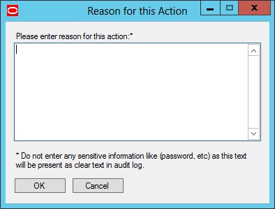

    The Reason for this Action dialog box appears, prompting the user to add a reason for his action.
    Surrounding text describes sct29.jpg.
    The text entered here is visible in the Audit Log in the Argus Safety application.
  13. Click OK.
  14. Check the status box to verify if the operation has been successful.
