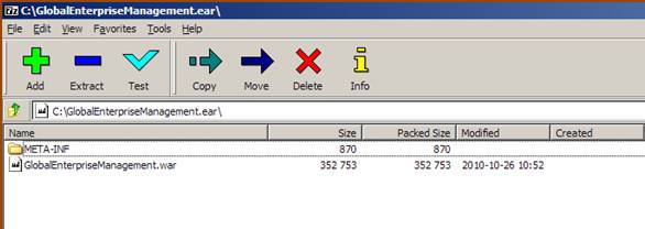

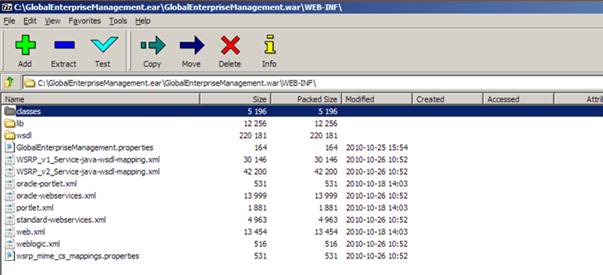

  1. Open the .ear file using a Zip utility. The zip program will open with files as seen below.
    Surrounding text describes image051.jpg.
  2. Double click the .war file and you will see the following screen. Double Click the WEB-INF folder.
    Surrounding text describes image003.jpg.
  3. Double click the file portletname.properties where portletname is the name of the portlet ear file under modification.
    Surrounding text describes image053.jpg.

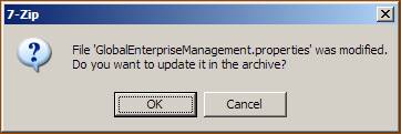

  5. Save the changes to the properties file and close it. Close the 7-zip manager window and press OK to save the changes in the archive. You are now ready to deploy the ear file.
    Surrounding text describes image055.jpg.

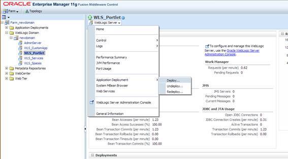

  6. Log in to the Oracle Enterprise Manager Admin Console and navigate to WebLogic Domain>Your Domain>WLS_Portlet. From the top left corner, navigate to Weblogic Server >Application Deployment>Deploy.
    Surrounding text describes image056.jpg.

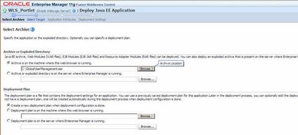

  7. Select Archive is on the machine where this web browser is running and click Browse. Browse to the modified .ear file on your local machine.
    Surrounding text describes image005.jpg.
  8. The Portlet will now get uploaded to the server.

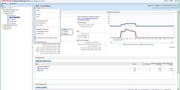

Now, perform the following steps to deploy the global home application on the Weblogic Server.
  1. Log in to the Enterprise Manager Admin console. In the left hand tree navigation, select WebLogic Domain>Your Domain>WLS_CustomApp in the left hand tree navigation. The WLS_CustomApp is the name of the server that we have created to deploy Global Home Page. Click the menu just below the name of the server as shown below. Navigate to Application Deployment > Deploy.
    Surrounding text describes image062.jpg.

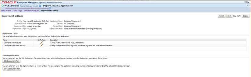

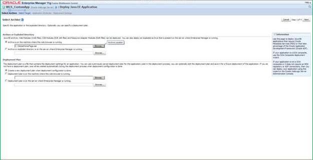

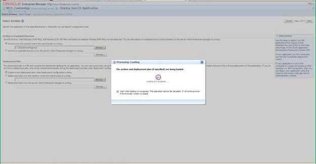

  3. The following screen appears. Browse for the application. ear file and click Next.
    Surrounding text describes image063.jpg.
  4. Wait for the progressing dialog to finish.
    Surrounding text describes image064.jpg.

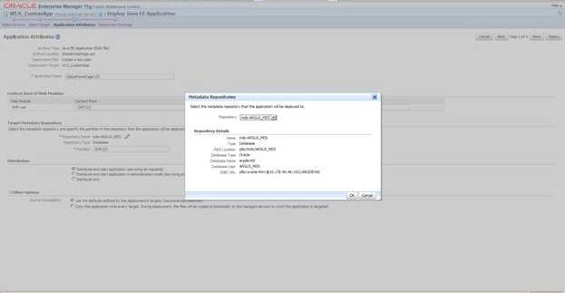

  7. A modal dialog appears that allows you to specify the metadata repository for this application. Choose a metadata repository and click OK.
    Surrounding text describes image067.jpg.

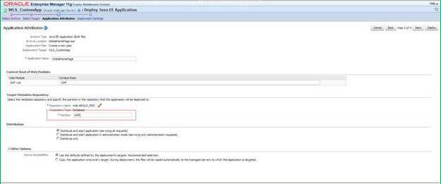

  8. Specify the partition value. You may choose any value but Oracle recommends using the application name itself as the partition value. Click Next.
    Surrounding text describes image068.jpg.

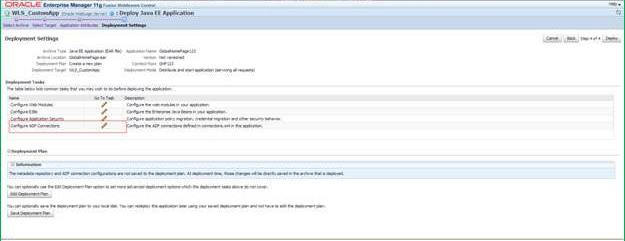

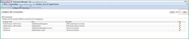

  9. In the Configure ADF connections section, click pencil icon, you will be redirected to the Configure ADF connections screen.
    Surrounding text describes image069.jpg.

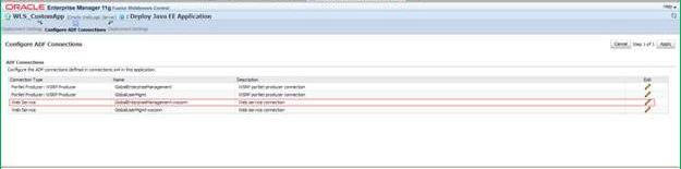

  10. In the Configure ADF connections screen, modify the web service connection. Click the pencil icon to edit the ADF connection settings.
    Surrounding text describes image070.jpg.

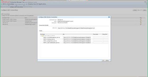

  11. A modal dialog comes where you can change ADF connections. You must modify the URL of the following fields to reflect the settings of your deployed portlets.
    • WSDL URL
    • WSRP_v2_PortletManagement_Service
    • WSRP_v2_Markup_Service
    • WSRP_v2_Registration_Service
    • WSRP_v2_ServiceDescription_Service
    Surrounding text describes image071.jpg.
  12. Click OK to close the modal dialogue and you will return to the parent screen. Click Apply in the top right corner. You will return to the deployment wizard screen 4 of 4. Click Deploy. The server will now deploy the ear file and report the success/failure status of the operation.
    Surrounding text describes image074.jpg.

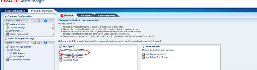

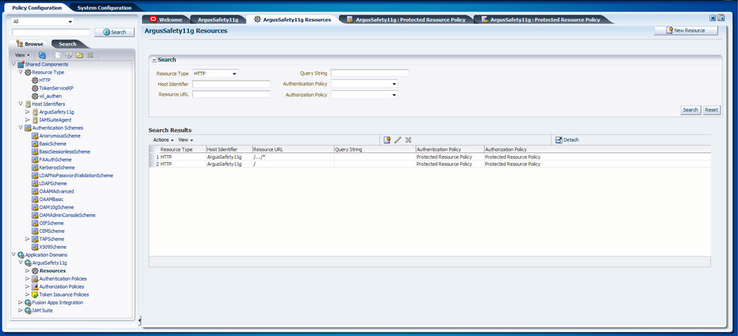

  1. Navigate to the System Configuration tab of OAM and select the New OAM 10g Webgate link.
    Surrounding text describes oam11g1.jpg.

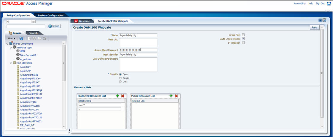

  2. The Create OAM 10g Webgate screen is displayed. Enter the name of the Webgate in the Name field and provide the password for the Webgate in the Access Client Password field. Click Apply.
    Surrounding text describes oam11g2.jpg.

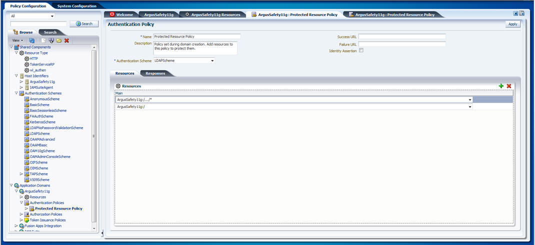

  3. The following screen is displayed:
    Surrounding text describes oam11g3.jpg.

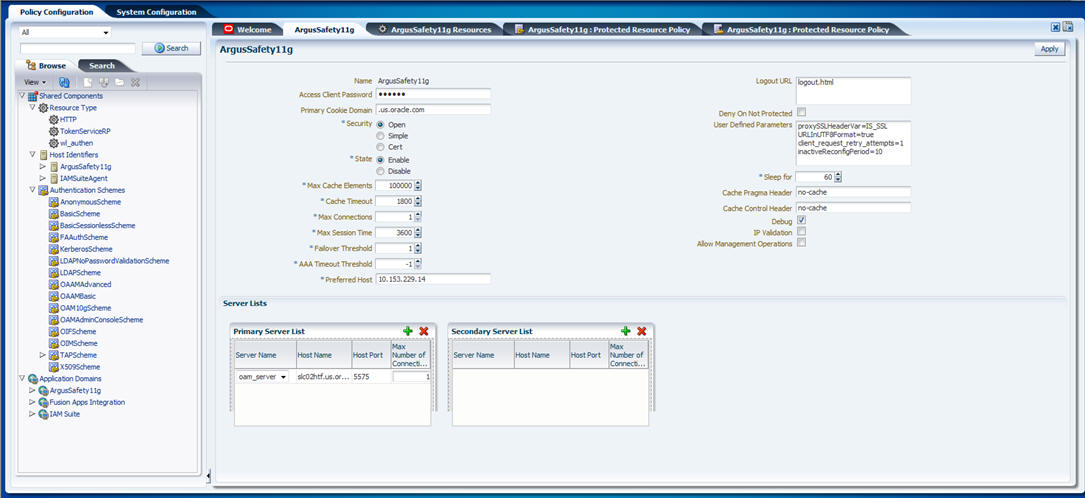

    Refresh the Host Identifier list to view the newly created Webgate within the Policy Configuration tab.
    Provide details such as Primary Cookie Domain and Preferred Host, as shown above and click Apply:
    • Primary Cookie Domain - provide FQDN of the machine where you will install webgate, prefixed by a period. For example, .idc.<example.com>. Note the . before the FQDN.
    • Preferred Host - provide the IP Address of the Argus Web Server where you will install webgate.
  4. Expand the list of Application Domains and under this, expand the newly created Webgate.
    Double-click on Resources. On the Resources screen, click the Create icon (displayed in the Search Results section, with the + symbol in red).
    Create the resource type with the correct host identifier, as displayed in the following screen:
    Surrounding text describes oam11g4.jpg.
  5. Expand the Authentication Policies under the newly created Webgate.
    Double-click the Protected Resource Policy. The following screen appears:
    Surrounding text describes oam11g5.jpg.
  6. Navigate to the Responses tab and click the + button to add the Name, Type, and Value for the responses, as shown in the following screen:
    Surrounding text describes oam11g6.jpg.

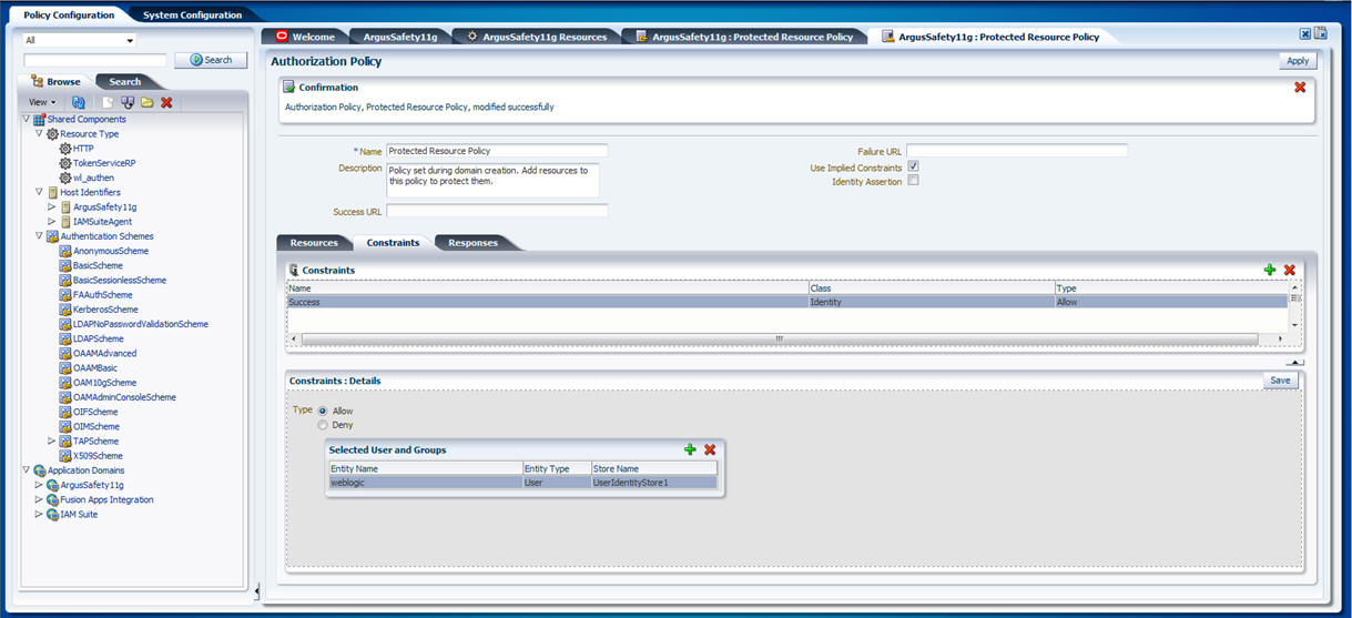

  7. Expand the Authorization Policies under the newly created Webgate and double-click the Protected Resource Policy.
    Select the Constraints tab and click the + button to add the Name, Type, and Class for the constraints, as shown in the following screen:
    Surrounding text describes oam11g7.jpg.
    All the names under the Constraints tab with Type as Allow can access the Argus Safety Server where Webgate has been installed. Select the Type as Deny if a user should be denied access to the Argus Safety Server where Webgate has been installed.
    If no constraint is added, all the users configured on the LDAP Server will have access to the Argus Safety Server where Webgate has been installed.

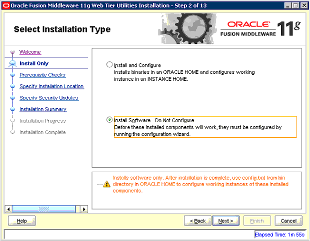

  3. Select Install Software - Do Not Configure and click Next.

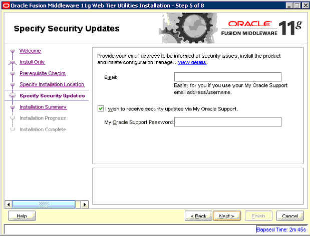

  5. You can skip security updates so uncheck the option to receive security updates via My Oracle Support. The system will give a warning. Click Yes to close the screen and then click Next.

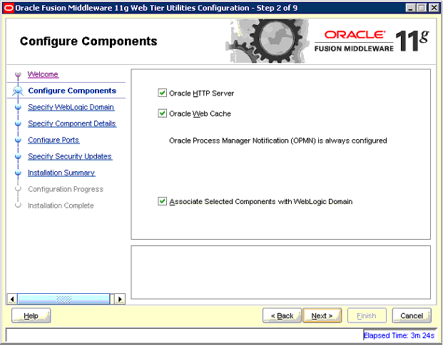

15.6.2 Configuring Oracle Web Tier
The following section describes the procedure to configure the Oracle Web Tier (OHS).

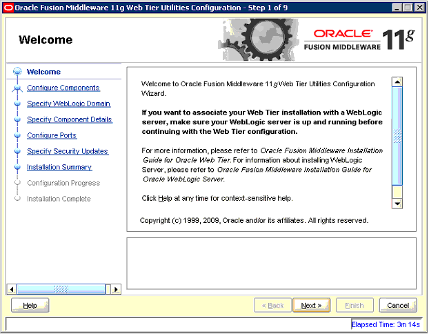

  1. Navigate to the folder Oracle Middleware_Home\Webtier_Instance\bin. For example, C:\OracleNew\Middleware\Oracle_WT1\bin. Here Oracle_WT1 is the name of the webtier instance created during installation. In the folder, run config.bat to start the configuration wizard.
    Surrounding text describes sec12_6_2fig1.GIF.
  2. In the next screen, click Next.
    Surrounding text describes sec12_6_2fig2.GIF.

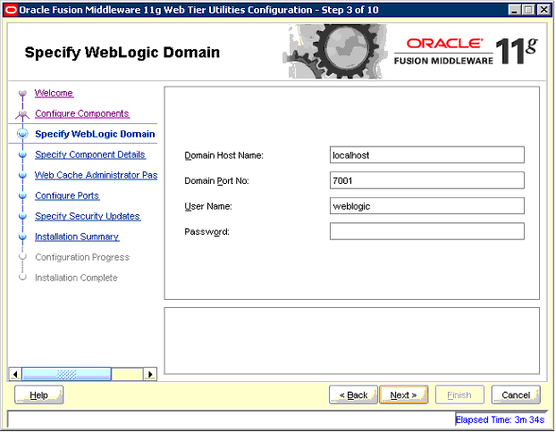

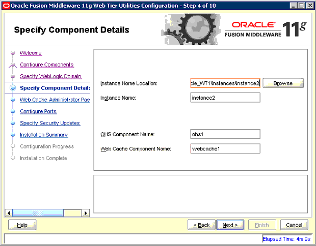

  3. Enter details of the weblogic server and click Next.
    Surrounding text describes sec12_6_2fig3.GIF.

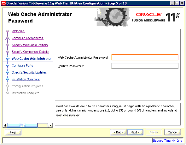

  5. Enter a password for Web Cache and click Next.

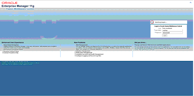

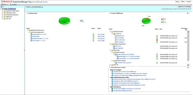

  8. After the configuration, navigate to http://localhost:7001/em. This will open the Enterprise Management console for Fusion Middleware as shown below. Log in using the same credentials as that of the WebLogic server.
    Surrounding text describes sec12_6_2fig8.GIF.

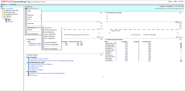

  9. Click the Web Tier node on the left.
    Surrounding text describes sec12_6_2fig9.GIF.

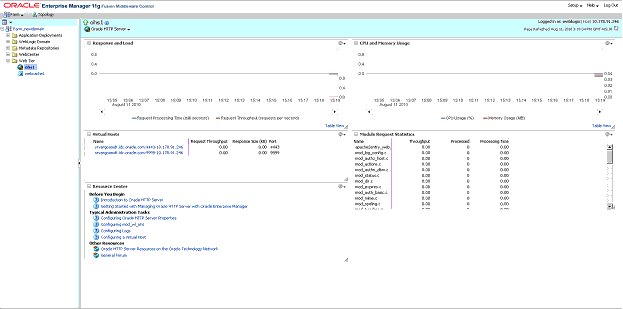

  10. Click the name of the OHS instance that you have created during installation. In the following example, the OHS instance is ohs1.
    Surrounding text describes sec12_6_2fig10.GIF.
  11. You will see all the details related to Oracle Http server on this console.
    Surrounding text describes sec12_6_2fig11.GIF.
15.6.3 Oracle Http Server Administration
This section describes the procedure to perform administrative tasks on the Oracle Http Server.
  1. Perform steps 8 to 11 from the section Section 15.6.2, "Configuring Oracle Web Tier".
  2. Click Oracle Http Server just below instance name at the top of right pane to access a menu.
    Surrounding text describes sec12_6_3fig1.GIF.
    This menu allows you to perform the following administrative tasks:
    • Control > Start Up - You can start an OHS instance using this option.
    • Control > Shut Down - You can stop and OHS instance using this option.
    • Control > Restart - You can restart an OHS instance using this option.
    • Logs > View Log Messages - You can view logs of the OHS instance using this option.

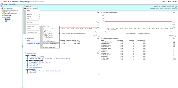

  2. Navigate to Administration > mod_wl_ohs_configuration from the top menu.
    Surrounding text describes sec12_6_4fig1.GIF.

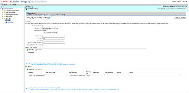

  3. The following screen appears:
    Surrounding text describes sec12_6_4fig2.GIF.
    In the General section enter the following information:
    • Weblogic host: FQDN of the machine where weblogic server and other managed servers are running.
    • Weblogic port: Port of the WebLogic server.
    • Debug: Give ERR.
    • Log File: You can provide a log file here.
    In the Locations Section:
    • Click AddRow and add a new row.
    • In the WebLogic Host and Port field enter the same values as that in the general section of this page.
    • Location field: For entering a value in this field consider an example. If the URL for the Global Home Page deployed on custom server is http://<myhost.idc.example.com:7777>/GlobalHomePage/faces/GlobalHome, then <myhost.idc.example.com> is the FQDN of the machine where WebLogic server is installed and 8001 is the port at which custom server is listening. Now take the path after port /GlobalHomePage/faces/GlobalHome and enter this as the value in the location field.
    • Click Apply on the top right corner.
  4. Restart the Oracle http Server using the Restart option of the top level menu.

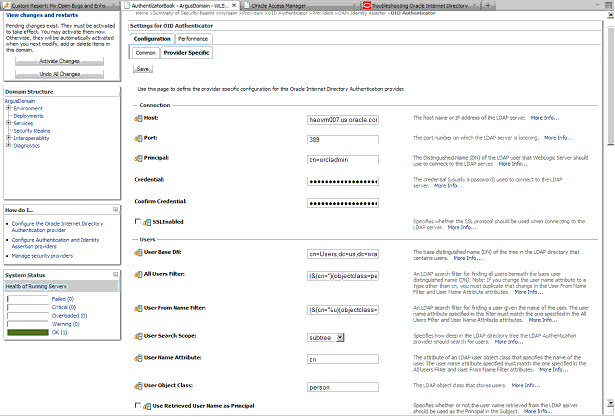

15.7.1 Configuring the Oracle Internet Directory Authenticator
This section describes the procedure to configure the Oracle Internet Directory Authenticator.

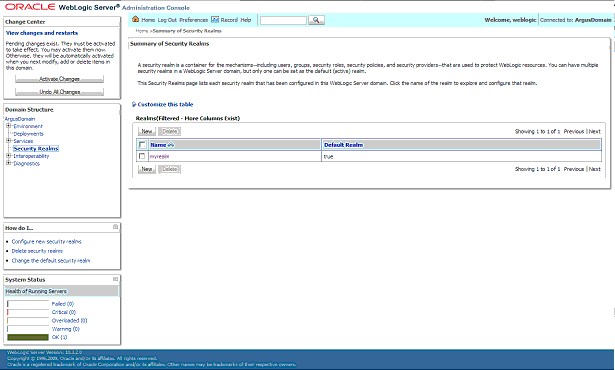

  1. Log in to the WLS Administration Console. From the Domain Structure pane, click Security Realms. Then click myrealm.
    Surrounding text describes sec12_7_1fig1.GIF.

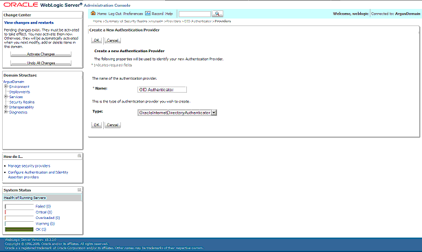

  2. Navigate to Providers > Authentication. Click New to create a new provider.
    Surrounding text describes sec12_7_1fig2.GIF.
  3. Enter Name as OID Authenticator and select type from the drop-down as OracleInternetDirectoryAuthenticator. Click OK.
    Surrounding text describes sec12_7_1fig3.GIF.
  4. Go back to the Providers tab and click OID Authenticator, which appears as link.
  5. In the Common sub tab modify the Control Flag field to Sufficient and click Save.
  6. Click the Providers Specific tab and provide values for the fields described in the table below:
    Table 15-1 Values for the Providers Specific tab
    Parameter Name Description Sample Value
    Host
    LDAP Hostname
    i<myhost.vm.example.com>
    Port
    LDAP Port
    389
    Principal
    LDAP admin principal
    cn=orcladmin
    Credential
    Password for admin principal (password of cn=orcladmin)
    User Base DN
    User Search Base - This value can be obtained by checking the Users realm DN from OID
    For example, cn=Users,dc=idc,dc=oracle,dc=com
    All Users Filter
    Set as (&(uid=*)(objectclass=person))
    User Name Attribute
    Set to "uid" from "cn"
    uid
    Group Base DN - Group search base - Same as User Base DN
    Group Search Base - The DN used to search the Group, can be checked by Groups DN in OID
    For example, cn=Groups,dc=idc,dc=oracle,dc=com
    Retain the default values for the remaining attributes. Click Save.

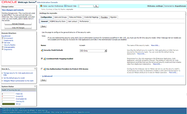

15.7.2 Configuring the OAM Identity Asserter
This section describes how to configure the OAM identity asserter in WebLogic server security realm.

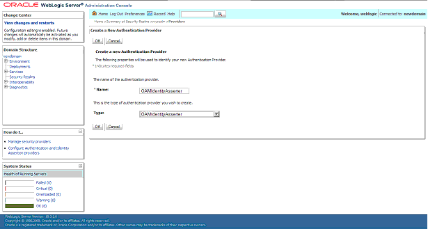

  2. Click the Providers tab to see list of providers.
  3. Click New. Enter name as OAMIdentity Asserter and select type as OAMIdentityAsserter.
    Surrounding text describes sec12_7_2fig3.GIF.
  4. Click OK to save the details. Now click the newly added OAMIdentityAsserter, which appears as link to view its details.
  5. In the Common sub tab select control flag as REQUIRED and click Save.
  6. Navigate to the Providers sub tab and provide the details in the table below:
