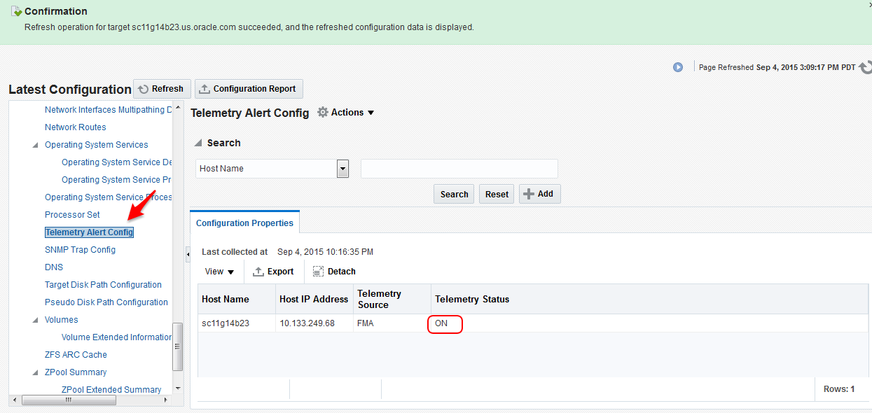

  4. Optionally, verify the snmpd configuration by making sure the status for Telemetry Status is ON in the host target, in the Telemetry Alert Config metric.
    After the configuration of the snmp through steps (1) – (3), navigate to Host home page and perform the following steps:
    1. Select Host and click Configuration.
    2. Click Last collected.
    3. Select Telemetry Alert Config metric.
    4. Click Refresh, wait for few minutes until the metrics get refreshed.
    Telemetric Status
    If the Telemetry Status is ON in Telemetry Alert Config metric, it indicates the the configuration of FMA SNMP traps is done correctly.
