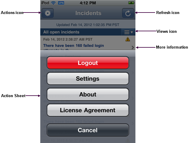

Although navigation is intuitive, the following sections offer guidance on viewing incidents and problems. As the interactions are slightly different, there is a separate section for each type of issue.
Viewing Incidents
Use the following guidelines as you view incidents in the list:
An arrow on the right indicates availability of additional information.
Tap anywhere in the incident row to drill down to incident details.
The summary appears at the top. As summaries can be lengthy, you may need to tap the opening lines of the summary to view the complete summary. Tap Incident to return to incident details.
Problem ID in incident details is a link to problem details. If you follow the link, tap Incidents there to return to the starting point; that is, the original list view where you first opened the incident.
In the incident details view, target name is a link to target details. Tap Incident there to return to incident details.
Tracking information appears below target name in the incident details view.
Scroll down in incident details and tap All Updates to see the equivalent of the Updates tab in the desktop version. Tap Incident there to return to incident details.
Scroll further and tap Event List to see the equivalent of the Events tab in the desktop version. Tap Incident there to return to incident details.

When you first log in, the my open incidents and problems view appears by default. You can change the view as follows:
You can perform the following actions while viewing incident or problem details:
Acknowledge the issue
Manage the workflow of the issue
To acknowledge an incident or problem:
While viewing the details, tap Actions.
Tap Acknowledge in the action sheet.
A message confirms the update on the Details screen.
Note that the Acknowledge action may not appear in the action sheet for a variety of reasons; for example, the issue has already been acknowledged or closed, or you do not have the right permissions to acknowledge the issue.
