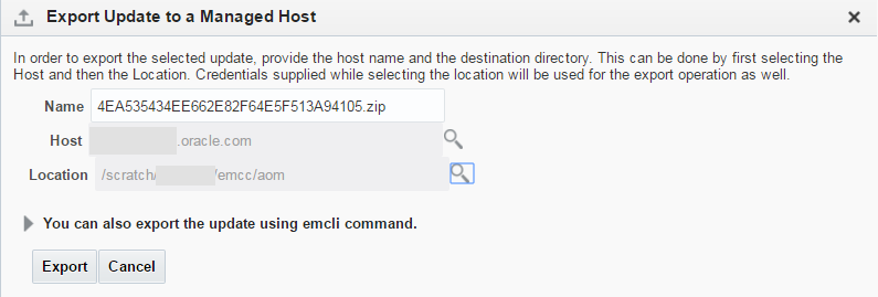

To export to your workstation, select the entity and click on Actions → Export to → Your Workstation. The Self-Update file (in zip format) automatically downloads to your workstation. After unzipping this file, go to the archives subdirectory and copy ems_13.2.0.1.0.zip to the AOM host. Unzip ems_13.2.0.1.0.zip and continue the steps outlined in the product documentation. See Configuring Always-On Monitoring.
To export to a managed host, select Actions → Export to → Managed Host. The Export Update to a Managed Host dialog displays.
Enter the name of the export file name or accept the default name.

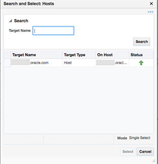

Click the search icon for the Host field. The Search and Select Hosts dialog displays.
Select a host and click Select. You might need to enter a search string to narrow the results.

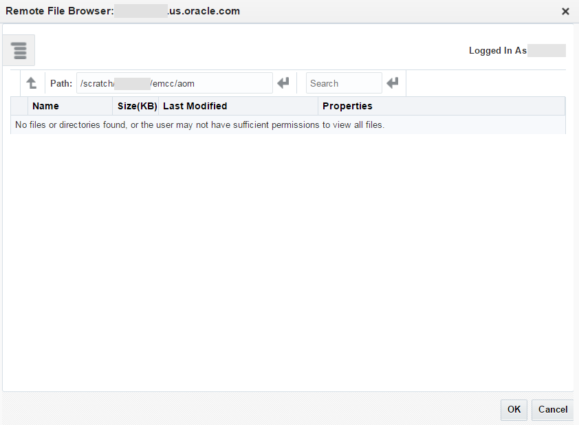

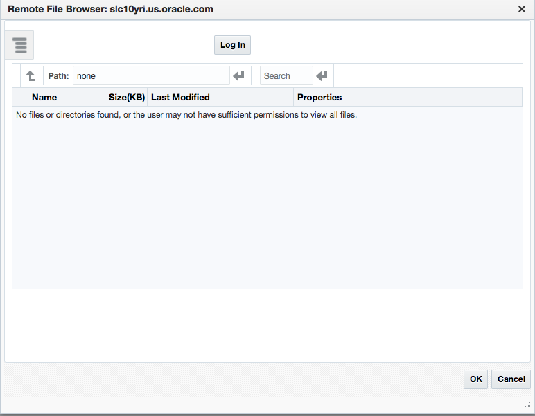

Click the search icon for the Location field. The Remote File Browser dialog displays.

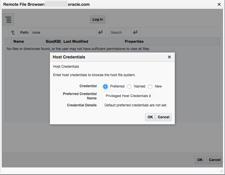

Click Log In. The Host Credentials dialog displays.
Select existing Preferred or Named credentials or enter a New set of named credentials and click OK.
Select the path where you want to place the export file and click OK.
The Export Update to a Managed Host pop-up window will be displayed with the selections listed.

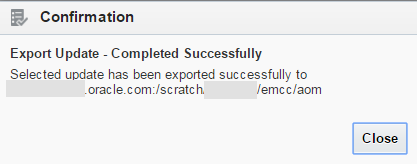

Click Export. A confirmation window will appear confirming the update has been exported successfully to this host.

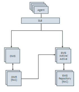

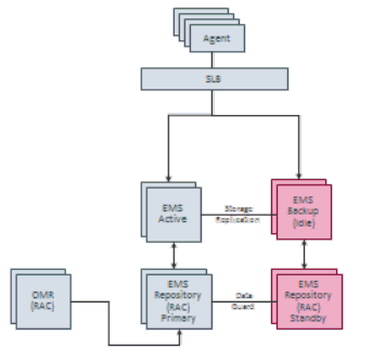

You can set up multiple Always-On Monitoring (AOM) instances to ensure Always-On Monitoring is available in the event of outages. See Setting Up Multiple Always-On Monitoring Instances for more information.

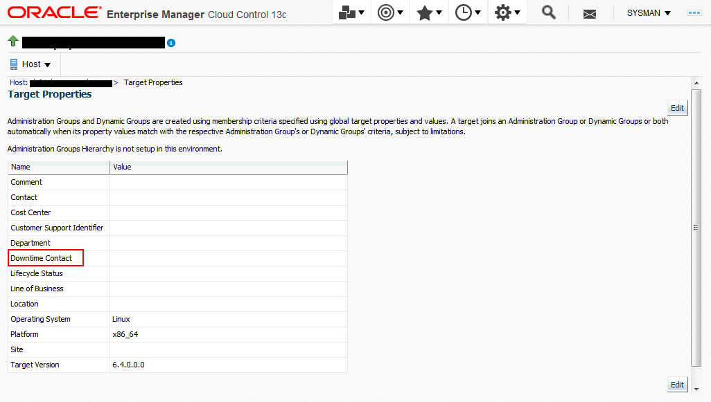

Per-Target Downtime Contact from Target Property
The email addresses for these downtime contacts should be specified in the Downtime Contact target property for each target. There are three ways to specify the Downtime Contact target property:
For each target, navigate to the Target Properties page, which can be accessed from the target's homepage. From the target menu on the target homepage, select Target Setup and then Properties. The Target Properties page displays.
Click on Edit and specify the email address in the Downtime Contact target property. You can specify multiple email addresses by separating them with commas.
Use the EM CLI set_target_property_value verb.

Verify that downtime contacts have been specified in Enterprise Manager and Always-On Monitoring by running emsctl status.

Adding multiple Always-On Monitoring instances provides the following HA advantages:
Shares the work of receiving and recording alerts from agents. If an instance goes down for some reason, a server load balancer (SLB) can redirect those requests to surviving instances
Shares the work of sending of notifications. For ordering reasons, all notifications for a target are directed to one Always-On Monitoring instance. If that Always-On Monitoring instance goes down, the responsibility for its "queues" are transferred to another instance.
emsca add_ems
The following diagram shows a typical Always-On Monitoring HA deployment.
Figure 12-1 Always-On Monitoring HA Deployment

Disaster Recovery (DR) allows Always-On Monitoring functionality to transition to a different location in the case of a site-wide failure.
There are existing procedures that allow an Enterprise Manager site to have a standby created for DR reasons. These procedures involve having the primary repository database's contents mirrored at the standby site using DataGuard, and the ability to link to the file system contents from the secondary site.
A very similar implementation can be used for Always-On Monitoring instances as well. An Always-On Monitoring DR setup is active-passive: If the primary site goes down, the virtual IP fails over to the standby node and, once the standby Always-On Monitoring instance is brought up, it runs exactly as it did on the primary node (because of the file system sharing and the virtual IP). In summary, the Always-On Monitoring repository needs to be available at the standby site, and the Always-On Monitoring instances' file systems need to be replicated. The following diagram shows the typical DR deployment for Always-On Monitoring.
Figure 12-2 Always-On Monitoring Disaster Recovery Deployment

Configure the downtime contacts. For more information, see Configuring Downtime Contacts in Enterprise Manager.
