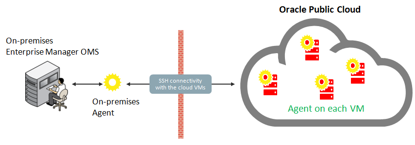

Communication between your cloud services and the OMS is secure from external interference. As shown in the following graphic, the on-premises OMS communicates via HTTPS, SQL*Net and JMX over SSH (if VPN is not available) with Agents installed on the VMs running your cloud services.
High-level Hybrid Cloud architectural diagram.
