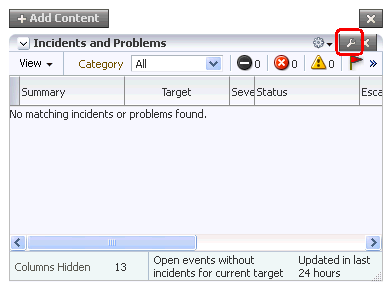

Click the “ratchet" icon next to the “X" icon within a region, as shown in Figure 26-3. Note that the icon will only be enabled if the region can be customized.
Figure 26-3 Customize Region Icon
For most resources, you will specify the target host from which to collect data.
Other configurable parameters and customization options vary between regions. When you click the icon, a dialog opens to enable you to specify parameters, such as target type, target name and metric name.
