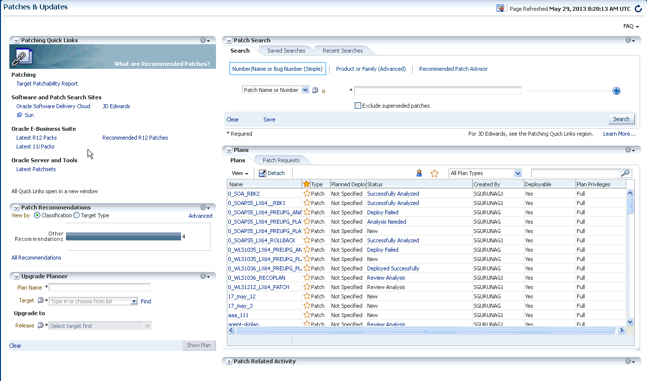

To access the Patches and Updates page in Cloud Control, from the Enterprise menu, select Provisioning and Patching, then select Patches & Updates.
Figure 25-1 displays the Patches and Updates page.
Figure 25-1 Patches and Updates Page
Patch recommendations are proactive notifications of potential system problems and recommendations that help you improve system performance and avert outages. Patch recommendations minimize the effort required to search for the critical patches that must be applied on your targets.
The Patch Recommendations section is available on the Patches and Updates page. The patches in this section are classified as security patches, and other recommended patches.

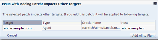

Ensure that the patches you select have the same platform as the targets that you want to patch. For example, Linux x86 patches can be applied only on Linux x86 targets. Any mismatch will result in a patching error.
If the selected patches are applied on homogeneous targets, then the patch plan is created successfully with a link to view the patch plan. Click the link to view the patch plan details.
If any of the Management Agent targets added to the patch plan are shared agents or cluster Management Agents, then you may see a warning message mentioning that there are issues with adding the patch to the patch plan.
As a solution to this problem, click Add All To Plan to add all the affected targets to the patch plan.

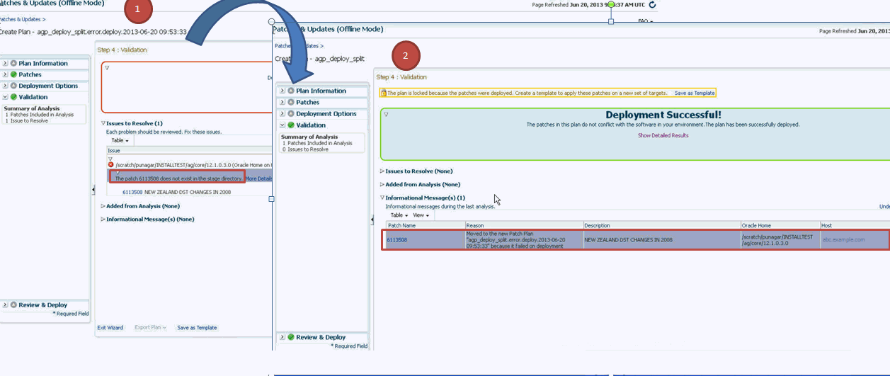

If any problems are encountered during the analysis phase, then the split plan feature is enabled, in which the patch plan is split into two patch plans, one having the targets for which the analysis failed, and another having the targets for which the analysis was successful. The patch plan having the targets for which the analysis was successful is available for deployment, while the other patch plan must be reanalyzed and deployed separately.
Figure 25-5 illustrates the split plan feature.

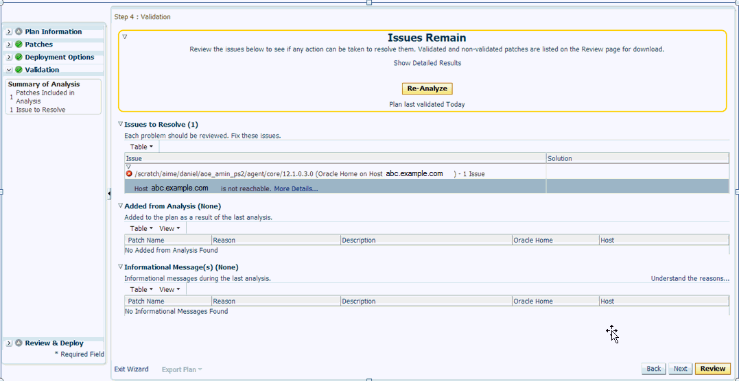

Error Description
This error occurs when the Management Agent target added for patching is not up and running.
Figure 25-2 displays an example of this error.
Figure 25-2 Patching Error: Management Agent Target Is Down
Workaround
Start the Management Agent target, then analyze and deploy the patch plan.

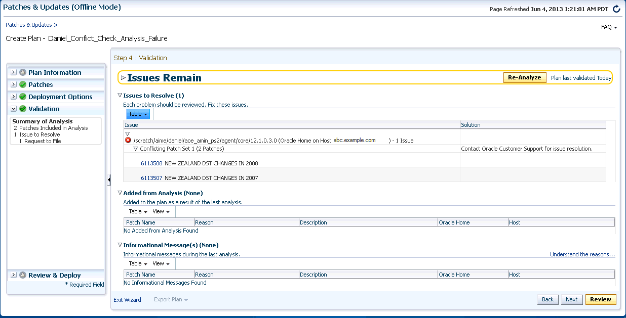

Error Description
This error occurs when there is a conflict between two added patches.
Figure 25-3 displays an example of this error.
Figure 25-3 Patching Error: Patch Conflicts
Workaround
Do one of the following:
Contact Support to obtain a merged patch.
Choose the advanced OPatch options to force apply the patch. However, choosing this option and applying the patch will result in the loss of earlier patch changes.

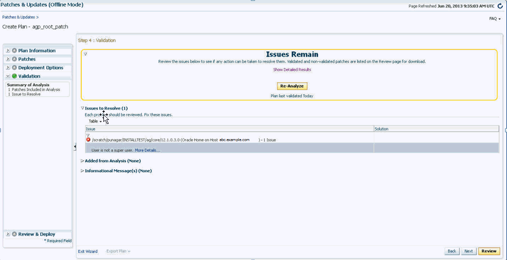

Error Description
This error occurs when the user that runs the patch plan does not have root access.
Figure 25-4 displays an example of this error.
Figure 25-4 Patching Error: User Is Not a Super User
Workaround
Follow these steps:
Create a new credential that has root access.
Ensure that privilege delegation settings have been configured on the target Management Agent host. For more information about privilege delegation, see Oracle Enterprise Manager Lifecycle Management Administrator's Guide.
Analyze and deploy the patch plan.
Error Description
This error occurs when the patch is not present in the stage location.
Figure 25-5 displays an example of this error. This figure also illustrates the split plan feature.
Figure 25-5 Patching Error: Patch Is Not Staged or Found
Workaround
Ensure that the patch is available in the stage location. Analyze and deploy the patch plan.
