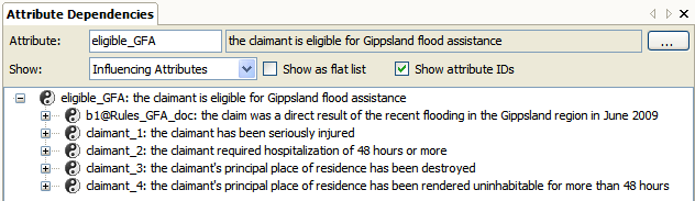

To see the structure of a rule you can use the Attribute Dependencies view. This view shows the dependencies of a selected attribute. This is a useful tool for checking whether or not intermediate attributes are only proved by the attributes you expect to be proving them.
To open the Attribute Dependencies view, select View | Attribute Dependencies. In this view, use the browse button to select the attribute whose dependencies you want to view.
TIP: If your rulebase is very large, searching for an attribute in the Attribute Selector will be quicker if you turn off the Filter search results on each keystroke option under File | Project Properties | Common Properties | General.
Once you have selected the attribute, use the following options to customize the view.
Show intermediates check box - if selected, includes intermediate attributes in the list view. This check box is only enabled if the Show as a flat list option is selected above.
As you change these options, the view will update in the pane below.
