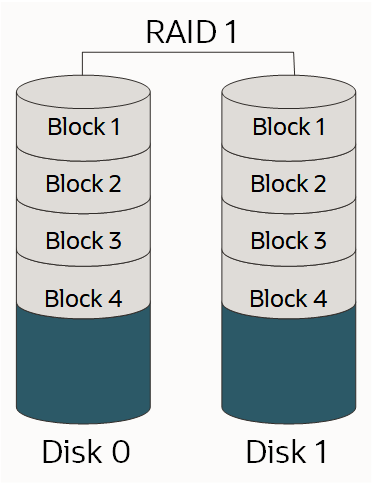

RAID 1: An exact copy (or mirror) of a set of data on two or more disks; a classic RAID 1 mirrored pair contains two disks, as shown:

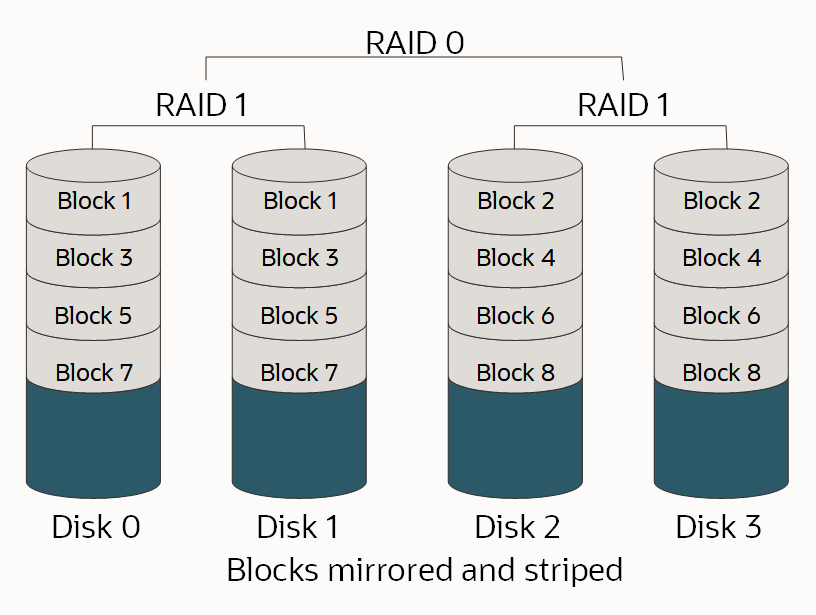

RAID 10: Stripes data across multiple mirrored pairs. As long as one disk in each mirrored pair is functional, data can be retrieved, as shown:

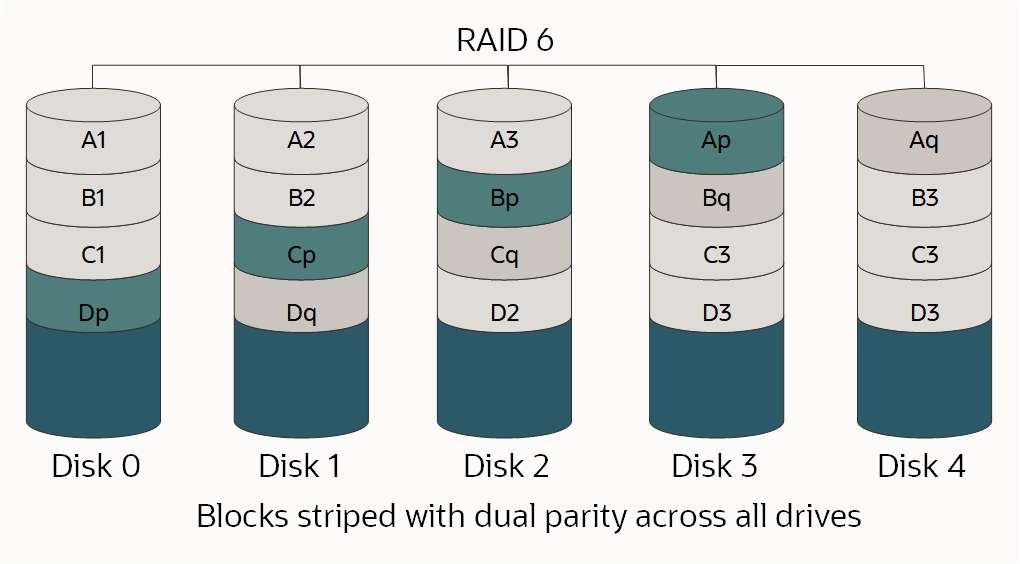

RAID 6: Block-level striping with two parity blocks distributed across all member disks, as shown.
