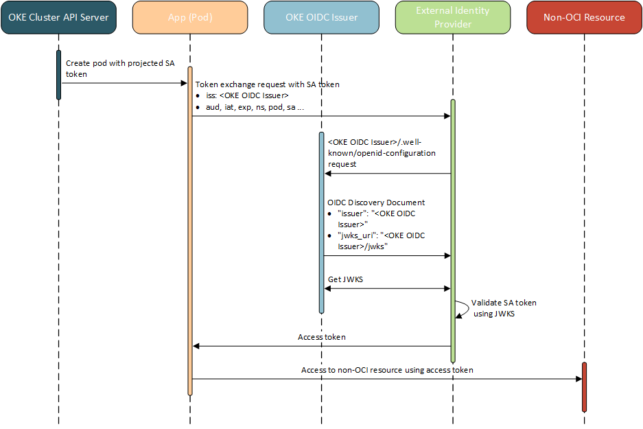

OIDC Discovery token exchange process
- An OIDC Issuer. The OIDC issuer is exposed over HTTPS with a publicly trusted TLS/SSL certificate.
- An OIDC discovery document (in JSON format) that includes the location of the JWKS. The discovery document is stored in a publicly accessible and unauthenticated bucket in the Object Storage service (the OIDC discovery endpoint). See Discovery Document Example.
- A JSON Web Key Set (JWKS), containing the public keys used to verify the service account token. The JWKS is stored in a publicly accessible and unauthenticated bucket in the Object Storage service. See JWKS Example.
When defining an application pod that sends requests to an external API, if the external cloud provider's identity provider expects a specific audience in the service account token, specify a projected serviceAccountToken in the pod manifest and set its audience property accordingly. See Pod Manifest Example.
The following is an overview of the token exchange process:
When you create the application pod on the cluster, Kubernetes gives the pod a service account token. The service account token includes the URL of the Kubernetes Engine OIDC Issuer as the value of the
issclaim in the JWT. If you specified an audience in the pod manifest, the audience is included in the JWT as the value of theaudclaim. See Service Account Token Example. - The application pod makes a request to an API on an external cloud provider and presents the encoded service account token to the external cloud provider in the Authorization header of the API request.
- The external cloud provider's identity provider decodes the service account token, extracts the URL of the Kubernetes Engine OIDC Issuer from the
issclaim, appends/.well-known/openid-configurationto the URL as the location of the OIDC discovery document (the OIDC discovery endpoint). The identity provider sends a request to that URL to obtain the discovery document. - The Kubernetes Engine OIDC Issuer returns the OIDC discovery document, which contains the URL of the location of the JWKS in the
jwks_urifield. See Discovery Document Example. - The external cloud provider's identity provider extracts the URL from the OIDC discovery document and sends a request to that URL to get the JWKS. See JWKS Example.
- The external cloud provider's identity provider uses the JWKS to validate the service account token originally presented by the application pod.
- Assuming the service account token is valid, the external cloud provider's identity provider returns an access token to the application pod.
- The application pod presents the access token to the API on the external cloud provider to prove its identity, and successfully makes API requests.
The token exchange process is shown in the following diagram:
