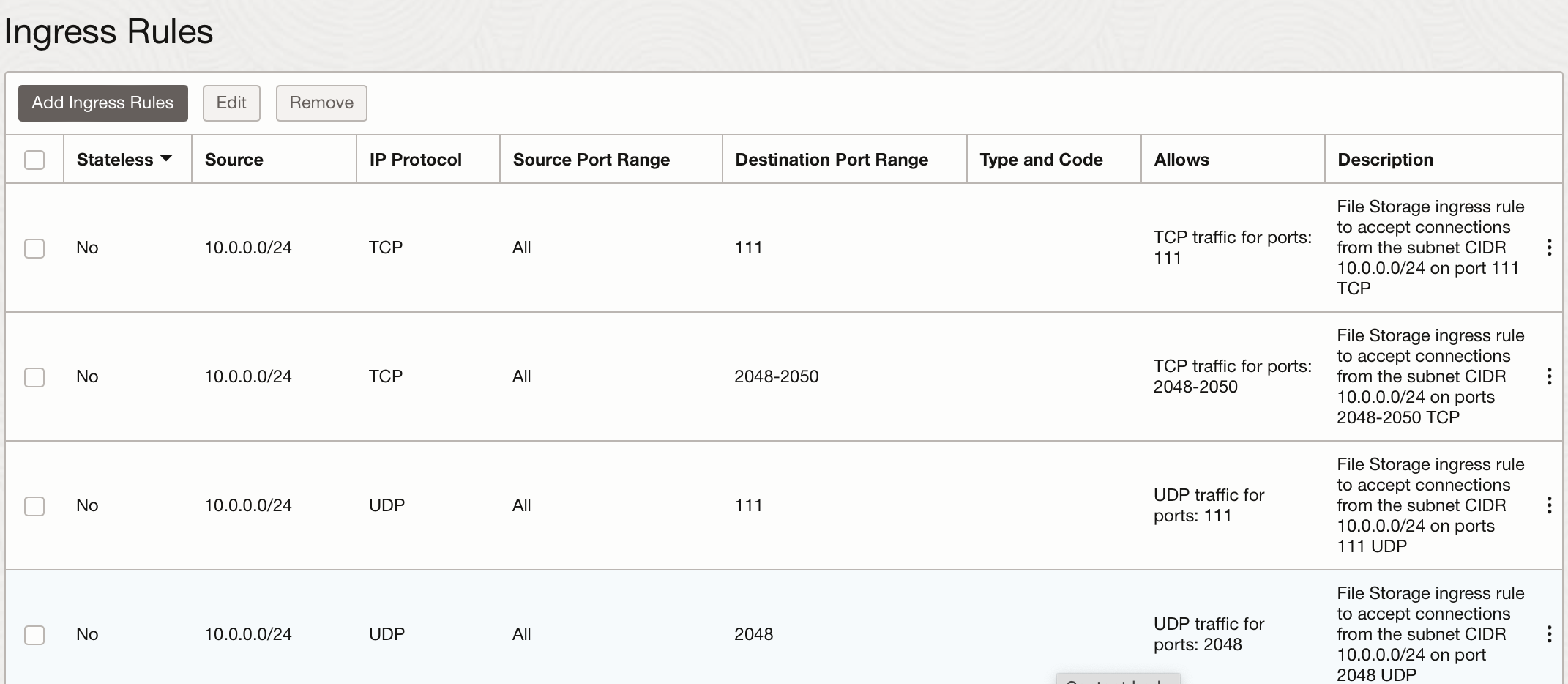

- Stateful ingress from source instance CIDR ALL source ports to destination ports 111, 2048, 2049, and 2050, TCP protocol.
- Stateful ingress from source instance CIDR ALL source ports to destination ports 111 and 2048, UDP protocol.

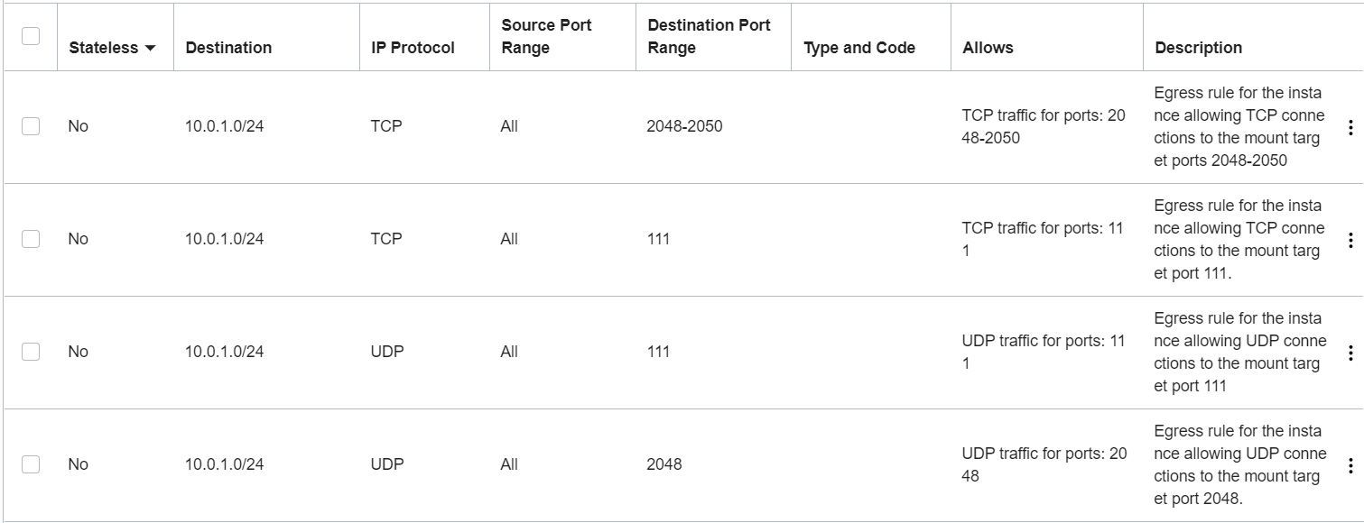

- Stateful egress from ALL source ports to destination mount target CIDR ports 111, 2048, 2049, and 2050, TCP protocol.
- Stateful egress from ALL source ports to destination mount target CIDR ports 111 and 2048, UDP protocol.

Ingress rules for the mount target's NSG or subnet security list. The instance CIDR block 10.0.0.0/24 is the source:
Egress rules for the instance's NSG or subnet security list. The mount target CIDR block 10.0.1.0/24 is the destination:

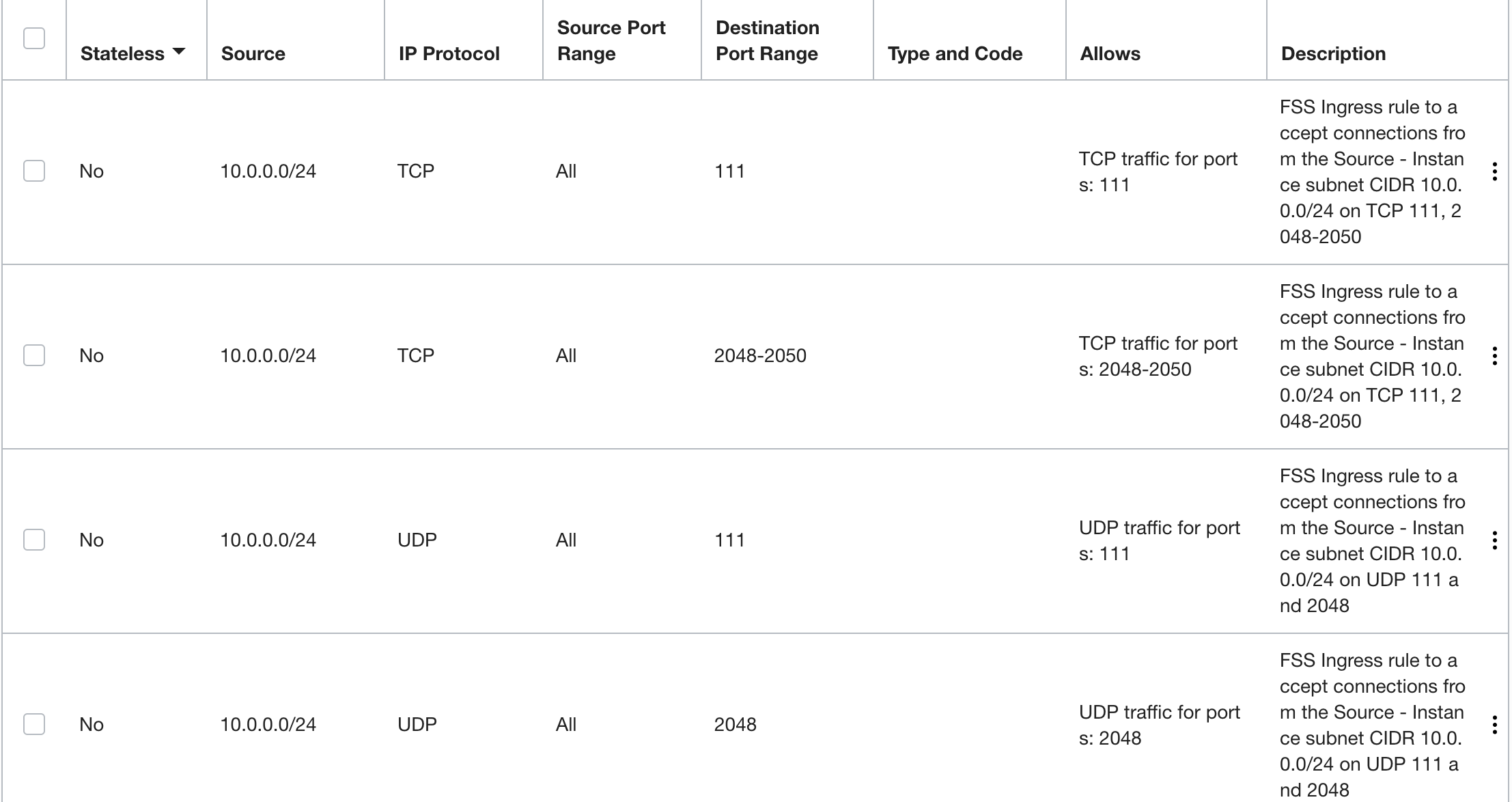

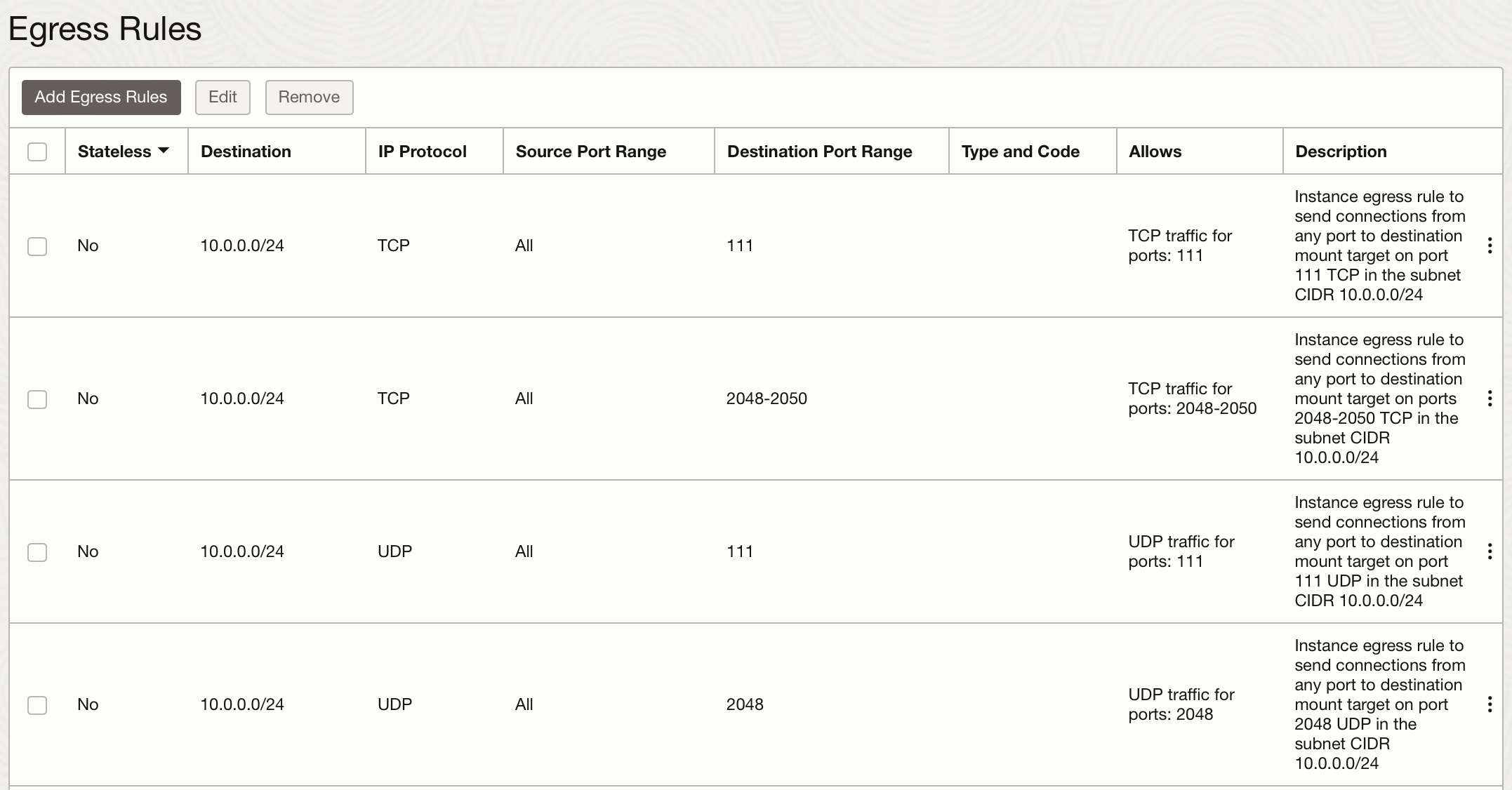

We recommend that NFS clients be limited to reserved ports. To do this, set the Source Port range to 1-1023. You can also set export options for a file system to require clients to connect from a privileged source port. For more information, see Working with NFS Exports and Export Options.
Here's an example of the rules for this scenario set up for a single subnet that contains both the mount target and the instance. In this example, both the mount target and the instance are in CIDR block 10.0.0.0/24:

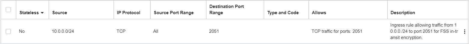

In this scenario, in-transit encryption secures data between instances and mounted file systems using TLS v.1.2 (Transport Layer Security) encryption. See Using In-transit TLS Encryption for more information.
You can limit the source to the IP address or CIDR block of your choice.
Set up the following security rules for the mount target:
- Stateful ingress from source CIDR ALL source ports to destination port 2051, TCP protocol.
Here's an example of the rule for this scenario set up in security list for the mount target's NSG or subnet. This example shows rules for specific source CIDR block 10.0.0.0/24 as the source:
