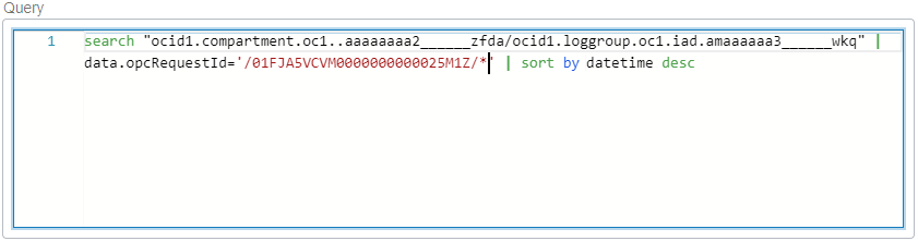

Tip: Filtering logs by request id
When searching log data, you can use the data.opcRequestId field to filter logs by request id. If an API deployment in API Gateway invokes a function on an OCI Functions back end, you can see logs relating to both the API Gateway request and the OCI Functions request by using the same data.opcRequestId field together with a wildcard, as follows:
- On the Logging Search page, select the down arrow beside a log event to see log data for that event.
- Select the
"data.opcRequestId"field in the function log and select Filter matching from the popup menu.For example, assume the function log contains the field
"data.opcRequestId": "/01FJA5VCVM0000000000025M1Z/01FJA5VCVM0000000000025M20". The field"data.opcRequestId": "/01FJA5VCVM0000000000025M1Z/01FJA5VCVM0000000000025M20"is copied into the Log Search (Basic Mode) page as a filter. - On the Log Search (Basic Mode) page, select Show Advanced Mode and replace the second half of the
"data.opcRequestId"field value shown in the Query field with the * (asterisk) wildcard.For example, so that it reads
data.opcRequestId: '/01FJA5VCVM0000000000025M1Z/*' - Select Search.
