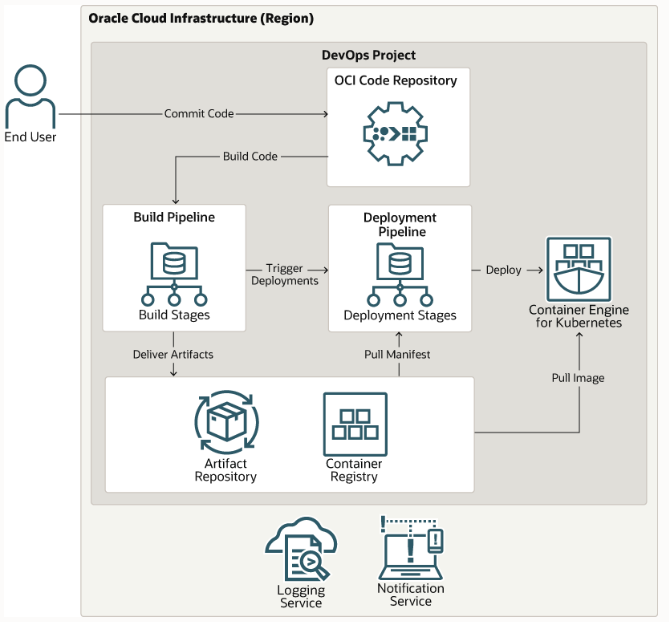

OCI DevOps
The build and deployment pipelines are the heart of the DevOps CI/CD workflow.
The OCI DevOps service lets you visually script build and deployment pipelines that automate calls to more focused tools. DevOps has the flexibility to integrate with your existing CI/CD workflows.
To explore CI/CD in OCI, you can build a CD pipeline by using DevOps or develop, debug, and deploy applications on Kubernetes Engine.

Build and Deployment Pipelines
OCI DevOps build and deployment pipelines reduce change-driven errors and decrease the time you spend on builds and deployments. Developers commit source code to a code repository, build and test software artifacts with a build runner, deliver artifacts to OCI repositories, and then run a deployment to OCI platforms.
You can use DevOps to implement various deployment pipeline strategies, including a blue-green strategy (which consists of two identical production environments), a canary strategy, and a rolling strategy.
For detailed pipeline instructions, see Managing Build Pipelines and Managing Deployment Pipelines.
Logs from your build runs and deployments are stored in the OCI Logging service for audit and governance. Your team can also receive notifications from events in your DevOps pipelines through the OCI Notifications service.
You can also use the Compute Jenkins Plug-in to centralize build automation and scale deployments, deliver your artifacts to OCI Artifact Registry, and trigger DevOps deployment pipelines.
