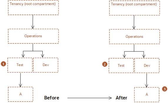

The following figure shows a compartment hierarchy in which compartment C, a child of A:B is moved to the hierarchy A:D.
| Item | Description |
|  | The tenancy has the following policies defined for compartments B and D: Policy1:  |
|  | Impact when compartment C is moved from B to D: Policy2:  |
Group G1 can no longer manage instance-families in compartment C.
Group G2 can now manage instance-families in compartment C.
Ensure that you are aware not only of what groups lose permissions when you move a compartment, but also what groups will gain permissions.

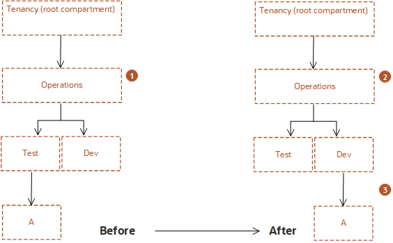

When you move a compartment, some polices will be automatically updated. Policies that specify the compartment hierarchy down to the compartment being moved will automatically be updated when the policy is attached to a shared ancestor of the current and target parent. Consider the following examples:
Example 1: Policy automatically updated
|  | Policy:  |
|  | Policy:  |
|  | The policy is automatically updated. Group G1 does not lose permissions. |
In this example, you move compartment A from Operations:Test to Operations:Dev. The policy that governs compartment A is attached to the shared parent, Operations. When the compartment is moved, the policy statement is automatically updated by the IAM service to specify the new compartment location.
No manual intervention is required to allow group G1 to continue to access compartment A in its location.
Example 2: Policy not updated
|  | Policy: Allow group G1 to manage buckets in compartment A |
|  | The policy isn't updated. Group G1 loses this permission. This policy is invalid and must be manually removed. |
In this example, you move compartment A from Operations:Test to Operations:Dev. However, the policy that governs compartment A here is attached directly to the Test compartment. When the compartment is moved, the policy isn't automatically updated. The policy that specifies compartment A is no longer valid and must be manually removed. Group G1 no longer has access to compartment A in its new location under Dev. Unless another existing policy grants access to group G1, you must create a new policy to allow G1 to continue to manage buckets in compartment A.

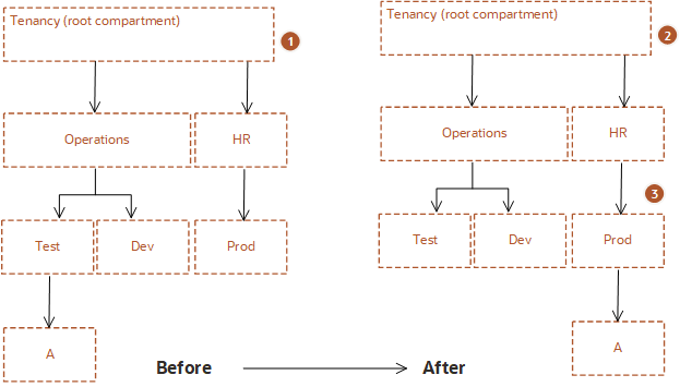

Example 3: Policy attached to the tenancy is updated
|  | Policy: Allow group G1 to manage buckets in compartment Operations:Test:A |
|  | Policy: Allow group G1 to manage buckets in compartment HR:Prod:A |
In this example, you move compartment A from Operations:Test to HR:Prod. The policy that governs compartment A is attached to the tenancy, which is a shared ancestor by the original parent compartment and the new parent compartment. Therefore, when the compartment is moved, the policy statement is automatically updated by the IAM service to specify the new compartment location.

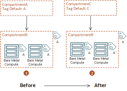

Understanding Tagging Implications When You Move a Compartment
Tags aren't automatically updated after a compartment move. If you have implemented a tagging strategy based on compartment, you must update the tags on the resources after the move. For example, assume CompartmentA has a child compartment, CompartmentB. CompartmentA is set up with tag defaults so that every resource in CompartmentA is tagged with TagA. Therefore CompartmentB and all its resources are tagged with default tag, TagA. When you move CompartmentB to CompartmentC, it will still have the default tags from CompartmentA. If you have set up default tags for CompartmentC, you'll need to add those to the resources in the moved compartment.
