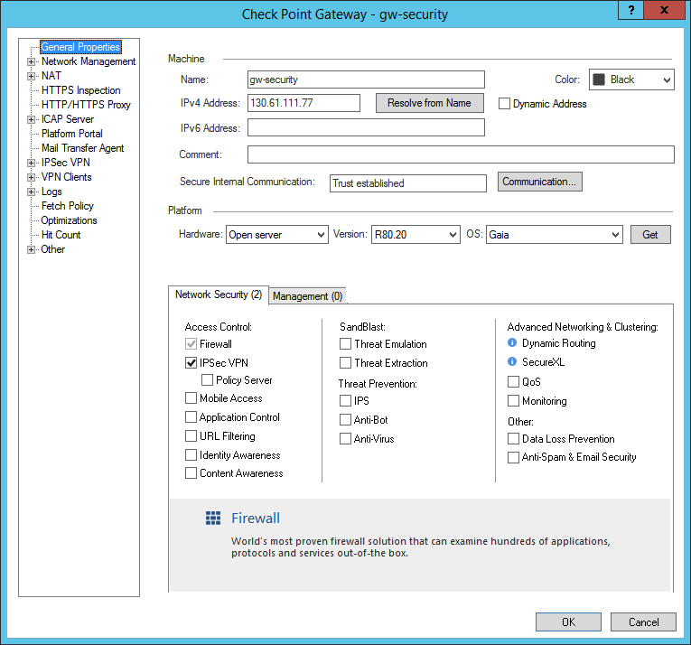

  1. Install the IPSec VPN module. We recommend that you also install the Monitoring module for traffic analysis.
    This image shows where to enable the IPSec VPN module.
  2. Select OK to save the changes.

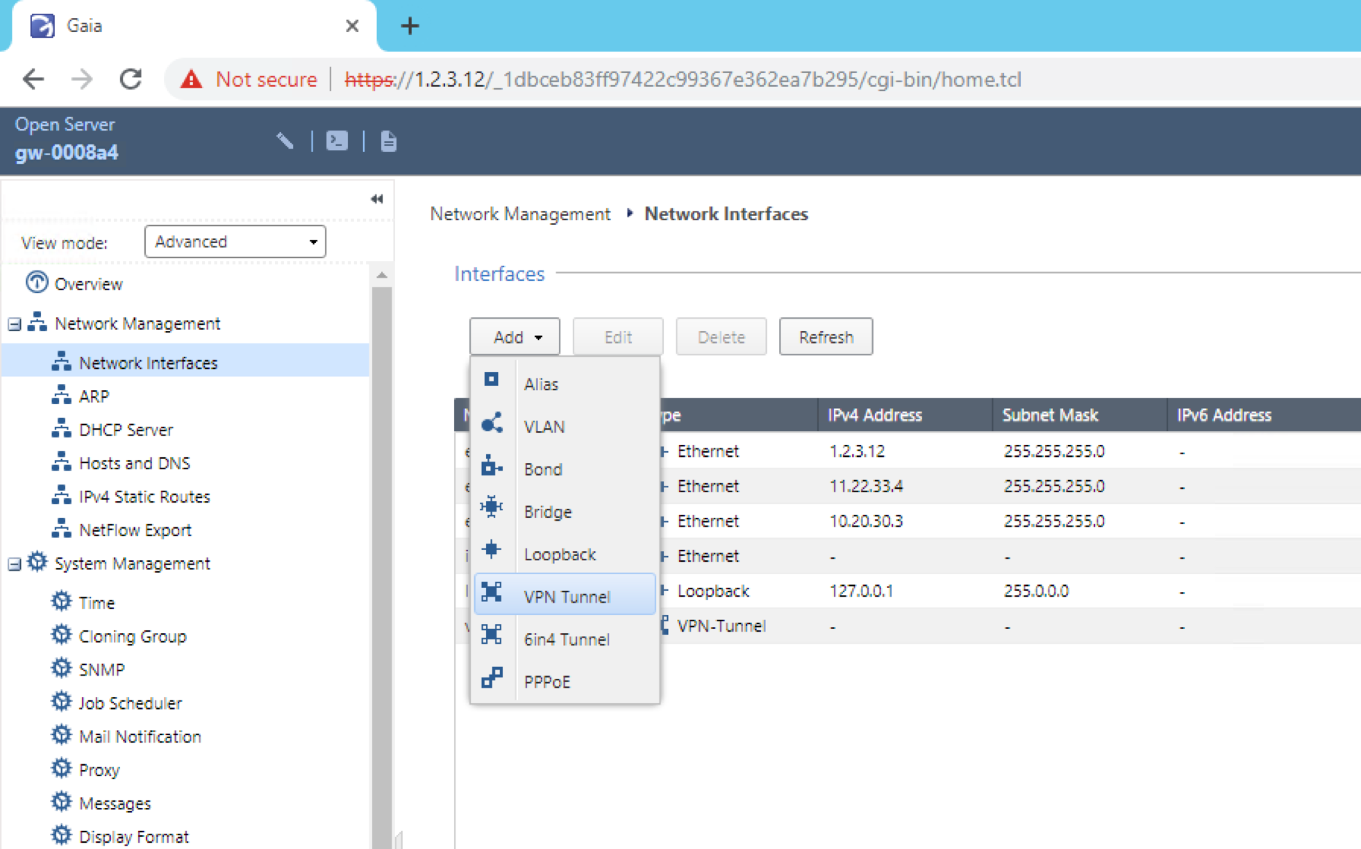

Task 2: Create the VTI interface from GAIA
In this task, you configure a VTI interface that passes traffic by using routing rules from the VTI interface to the newly created IPSec tunnel.
  1. Sign in to the GAIA portal using the Check Point CloudGuard Security Gateway public or private IP address.
  2. On the GAIA portal, select the Advanced view.
  3. Under Network Management, go to Network Interfaces.
  4. Select Add, and then select VPN Tunnel.
    This image shows where to add a VPN tunnel in the GAIA portal.

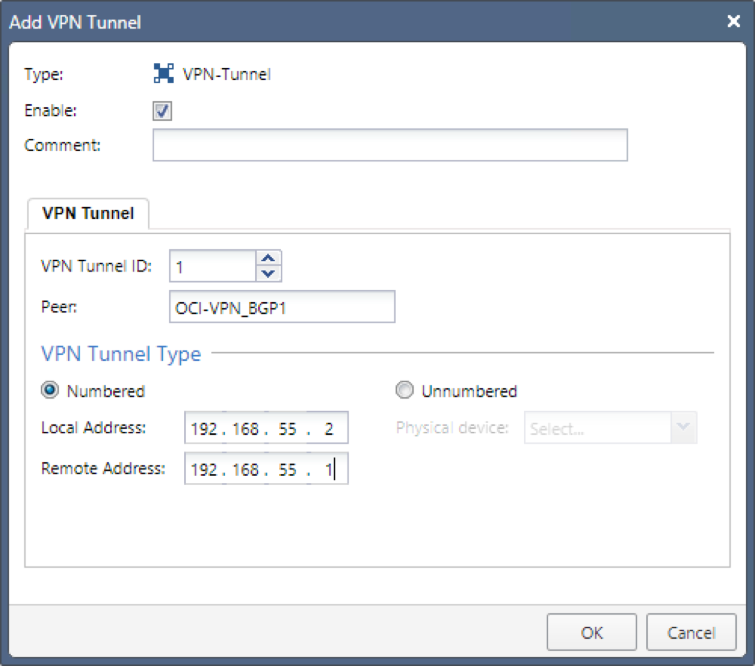

  5. Specify the following items:
    • VPN Tunnel ID: A number that gets added to the VTI interface called vpnt*, where the asterisk is the VPN tunnel ID number specified . For VPN tunnel ID = 1, the interface is labeled vpnt1.
    • Peer: The name of the interoperable device that you created earlier for the IPSec tunnel. In this case, the name is OCI-VPN_BGP1.
      Important
      If the name you specify here doesn't match the name of the interoperable device, traffic doesn't flow through the IPSec tunnel.
    • Numbered: Select Numbered to create a numbered interface.
    • Local Address: The local IP address that was specified in the Oracle Console as the Inside Tunnel Interface - CPE.
    • Remote Address: The remote IP address that was specified in the Oracle Console as the Inside Tunnel Interface - Oracle.
    This image shows the VPN tunnel parameters to configure in the GAIA portal.
  6. Select OK.

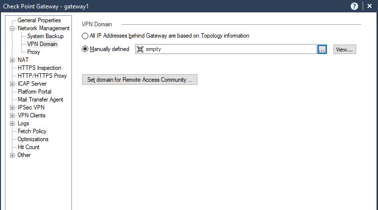

  10. To force a route-based VPN to take priority, create an empty group and assign it to the VPN domain:
    1. On the VPN Domain page, select Manually defined, and then select Create empty group.
    2. Select New, select Group, and then select Simple Group.
    3. Enter an Object Name, and then select OK. Don't assign any objects to this empty group.
      This image shows the empty group for the VPN domain.

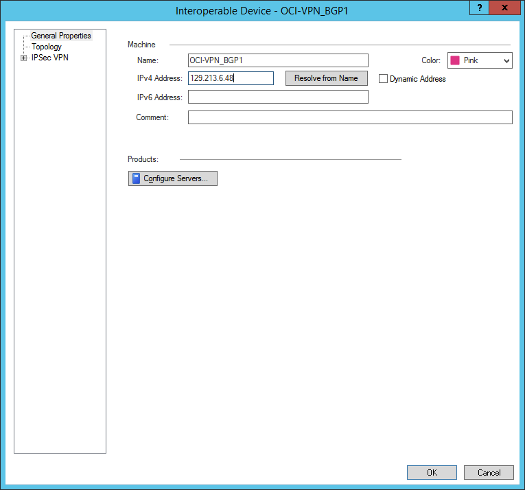

Task 3: Create an interoperable device

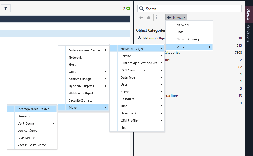

Later, you create a VPN Community. Before you can, you must create an Interoperable Device that gets used in Check Point CloudGuard Security Gateway to define the Oracle DRG.
  1. Create the new interoperable device.
    This image shows where to create a new interoperable device.
  2. On the General Properties page of the new interoperable device, add a name to identify the IPSec tunnel. Enter the IP address that Oracle assigned for the Oracle end of the tunnel when creating the IPSec connection.
    This image shows where to configure the interoperable device.

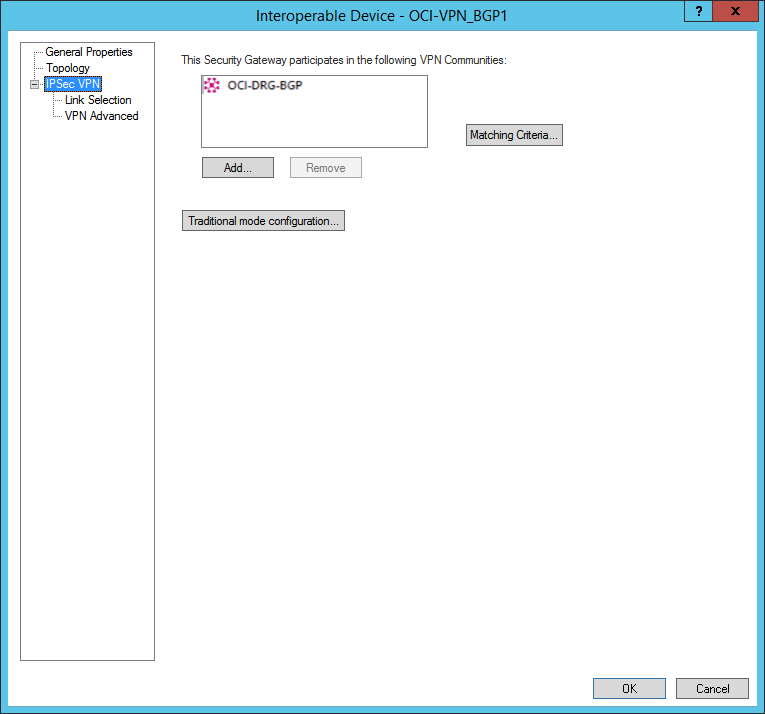

  4. On the IPSec VPN page, you can optionally add the new interoperable device to an existing VPN Community. You can skip this step if you don't yet have any VPN Communities created.
    Notice that you skip the Traditional mode configuration, because you define all the Phase 1 and Phase 2 parameters in the VPN Community in a later step. The VPN Community applies those parameters to all interoperable devices that belong to the VPN Community.
    This image shows where to add the interoperable device to a VPN community.

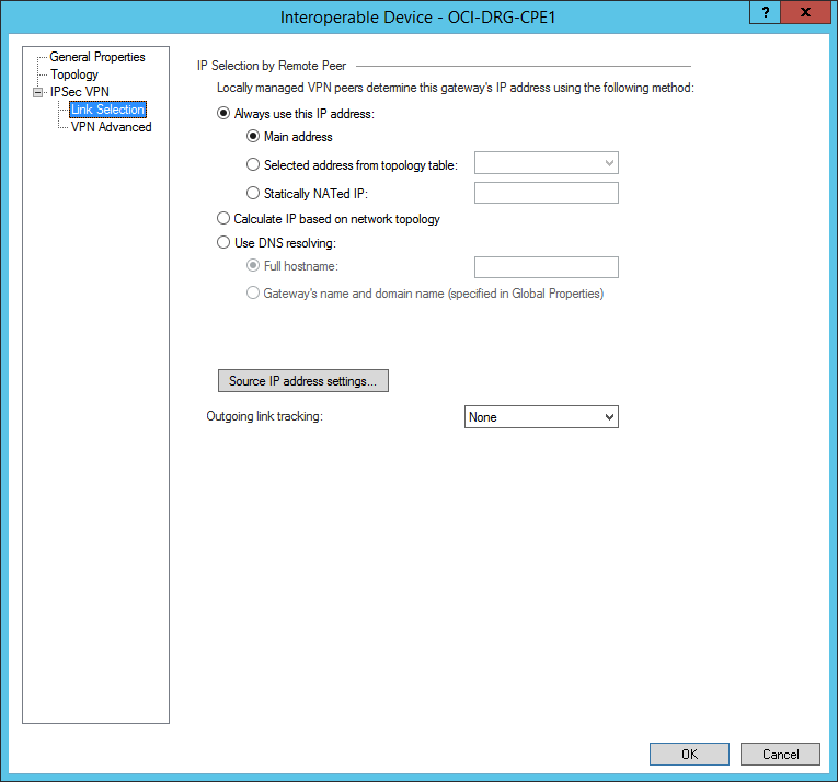

  5. On the Link Selection page, under Always use this IP address, select Main address, which was the address you specified when creating the interoperable device. You can use a specific IP address as the IKE ID.
    This image shows where to specify the address to use for the interoperable device.

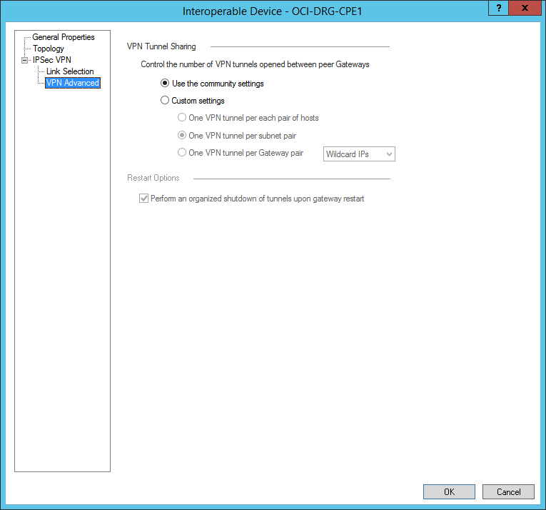

  6. On the VPN Advanced page, select Use the community settings, which applies all the options and values in the VPN Community, including the Phase 1 and Phase 2 parameters.
    This image shows where to specify advanced VPN settings.

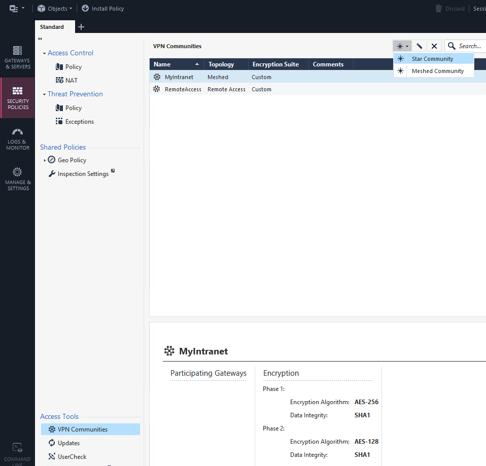

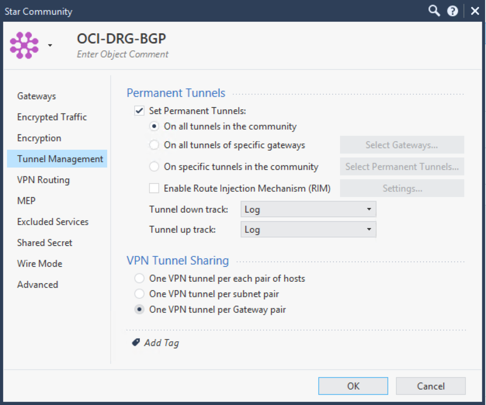

Task 4: Create a VPN community

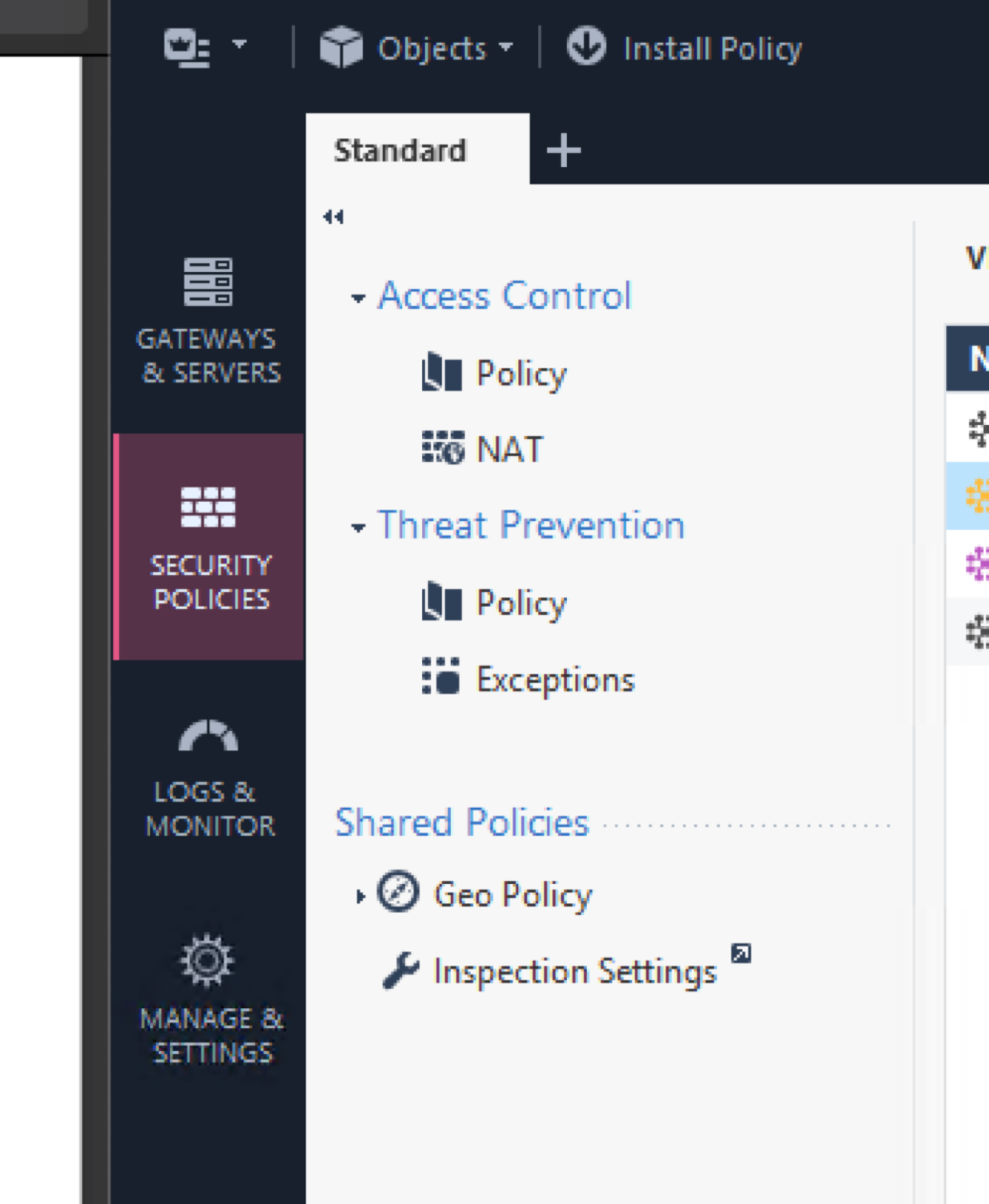

  1. Go to Security Policies, and then from Access Tools, select VPN Communities.
  2. Create a Star Community.
    This image shows where to create a VPN community.

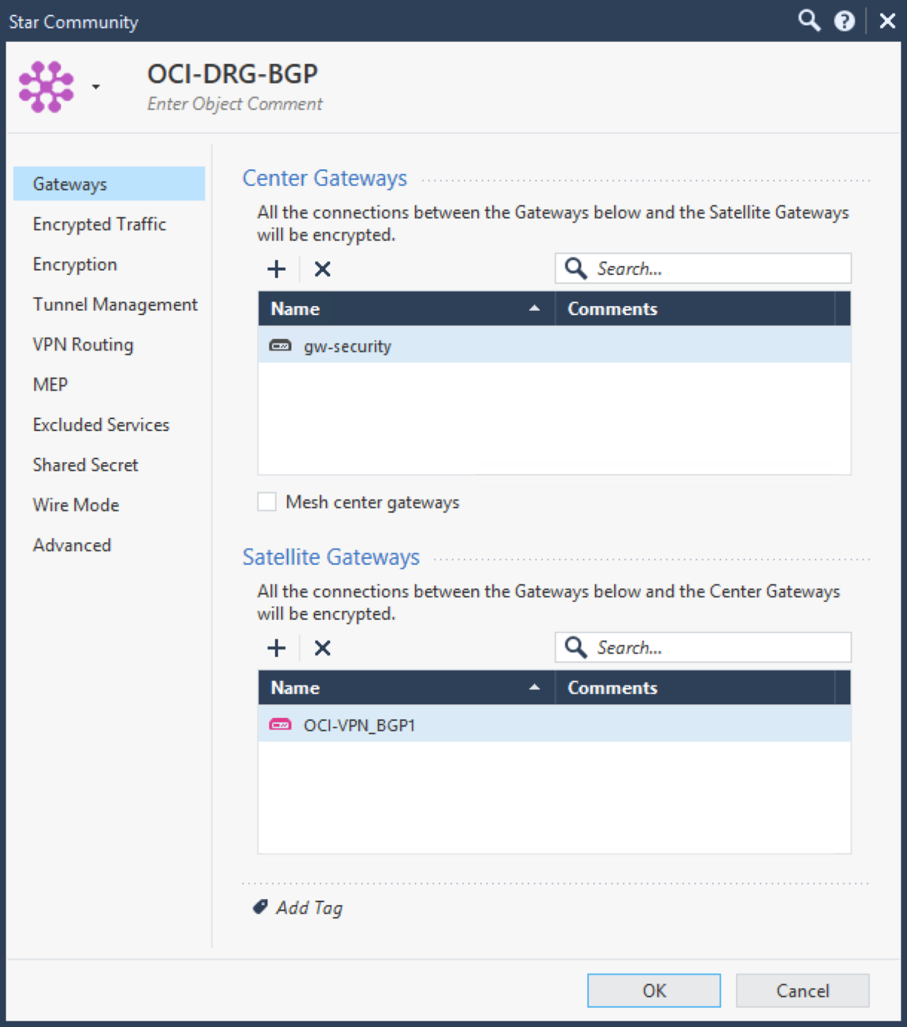

  3. For the star community, add a name.
  4. On the Gateways page, select the values for Center Gateways and Satellite Gateways. This star community acts as a settings template for the interoperable devices you specify in Center Gateways and Satellite Gateways.
    • Center Gateways: For the Check Point CloudGuard Security Gateway.
    • Satellite Gateways: For the CPE that connects to the Oracle DRG for each IPSec tunnel.
    This image shows where to configure the gateways for the VPN community.

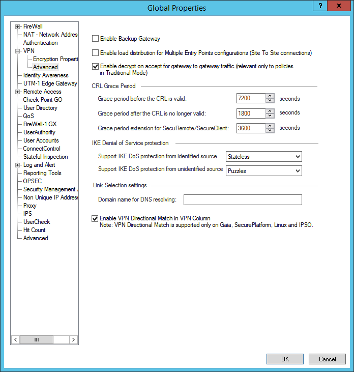

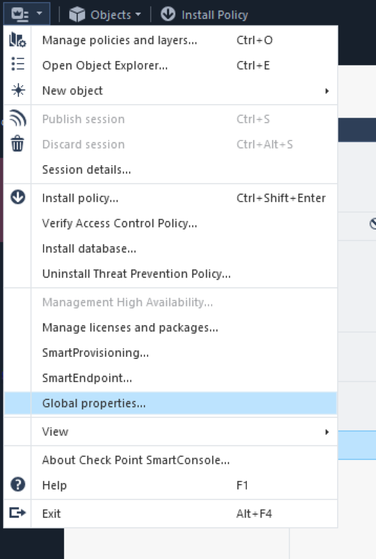

  5. To allow traffic, go to Global Properties, and then VPN, and then Advanced.
    This image shows where to find the global properties.
    This image shows where to find the VPN advanced properties to allow traffic.

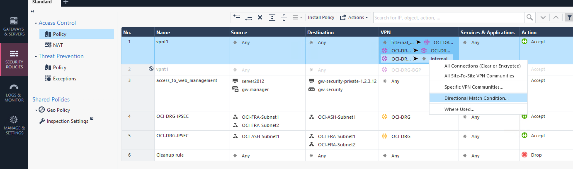

  6. Select Enable VPN Directional Match in VPN Column. Later you create a security policy that uses a directional match condition to allow traffic to pass based on routing rules.
  7. Select OK.

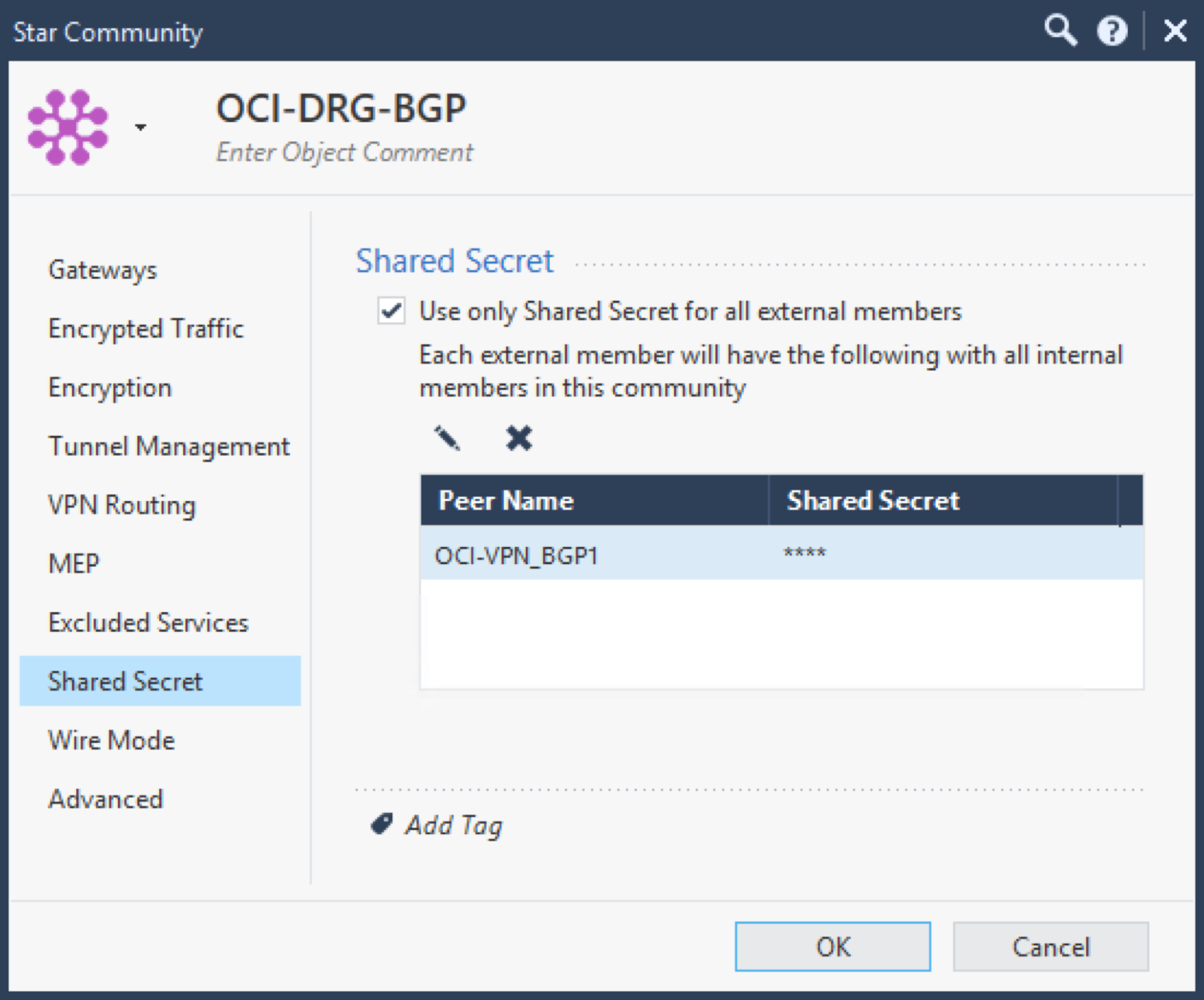

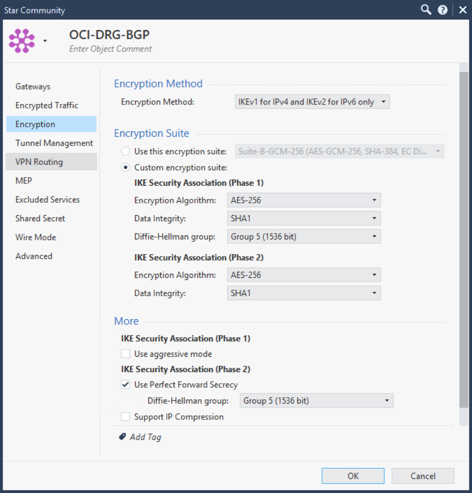

  8. On the Encryption page, configure the Phase 1 and Phase 2 parameters that Oracle supports. For a list of those values, see Supported IPSec Parameters.
    If you're configuring Site-to-Site VPN for the Government Cloud, see Required Site-to-Site VPN Parameters for Government Cloud.
    Notice that to use IKEv2, for the Encryption Method, instead select IKEv2 only.
    This image shows where you can configure the Phase 1 and Phase 2 parameters.
  9. On the Tunnel Management page, select Set Permanent Tunnels. We recommend that you:
    • Select On all tunnels in the community to keep all the Oracle IPSec tunnels up all the time.
    • In the VPN Tunnel Sharing section, select One VPN tunnel per Gateway pair.
    The latter option generates only one pair of IPSec security associations (SAs), and each SA with only one security parameter index (SPI) (unidirectional).
    When you use policy-based tunnels, every policy entry generates a pair of IPSec SAs, (also referred to as an encryption domain).
    Important
    The Oracle VPN headend can support multiple encryption domains, within limitations. See Encryption domains for policy-based tunnels for full details.
    Oracle creates a route-based IPSec connection, which means that everything is routed through an encryption domain that has 0.0.0.0/0 (any) for local traffic and 0.0.0.0/0 (any) for remote traffic. For more information, see Supported Encryption Domain or Proxy ID.
    This image shows where you can configure tunnel management options.
  10. On the Shared Secret page, select Use only Shared Secret for all external members, and add the shared secret that Oracle generated for the tunnel when creating the IPSec connection.
    Oracle supports only shared secret keys. Note that you can change the shared secret in the Oracle Console.
    This image shows where you can specify the shared secret for the tunnel.
  11. Select OK to save the changes.
Task 5: Create a security policy
  1. Go to Access Control, and then the Policy tab. Create specific security policies by using Directional Match Condition, which allows traffic to pass based on route tables. Set up the condition with these settings:
    • Internal_Clear > VPN Community created
    • VPN Community created > VPN Community created
    • VPN Community created > Internal_Clear
    In this case, the VPN Community is OCI-DRG-BGP and the Internal_Clear is predefined by Check Point.
    This image shows how to configure the security policy directional match condition.
  3. Select Install Policy to apply the configuration.
    This image shows where to select Install Policy.

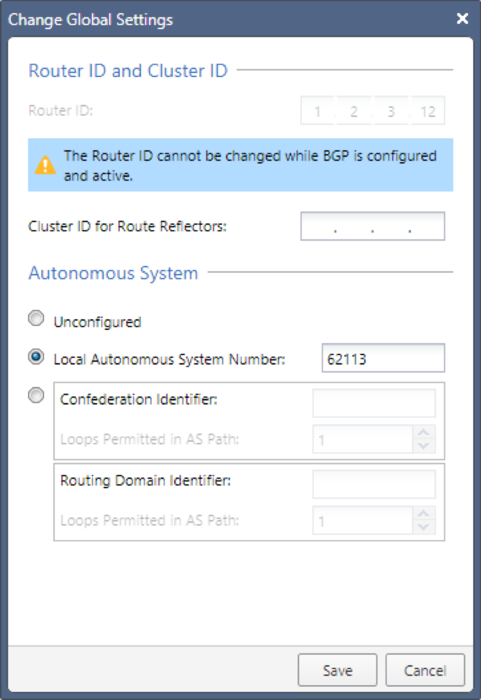

Task 6: Enable BGP
Perform the following steps for each tunnel.
  1. Go to Advanced Routing, and then BGP.
  2. Under BGP Global Settings, select Change Global Settings, and then add a router ID and local ASN.
    This image shows where to change the BGP global settings.
  3. Select Save.

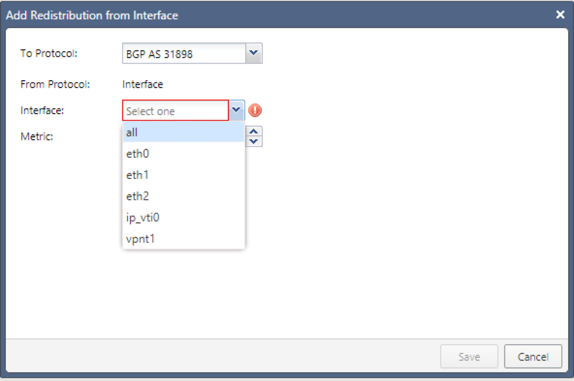

Task 7: Redistribute routes into BGP
  1. Go to Advanced Routing, and then Route Distribution.
  2. Select Add Redistribution From, and then select Interface, which is for adding all connected subnets.
    This image shows where to configure route distribution.
  3. In the Add Redistribution from Interface dialog, configure the following items:
    • To Protocol: Select BGP AS 31898. Oracle's BGP ASN for the commercial cloud is 31898, except the Serbia Central (Jovanovac) region which is 14544. If you're configuring Site-to-Site VPN for the Government Cloud, see Oracle's BGP ASN.
    • Interface: Select all to advertise all connected subnets.
    This image shows the Add Redistribution from Interface dialog.
  4. Select Save.
Now the BGP session should be up and advertising and receiving subnets.
