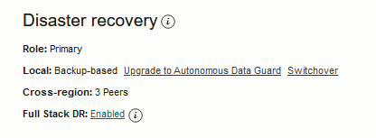

Autonomous AI Database Disaster Recovery Status
Autonomous AI Database provides information about disaster recovery status on the Autonomous AI Database Details page.
In the Disaster recovery area:
The Role field shows the role of the current database, as follows:
  • When you have either a local backup copy peer or a local Autonomous Data Guard standby, the Oracle Cloud Infrastructure Console shows the Role field value Primary. Autonomous AI Database does not provide access to a local standby database (or to a local backup copy peer).
  • When using either a cross region backup copy peer or a cross region Autonomous Data Guard standby, the Oracle Cloud Infrastructure Console shows the Role field value Primary if you are viewing the primary database and shows Standby if you are viewing the details for a standby database.
  • Switchover: Provides a link so that you can perform a switchover operation.
  • Failover: When the primary database is not available and you have a local standby and automatic failover was not successful, the failover link allows you initiate a manual failover.
    When the primary database is not available and you have a cross region standby and failover to a local standby is not possible, the failover link allows you initiate a manual failover to the remote standby database.
To view the peer Autonomous AI Database information, on the Autonomous AI Database details page select the Disaster recovery tab. This shows the peer Autonomous AI Database information. The State column shows the state of a standby database, as follows:
