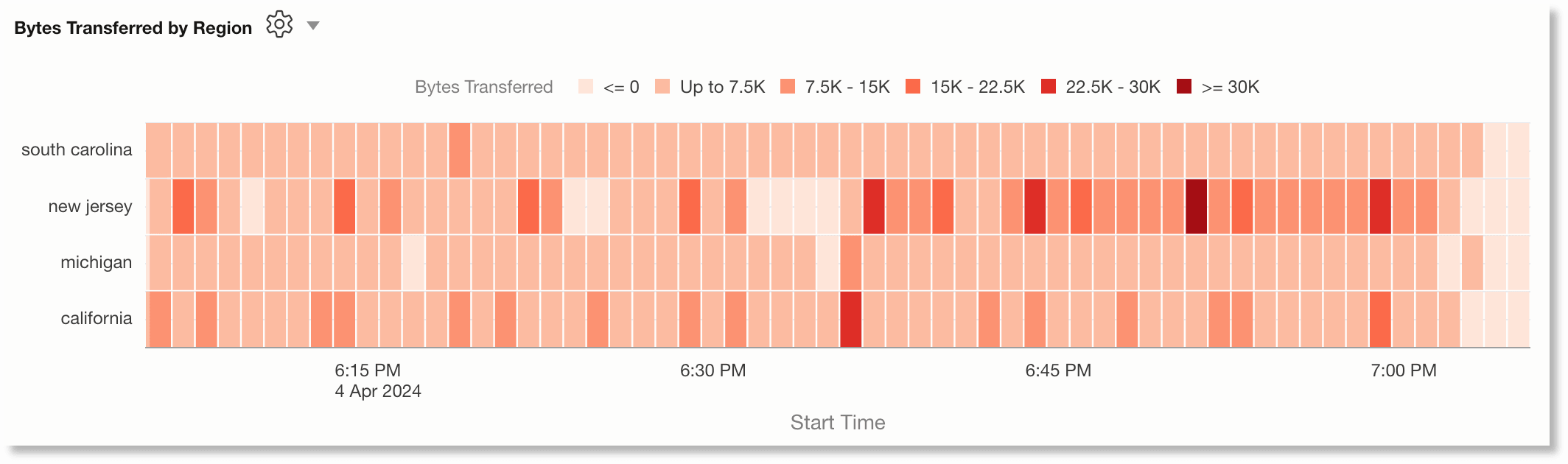

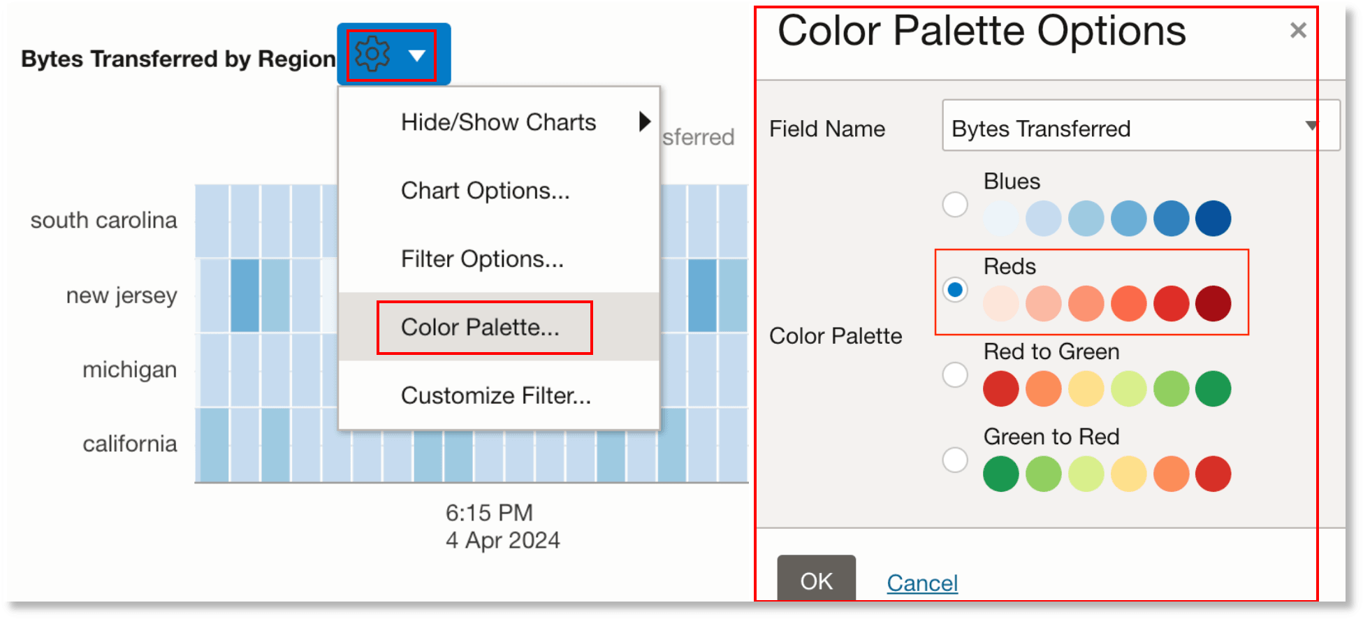

Change the Colors in the Time Series Chart
To change the Heat Map color scheme, from the  Settings menu next to the title of your time series chart, and click Color
                Palette. Alternatively, click Color link adjacent to the chart and the
            field name. Select the colors in the color palette.
The Heat Map chart changes colors to the palette selected:
In the above diagram, you can notice that the higher values are easy to identify with the higher intensity of colors.

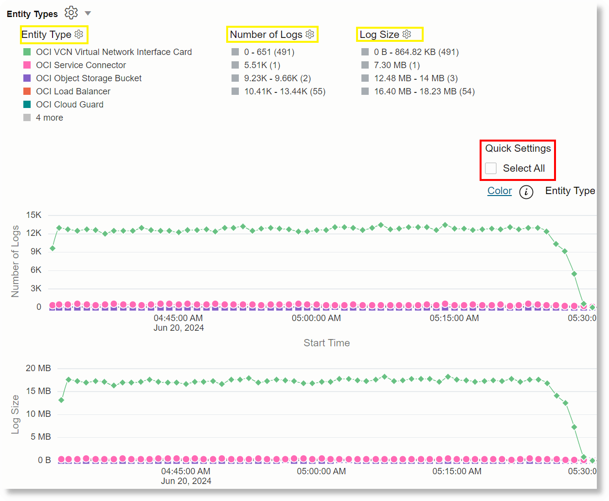

Enable Filters
Filter Options dialog box displays the list of fields used in the timestats chart. Enable the check box Show Search Filters. You can select one or more fields to display in the Filter panel. For example, consider the following search:
| eval 'Raw Size (bytes)' = unit('Raw Size', byte)
| link Time, 'Entity Type'
| timestats name = 'Entity Types'
            sum(Count) as 'Number of Logs',
            sum('Raw Size (bytes)') as 'Log Size'
        by 'Entity Type'The Filter Options dialog box would now show the following fields generated by the
                    timestats command and the fields used in the by clause:
                    Entity Type, Number of Logs, Log Size.
In the fields panel, you can select one or more filters to view only those specific data points. You can reset the filter by toggling the Select All option.
After the filter is enabled for a specific field, to view the complete list of values
                for a string field, click the  Settings icon next to the field name.

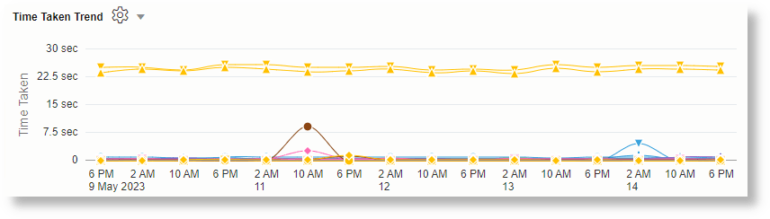

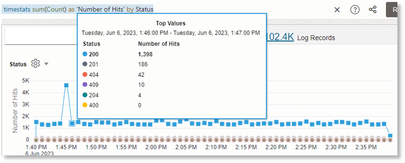

In the following example with OCI Integration Activity Stream Logs, the Time Taken Trend is plotted on the basis of the fields Action and Integration:
Duration != null and 'Log Source' = 'OCI Integration Activity Stream Logs'
| eval 'Duration (ms)' = unit(Duration, ms)
| link Identifier, Instance, Action
| stats unique(Integration) as Integration

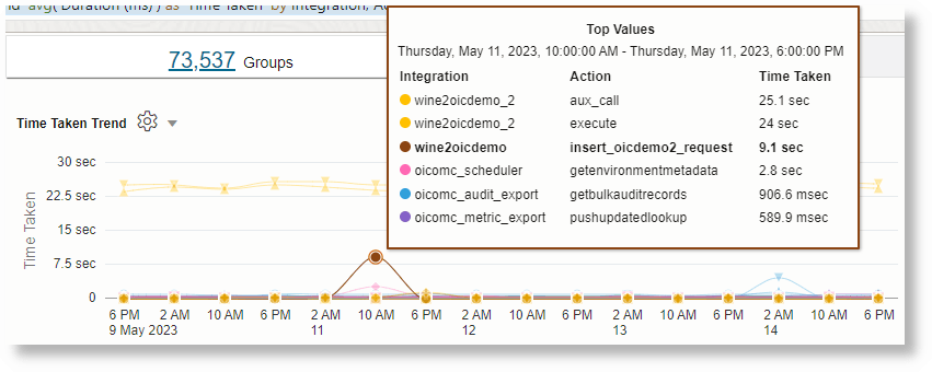

| timestats name = 'Time Taken Trend' avg('Duration (ms)') as 'Time Taken' by Integration, Action
You can hover on any data point to get the top values for that time period.

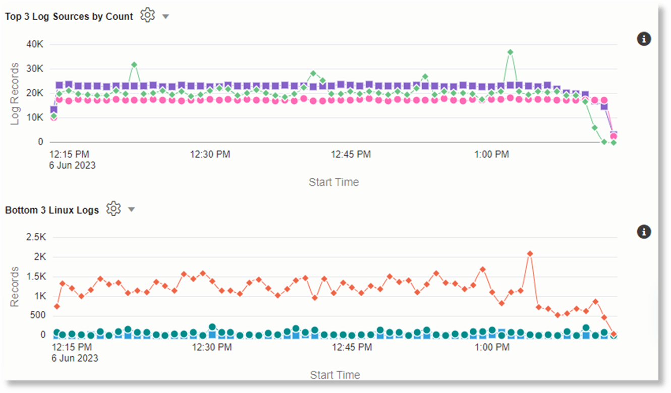

   ]Specifying the number of charts to be returned: Use the
                    topcount or bottomcount parameters to specify
                the number of charts to be returned back to the UI.
- topcount: When grouping by fields, return N count of distinct groups with the largest aggregated values.
- bottomcount: When grouping by fields, return N count of distinct groups with the smallest aggregated values.
For example:
| link Time, 'Log Source'
| timestats topcount = 3 name = 'Top 3 Log Sources by Count'
            sum(Count) as 'Log Records'
        by 'Log Source'
| addfields
     [ * | where 'Log Source' in ('Linux Audit Logs', 'Linux Secure Logs', 'Linux Syslog Logs', 'Linux Cron Logs')
         | timestats bottomcount = 3 name = 'Bottom 3 Linux Logs'
                     sum(Count) as Records
                   by 'Log Source' ]The following charts are generated as the result of running the above query:

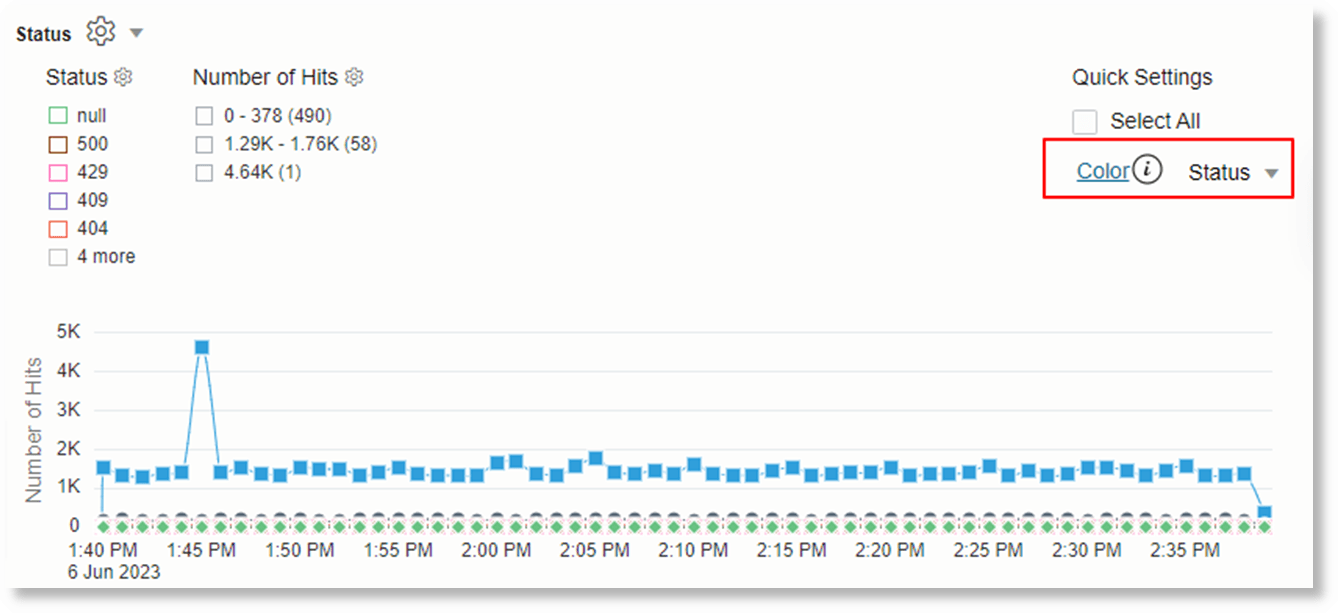

Legend Control: You can turn on or turn off the legends using the Show Legend option in Chart Options.
Chart Filters: You can use the filters to interactively analyze the time series. Enable the filters by clicking Chart Options, Filters, and Show Search Filters. The filter options show the list of fields used in the timestats chart. You can select one or more fields to be displayed in the Filter panel. After you select the Filter options, the fields generated by the timestats command as well as the fields used in the by clause are displayed above the chart. Select one or more filters to view only those specific data points. You can reset the filter selection by toggling the Select All option.
Search and Customize Filters: Click Options icon  next to a filter name to view the complete list of values for that
                        filter. You can enter the text for search. You can also provide regular
                        expressions for searching. For example, searching for next to a filter name to view the complete list of values for that
                        expressions for searching. For example, searching fore$will show all the results that end in the lettere.Check the Invert option to display only those values that do not match the criteria.

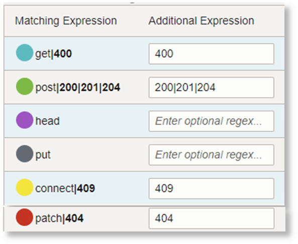

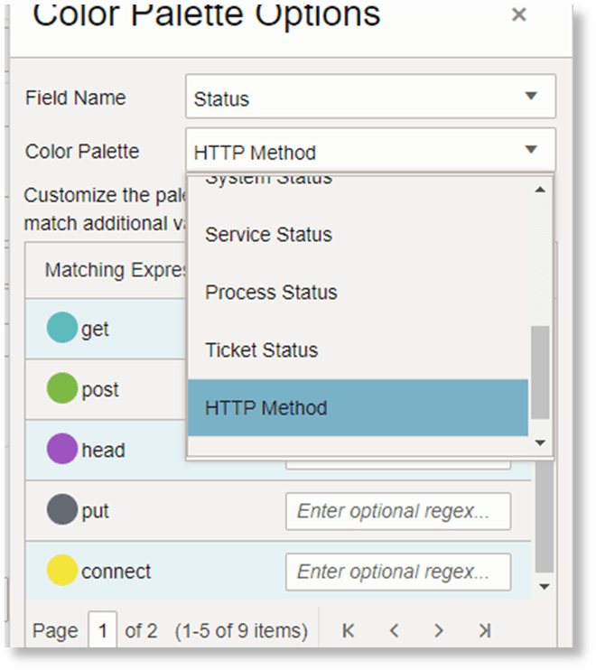

Select Colors: You can configure the color for each time series. Consider the following query that shows the trend of each Statusin the OCI Audit Logs:Status != null and 'Log Source' = 'OCI Audit Logs' | link Time, Status | timestats sum(Count) as 'Number of Hits' by StatusThe chart displays the Status values and their default color. The values of the Status field are 200,201,404,409,204, and400.
 Enable the filters using Chart Options to view the color option next to the chart.
 Click the Color link, select Statusfield, and select a palette that has as many colors as the values to configure.
 Update each color expression with the value or a regular expression you that want to match.
 You can repeat this process for each field in the Color drop down to configure the colors.

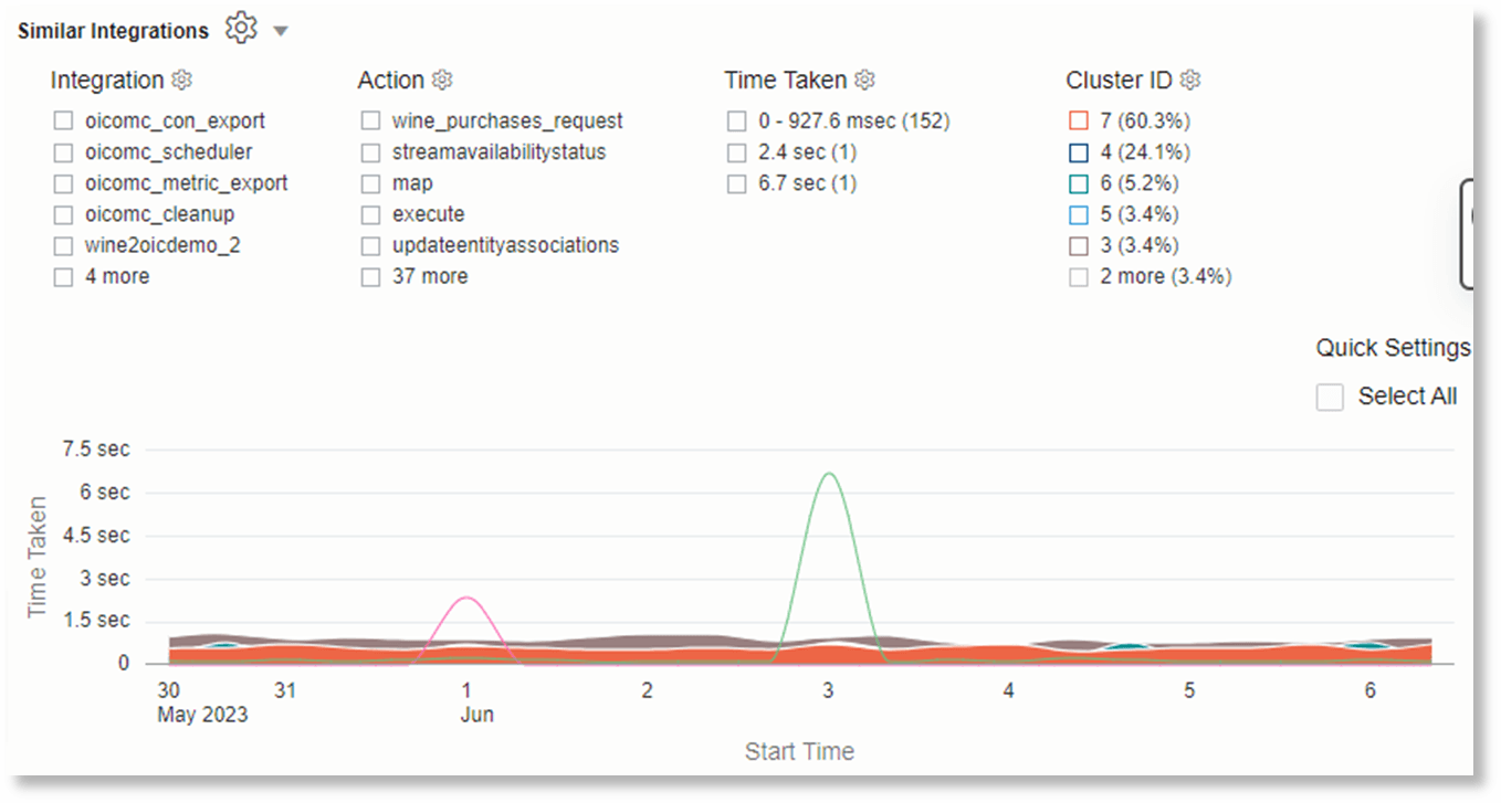

Use timecluster Command to
        Plot a Time Series
You can group similar time series values using the
            timecluster command after the link command. Clustering
        is useful when there are large number of time series to analyze, or you want to identify
        different behaviors in your time series values.
Topics:
In the following example, timecluster is used after link to get representative
            samples of OCI Integration Activity Stream Logs. You can hover the mouse on any
            data point to get additional details about the cluster:
| timecluster name = 'Similar Integrations' avg('Duration (ms)') as 'Time Taken' by Integration, Action
Viewing Individual Clusters using Filters: Click Chart Options and click Filters to enable and view the filters. Select each cluster ID to view the details for that cluster.
Understanding How Link timecluster Works

Each cluster gets the following properties that are displayed in the console:
| Property | Description |
| Cluster ID | A unique ID for the cluster |
| Cluster Members | Number of time series in this cluster |
| Minimum Value | Lowest value for this cluster for the selected interval |
| Maximum Value | Highest value for this cluster for the selected interval |
| Value | Value of the specified statsfunction for this cluster, for the selected interval |
| Percentage | Percentage of groups represented by the number members in this cluster |
| Cluster Samples | Few samples of the cluster. Note: There can be more values than what is displayed in the sample, since these are only samples that show similar behavior. |
