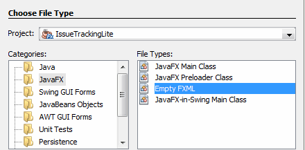

In the New File dialog box, select the JavaFX category and select the Empty FXML file type, as shown in Figure 3-1. Click Next.

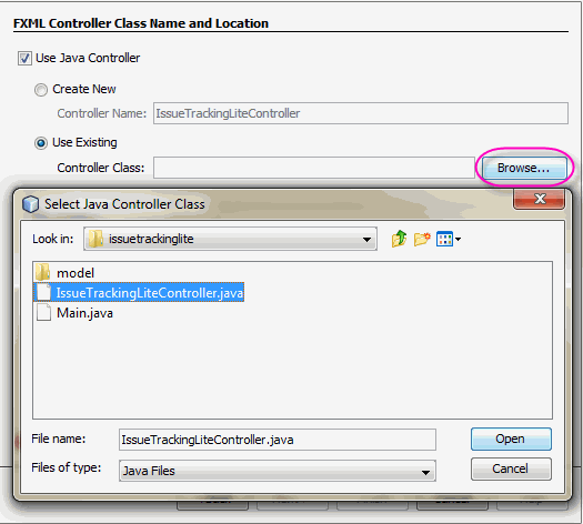

In the FXML Controller Class step, select the Use Java Controller checkbox and the Use Existing option.
Click Browse and in the Select Java Controller Class dialog box, open the IssueTrackingLiteController.java file, as shown in Figure 3-2. Click Next.
Figure 3-2 Use the Existing Java Controller Class File

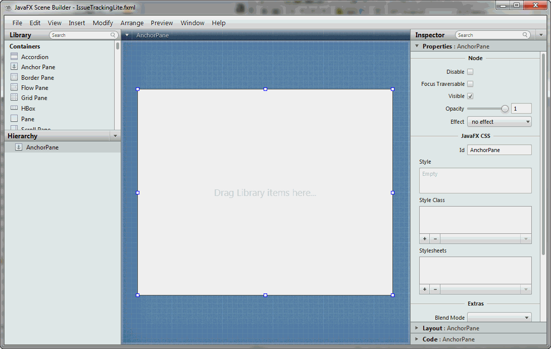

In the Projects window, double-click the IssueTrackingLite.fxml node to open the file in the JavaFX Scene Builder tool.
The main window for the JavaFX Scene Builder tool appears with an empty FXML file opened in the Content panel, as shown in Figure 3-3. The initial AnchorPane element shown in the Content panel will contain the GUI layout that you build. Click the image to see a larger version.
Figure 3-3 JavaFX Scene Builder Main Window at Startup (Click image to enlarge.)
Description of "Figure 3-3 JavaFX Scene Builder Main Window at StartUp"
Tip: Enlarge the Content panel to get a larger working area. Select the row for the AnchorPane element in the Hierarchy panel. Click the Layout section of the Inspector panel and enter |

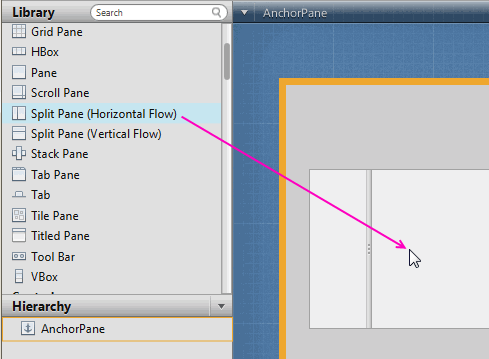

From the Library panel, select Split Pane (Horizontal Flow). Drag it to the Content panel and drop it inside the Anchor Pane element, as shown in Figure 3-5.
After you drop the Split Pane object, the Hierarchy panel is updated to show the Split Pane (Horizontal Flow) element containing the two AnchorPane sub-elements.
Figure 3-5 Add Split Pane (Horizontal Flow)
Description of "Figure 3-5 Add Split Pane (Horizontal Flow)"
With the Split Pane (Horizontal Flow) selected in the Hierarchy panel, select Modify and then Fit to Parent from the Menu bar. This action resizes the node to fill the space occupied by its container parent, the topmost AnchorPane element.

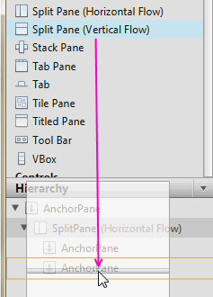

To add the Split Pane (Vertical Flow) sections, drag Split Pane (Vertical Flow) from the Library panel and drop it to the Hierarchy panel. Ensure that you make the drop when the second AnchorPane element inside the Split Pane (Horizontal Flow) shows an orange highlight, as shown in Figure 3-7.
Figure 3-7 Add Split Pane (Vertical Flow)
Description of "Figure 3-7 Add Split Pane (Vertical Flow) "
Notice that after the Split Pane (Vertical Flow) element is dropped, it is added to the Hierarchy panel with its AnchorPane children.
In the Hierarchy panel, right-click the newly added row for the Split Pane (Vertical Flow) element and choose Fit to Parent from the contextual menu.
With the Split Pane: (Vertical Flow) selected in the Content panel, drag the horizontal divider until the percentage displays about 35%. Alternatively, click the Properties section of the Inspector panel, enter
